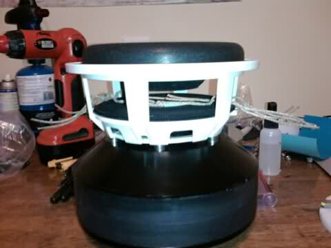

i like that dustcap. but i really did it to add a some mass to lower ur fs //content.invisioncic.com/y282845/emoticons/smile.gif.1ebc41e1811405b213edfc4622c41e27.gif
8layer flat ccaw 3" ww
3 9.750" med spiders
dual flat leads

i dont think there has ever been a 8" built with this amount of motor force should deff be interesting //content.invisioncic.com/y282845/emoticons/wink.gif.608e3ea05f1a9f98611af0861652f8fb.gif
You have some pretty impressive work SPL. Do you have a machine to take t/s parameters? Also, that 8" is nuts. You know it's boss when you HAVE to invert it. I just wonder if it's able to actually use everything there.
i can get ts but normally build off experience cause i dont break in woofers b4 i ship just a power test. i know what parts do what except for totally off customs like this.
actually dosent have to be inverted, split baffle. i have been thinking about machining a 2 piece ring so it can be used or not.
will see what it can do when finished. will have it mostly done tonight //content.invisioncic.com/y282845/emoticons/smile.gif.1ebc41e1811405b213edfc4622c41e27.gif
