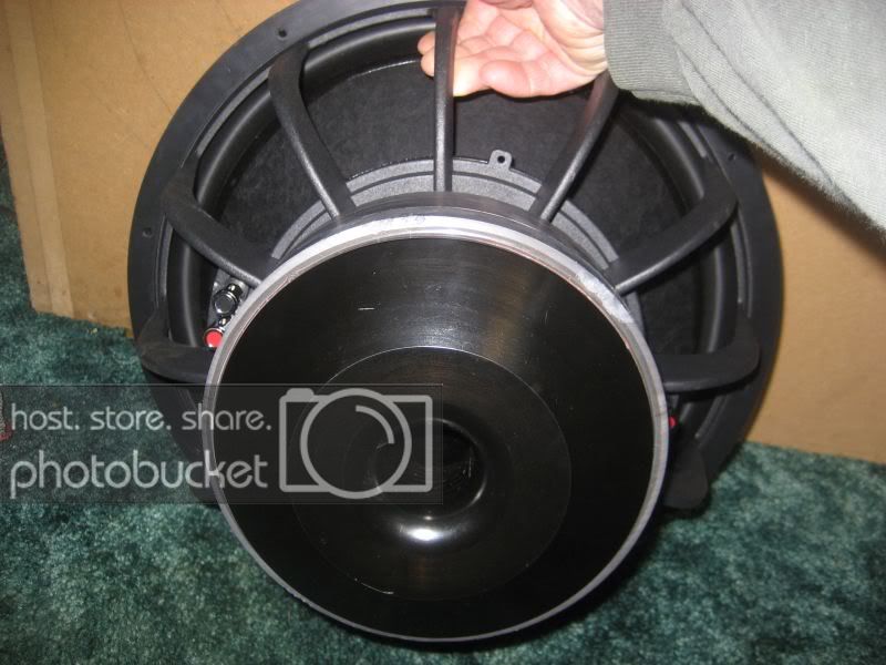

It isnt a spl sub. I just thought it was strange that I have those, as you were discussing about the same thing. I will need to look up the specs. Not at my computer at the moment.
around 25-28mm xmax one way.
fs is in to low 20s I think.
800 watts rms. (3" coils)
D4 vc.
high q. like .6X
3x slugs
12 spoke cast frame,
pressed cone with inverted dust cap.
high roll rubber surround.
It sounds nice. I think it was a prototype for a highend sealed home sub. I bought it from a guy that designs $16k a pair speakers.

The price was as smexy as the sub! LOL. I don't have pics online, just checked. and I was off on some of the specs.
Fs=32hz
qts=.642
spl @2.83 volts=96 db
this thing will stay under xmax in a IB with its rated power down to ~20hz //content.invisioncic.com/y282845/emoticons/wink.gif.608e3ea05f1a9f98611af0861652f8fb.gif
I love the Aura amp. (I just bought another one) old school, triple darlington design. (what ever that means) same designer as the old Lanzar opti-drive? This is what I heard.

haha u made it your avatar, nice. i've always wanted to do an IB setup....but its a tC //content.invisioncic.com/y282845/emoticons/crap.gif.7f4dd41e3e9b23fbd170a1ee6f65cecc.gif
I'm gonna have to see if someone can build me one of those. Thats just super smexy.
