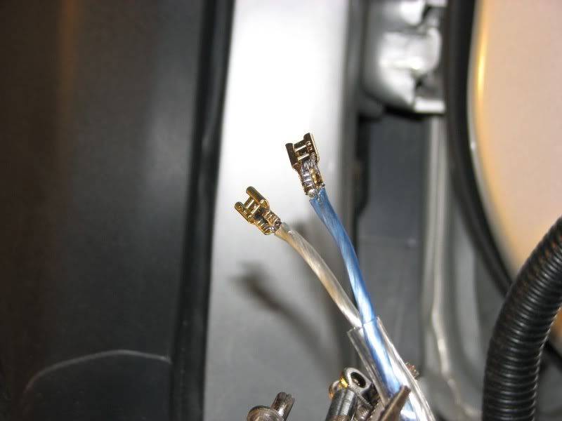

how i terminate 12AWG at speakers:
crimp and solder uninsulated female disconnects
insulate with heatshrink
We up-size wire to reduce voltage drop on long runs. but large wires can work their way loose on the spade terminals on speakers. the tinsel leads are an indication of the minimum wire size you can use for short distances.

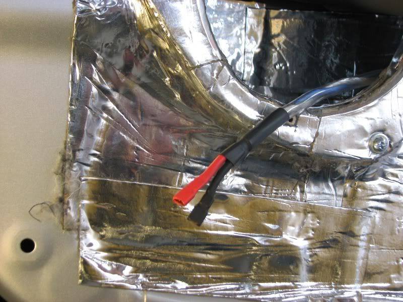

more recently, i soldered 18awg wiring to the speaker terminal to make flexible pigtails that i connected to the 12awg ran into the doors. this reduced strain on the speaker terminals.
the 12awg has similar soldered female disconnects and heat shrink as above. the 16awg has insulated male spade disconnects.
the spade connections are then protected with a few wraps of 3M Super 33+ before installing in the door.
