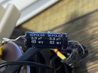

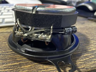

So from what I can tell, the driver and the tweeter are connected together. The cap is inline with the tweeter.
The cap has a marking on it 3.3 uF. 63WV
When I put my meter on across the cap I get 8 ohms
When I test across the tweeter connectors I get I get 6.2 ohms
When I test across the driver / cone I get 2 ohms
When I test across the pins for the speaker wires I get 2 ohms

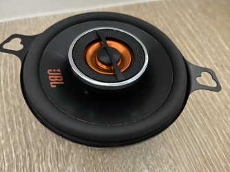

Now I just bought the JBL GX328. This is the spec from their website:
Power Handling: 25Wrms, 75W Peak Frequency Response: 90Hz – 21kHz Impedance: 2.3 ohms Sensitivity (@ 2.83V/m): 89dB
When I test across the pins for the speaker wires I get 2.4 ohms.

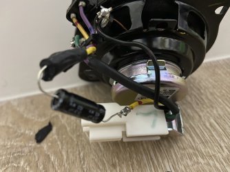

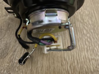

There is a cap on the JBL GX328 with the marking of 3.9 uF. 5 0 V.
One side of the cap is connected to the smaller of the two pins and the other is running under the sticker on the magnet and goes inside somewhere - can't see it.
So I connected up the GX328's and I did notice that the volume is slightly lower on the GX328 than the original speakers.
The other thing that was a big difference is that the GX328's have more bass and what seems to me like less mid.
The high pitch sounds (like cymbals of a drum) are much clearer and more prevalent.
The original speakers seem to have much more mid than the GX328 - could this be because of the capacitors.
Would removing the capacitor from the GX328 cause any damage to the speaker - or swapping them with the original speakers capacitors make any difference.
I would prefer to get more mids out of the new GX328 - I don't care if there is more base from them as it seems sound better in the car - just not crazy about the low mids.

Any idea what the cap on the GX328's is for?

The capacitor on either is the bass blocker for the tweeter. Shouldn't be affecting anything else.
Don't swap or add capacitors. The cap is spec'd for the tweeter. Without it, the tweeter simply blows.
Get some door speakers to match, and enjoy your nightmare.
BTW, will take 20hrs for the speakers to loosen up and break in.
When blindly swapping speakers, the end result is what you live with, unless you install a dsp/eq.
