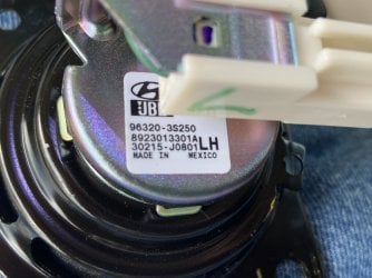

The speaker that came out of the car has the following label on it
JBL 96320-3S250
8923013301A
30215-J0801

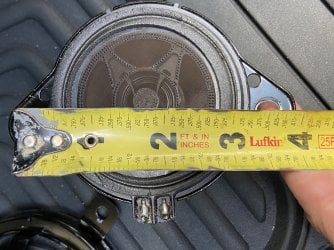

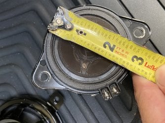

If you have that many speakers up front, I doubt they are two way. Three in the dash plus door speakers would be a lot of high freq. If the dash are all tweeter size, I would bet just tweeter. The 3.5" in the door could be two way, but I'lll bet they are mids, (based on having 3 in the dash).
You can tell by looking at em. Two way have two drivers. If they just have a cone with nothing on top, it's not a two or three way.
The door speakers are 6.5”

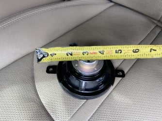

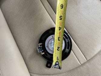

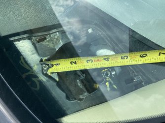

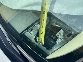

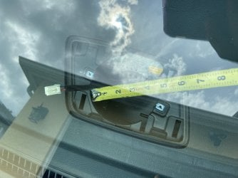

The two side dash are 2.75” but the hole is bigger so can get a 3.5” in there
I am not sure what the center dash size is. I think it’s 4.5” maybe 5.5”.

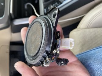

I know the center is just a cone but the side dash have a cone and something else on it.

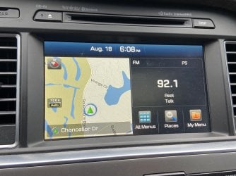

Looks like 15 year old tech on the nav screen display, but hey its got nav.
On those first two pictures, those are two way speakers.

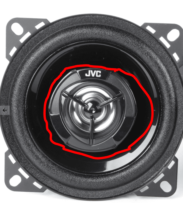

That is the other driver. If you have this, it's at least a two way speaker.

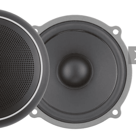

This is a midrange, you can tell by looking at the cone

In YOUR pictures, the first and second pic look to have a thin screen over the top to possibly keep dust out, but that is a two way speaker.
