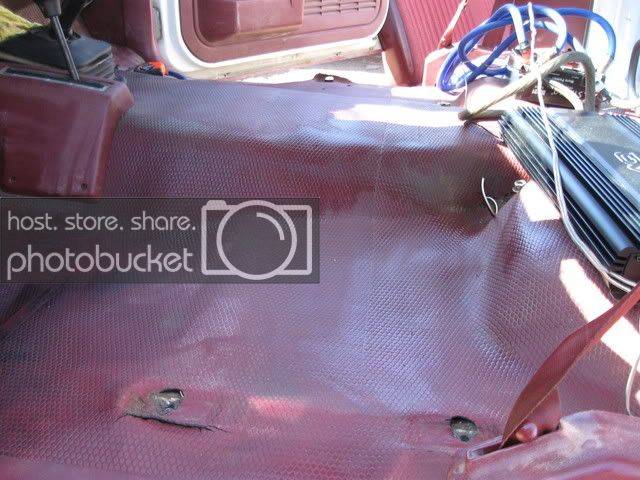

We started out by cleaning it up a little. This poor truck hasn't been cleaned for over a year.

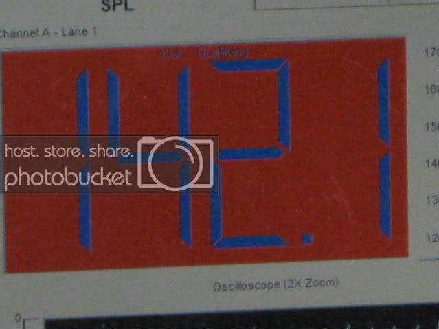

We started the day in the high 130s. This was in the kick at 51hz. My rear view mirror fell off on this one:

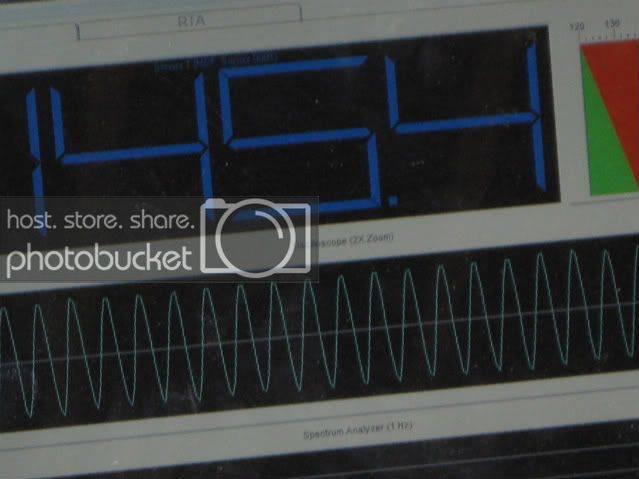

looks good man. //content.invisioncic.com/y282845/emoticons/smile.gif.1ebc41e1811405b213edfc4622c41e27.gif we will get it to a 150 by the show //content.invisioncic.com/y282845/emoticons/smile.gif.1ebc41e1811405b213edfc4622c41e27.gif my computer took a shit though so no termlab as of now. //content.invisioncic.com/y282845/emoticons/frown.gif.a3531fa0534503350665a1e957861287.gif but it will be fixed soon i hope. it was a fun day haha. we ate frozen steaks and drank a 12 pack of dr. pepper. haha. we started at a 138.8 and quickly got it to a 145.5 (not shown) not too much longer man. //content.invisioncic.com/y282845/emoticons/smile.gif.1ebc41e1811405b213edfc4622c41e27.gif
