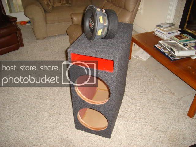

Anyways, it's 4.1 cubic feet with 50sq. in of port area tuned to 33Hz.
Here's the box all ready to be installed

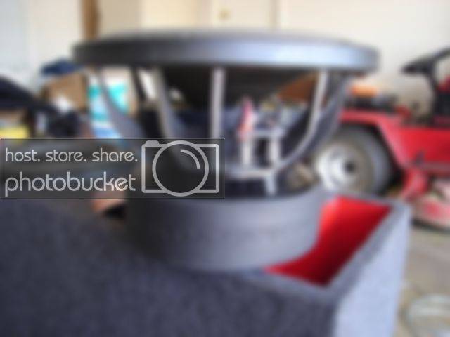

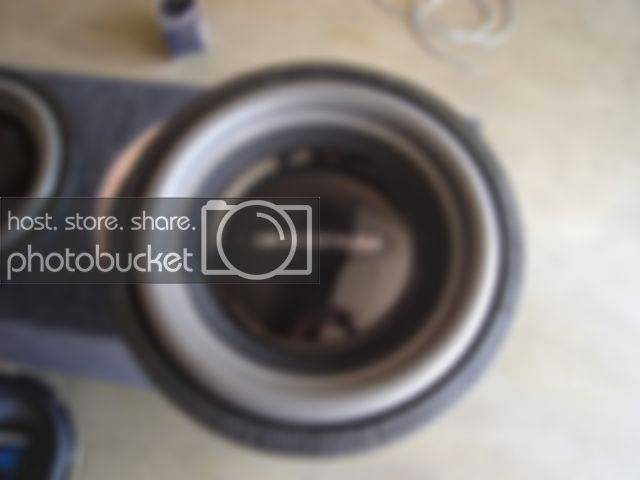

I'm guessing by now you're wondering what this "Soundstream Proto-woofer looks like huh?
Dave had a couple of extra Soundstream SPL-X dustcaps laying around and some extra 12" gaskets that had the Soundstream logo on it... looks pretty legit IMO //content.invisioncic.com/y282845/emoticons/crazy.gif.c13912c32de98515d3142759a824dae7.gif

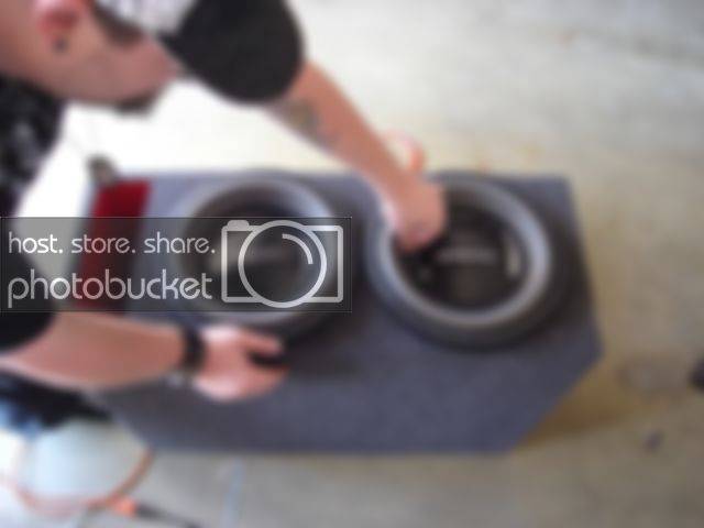

Here's Dave man handling the Konak....errr I mean Soundstream SPL-XXX Prototypes //content.invisioncic.com/y282845/emoticons/laugh.gif.48439b2acf2cfca21620f01e7f77d1e4.gif into place while I sit on my *** and take pics //content.invisioncic.com/y282845/emoticons/biggrin.gif.d71a5d36fcbab170f2364c9f2e3946cb.gif

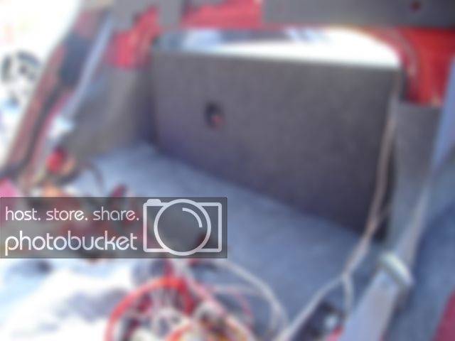

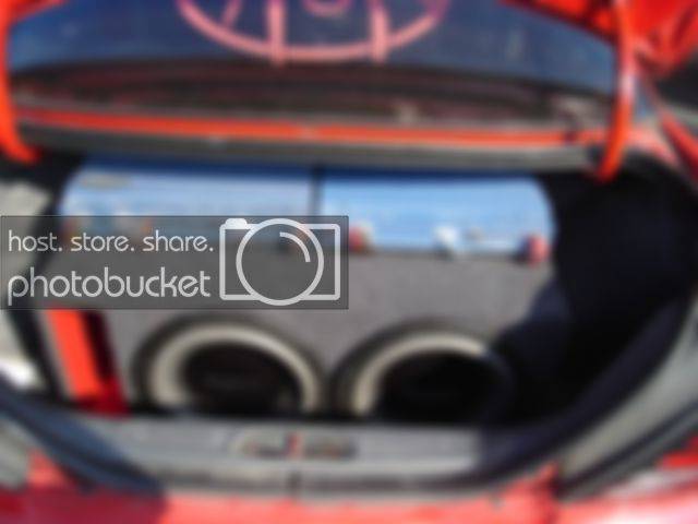

Holy shit! We actually managed to get the box in lol
The Grand Am trunk is nothing short of a complete joke. It's so shallow and skinny. We had to rip out the back seat bottom AND back and the stand the box in the back seat facing up, lay it down, and then slide it back into the trunk through the hole.

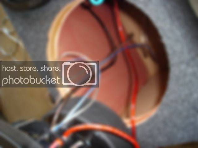

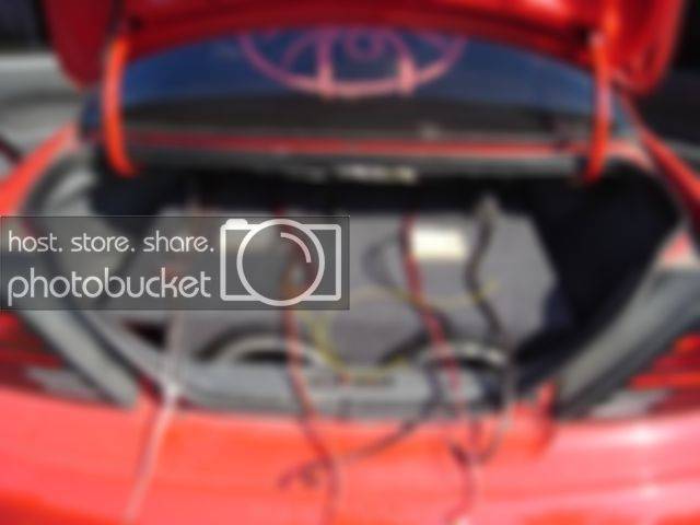

Mmmm... wires
More wires... and some little wood blocks to support the amps.

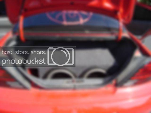

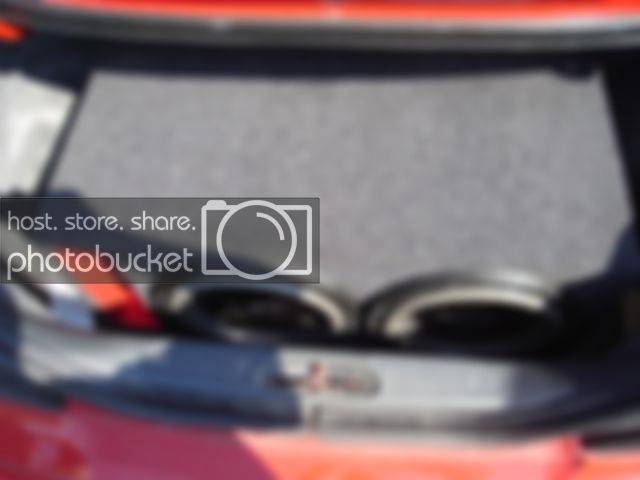

All finished, wires tucked away and amps mounted on the box. (Amps will find another location soon once he gets his new amp. This setup turned out to be a lot louder than expected and the amps literally jump and hop around ontop of those wooden blocks. We stuffed some extra carpeting between the box and the amp which helped, but they need to find a new home
We took a quick little video of them doing a 80-15Hz sweep and it's uploading at the moment, so I'll have it up here shortly.
All in all, I'm very impressed with the setup. These things are rated at 1200 RMS and I know those DD cloned motors will take even more. Given the fact that we're only giving them 1/3rd of what they can take (500rms), they pound really hard.

You should turn the box around and face them towards the front. Maybe seal off the cabin from the trunk.
I would just as soon hang myself from my garage door than I would try to get that box back out, turn it around, and put it back in. Besides... the back seat is only out to get the box in. Wouldn't sound very good firing into the back seat with the back seat installed again. It gets plenty loud anyways.
