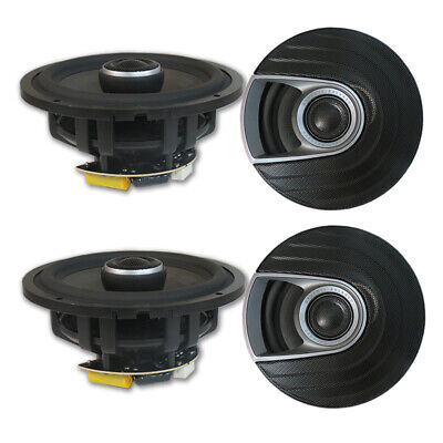

Marine speakers would be Ideal as stated and Coax. Polks would work very well.
First choice of mine would be

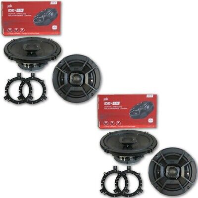

2nd choice would be

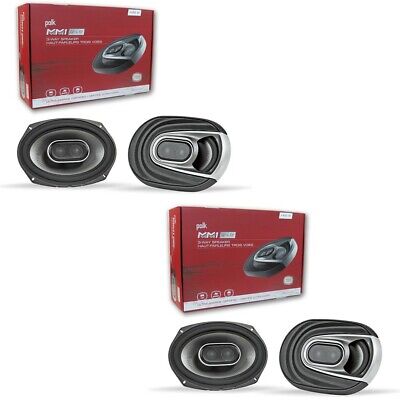

6x9 s would be really nice, especially if you have room inside and outside.. IMO of course
