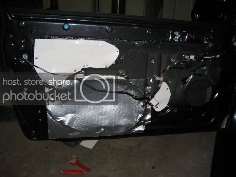

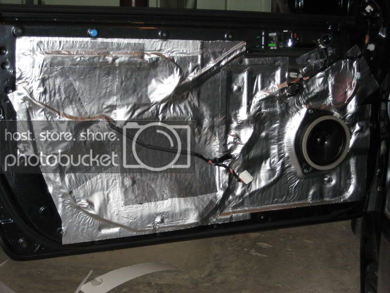

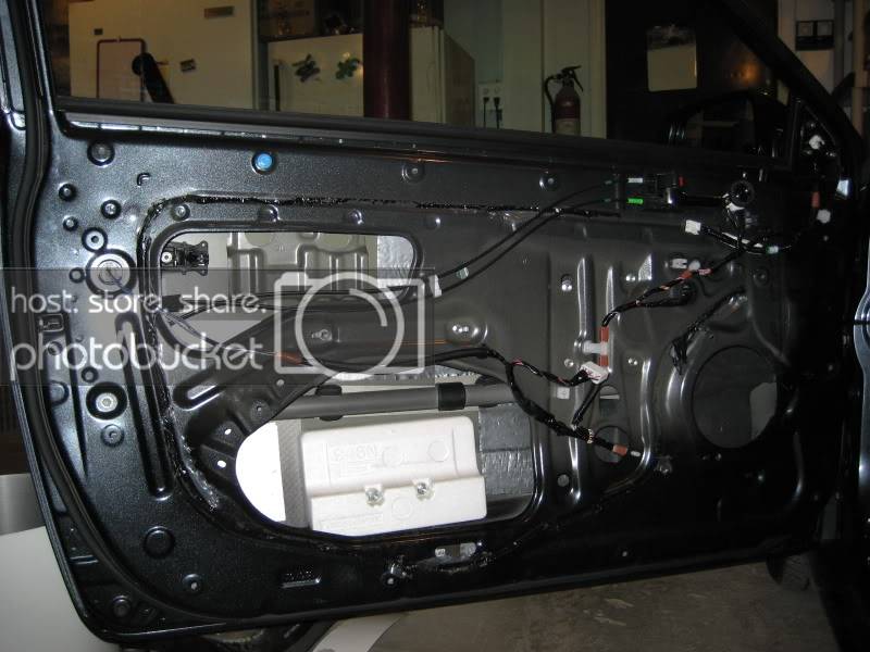

i used v1se on my doors, about 25 sq ft. it worked very well. made the midbass really come alive. helped a lot with road noise as well. before i could only have my door speakers crossed at 80hz and not really boost anything in the 80-200hz range. now i have them crossed at 63hz and boosted +2 at 80hz and 125hz, and +1 at 200hz. it sounds sweet and i still have my stock speakers in. i plan to get some PG RSD's in the near future and give them about 125 watts per side.
here are some pics of the install....
before...
during...
finished....
