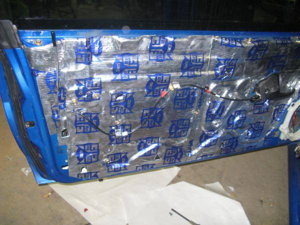

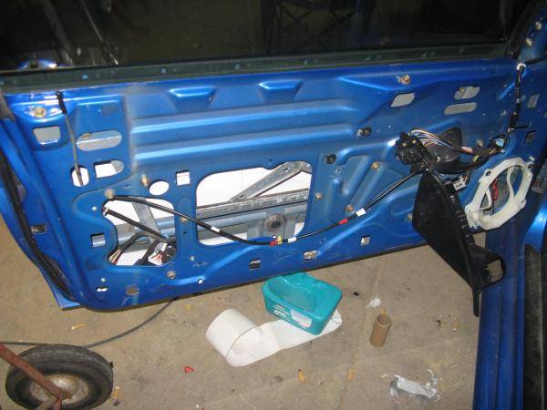

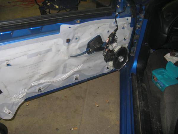

tossed the vapor barrier, re-routed the electrical loom to the inside of the door itself for minimal protrusion in the fatmat,... applied 30 feet of 4" butyl/asphalt tape to the inside of the outer door skin (cheaper and easier to get inside, added mass=deadening), cleaned the surfaces thoroughly with industrial windex-like degreaser+wax stripping agent for proper adhesion before applying

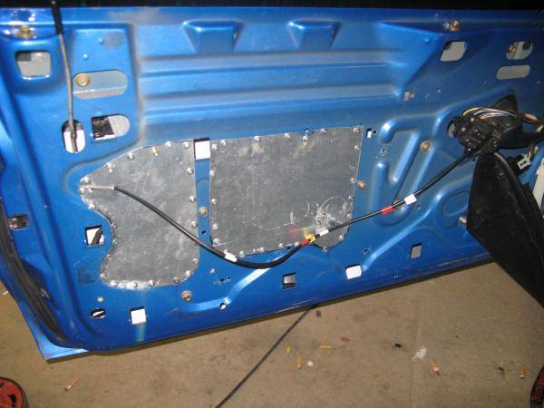

had to fill in the big holes, good thing i had a bunch of sheet metal lyin around,.. note the left piece has had the left edges bucked to form around the chamfer seeing that there was no flange to fasten to around it, and was fabbed to allow the door latch cable to operate uncompromised... i used 3/8" self tapping phillips pan-head sheet metal screws
1 good layer on, took the window track nuts and bolts out 1 at a time as i went instead of covering over them for better ease of getting the fatmat as flat as possible,... not 1 piece of deadener was wasted,... 5x7's will stay til i get enclosures for the zpm130's figured out,.. the voids will be sheet metal'd over once that come to fruition,..
panels are easy to remove for access to innards if I need to get in there, just gotta cut and peel back the deadener from the screws to detatch the panel.
made a very noticeable difference immediately,..
after 3 years, it still holds up great
