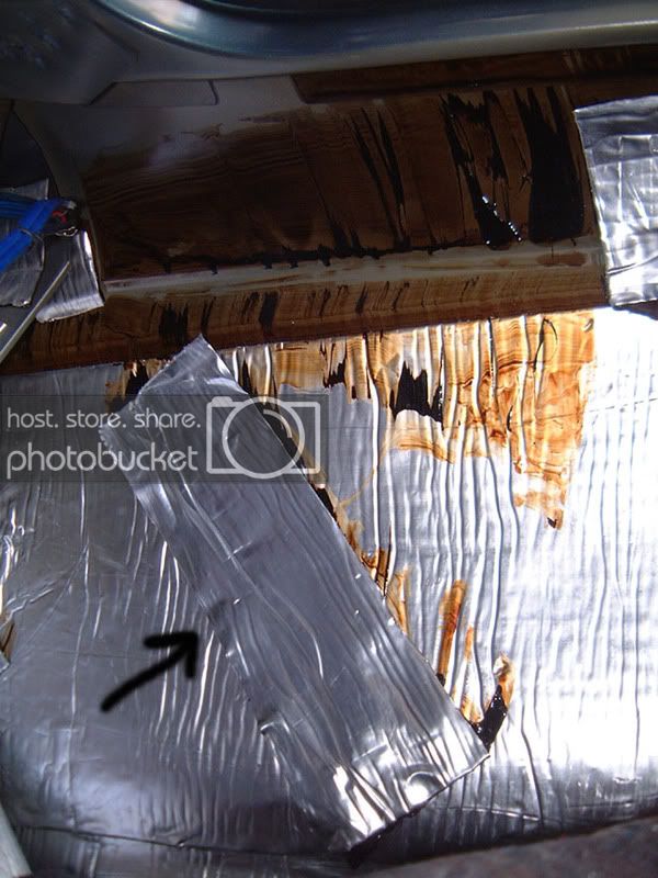

edead comes from eD which is a garbage company and after a few summers your deadener will look like this
