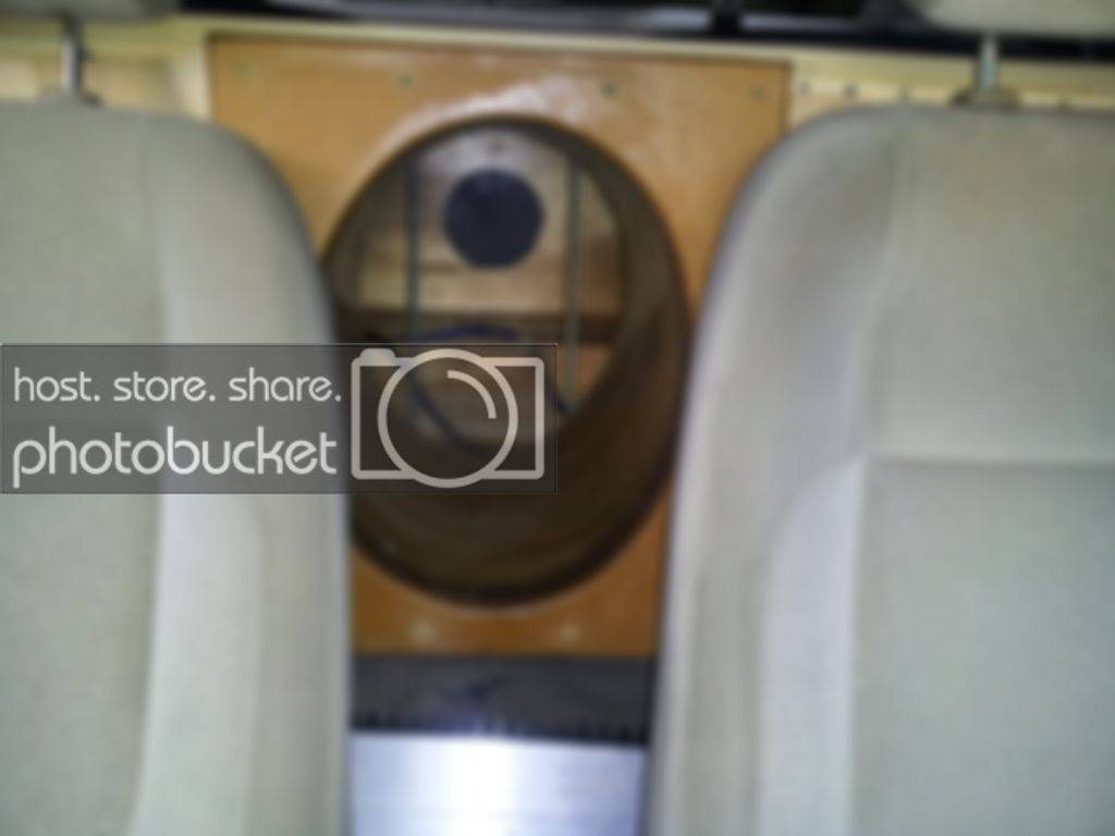

12.5" made oval.

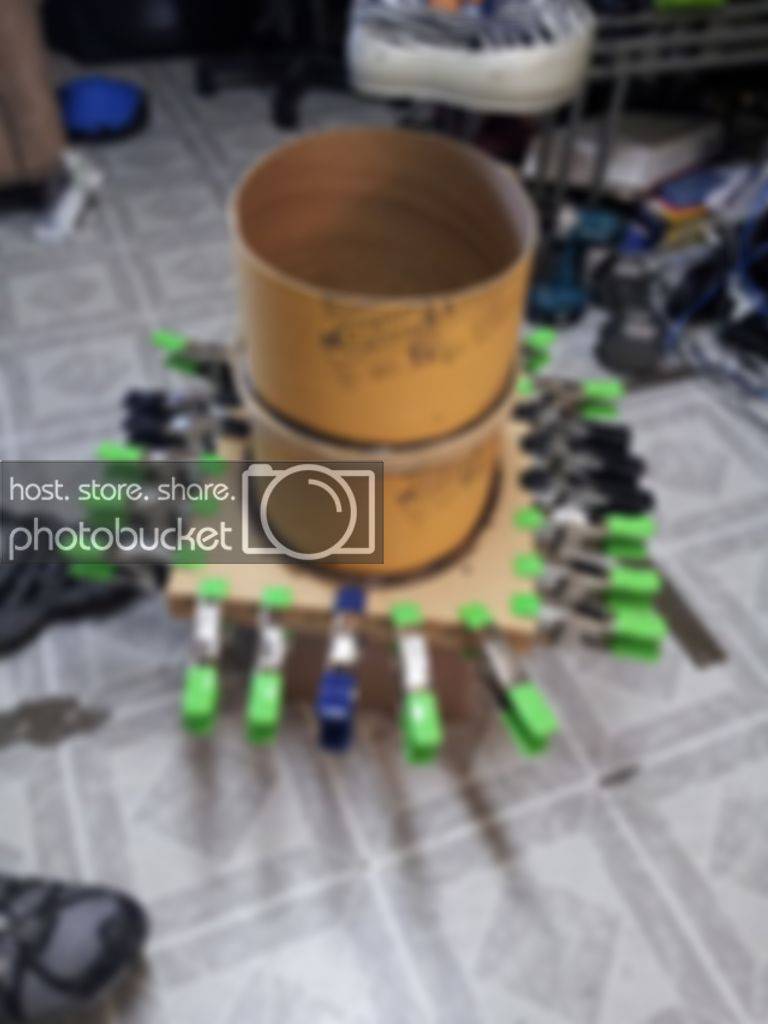

first baffle is flat to the tubed, added the second and used a router to flush them up. Then round over on the out outer baffle.
You will need to resin and coat it a good bit as the port its self will resonate.

that port in action
Cause my port was partially internal/external I had to get creative for how I secured it since I couldn't fit a drill in to screw it to the wood.
Get the port to how you want it then secure it in place with duct tape:
Seal up one side of the wood/sonotube with plenty of liquid nails. Wait a good 10-15 minutes for it to start curing. Then flip over the entire thing, and now fill that whole gap with wood glue (this is why it's important to seal it up good, the liquid nails will act as a "container" for the glue). Let it sit overnight to fully dry before using it. I didn't have any issues with the tube resonating but I was only using the 8". If you're using the 10 or the 12 then consider using resin.
