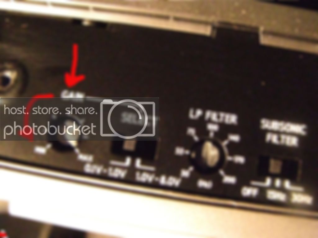

heres a pic of the pdx controls:
get a small flat head screw driver. gently turn this knob the direction pointed to.
this will turn your gain down.
gain acts like a volume knob on the amplifier for a eazy explination of it.
yours is turned up soo high it is causing bad things.
turn it all the way down, play music in your car at a good listening level,
and verry slowly turn the gain knob back up, until you hear the desired boom
from your subs. remember more is not always better. it should sound good.
it should not sound like a pack of lamas farting up a storm in your trunk.
if you get it up to distortion level, back it off some.
yea my bad, we tried turning it and it was maxed out...but still turning off even when we turned it town half way

like said above, keep the gain under half for now (you can set it properly later on, we can show you that too). double check the ground like said above, follow the ground wire from the amp and see where it goes. take a pic of were it connects to the vehicle if you can.
