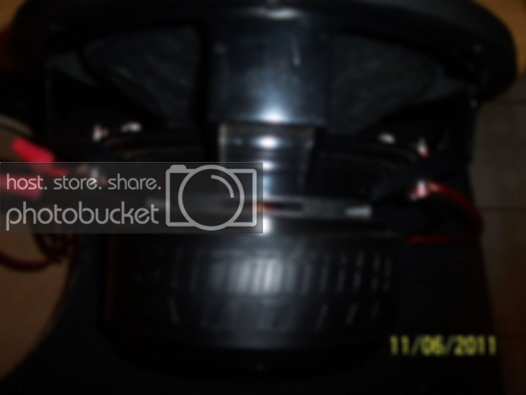

I'm not informed enough to offer an opinion,BUT, I would for sure LOSE THOSE TWIST NUTS on the sub.Unless they are soldered inside,they will vibrate off and the resulting short will smoke something in your system..
