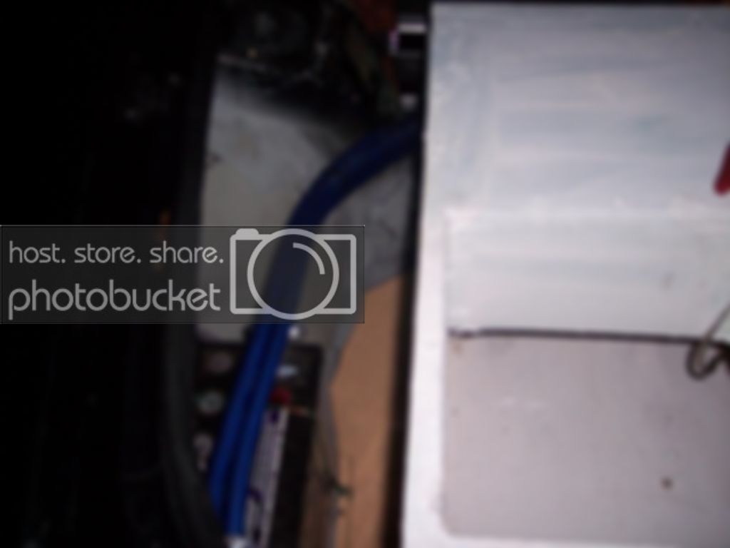

well, i did the electrical upgrade today, ran all the kicker 0 gauge i bought from my Authorized Kicker Retailer! I've ran alot of wire, audiopipe, monster, stinger, Knukonceptz, and i gotta say, this kicker 0 gauge takes the cake on easiest to work with, you'll see what i mean.
so let me outline the project, adding this battery:
to this electrical system:
inside this car:
very small car, hard to work with think it'd be a ***** to run 0 gauge through huh?

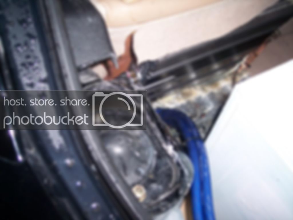

not with this wire, it rained 90% of the day, at 4 o clock, i had a window in the rain, so it's 6:30 now, in that time, i re-did my factory power wires, covered them with loom, drilled out the 0 gauge hole in my firewall for 2- 0 gauge wires, ripped out the old 0 gauge wire, pulled up my carpet, put in the new wire, replaced the carpet, and wired the battery in the rear, all with a razor, a socket set, and a set of allen keys, amazing? possibly. probably not though, but this wire definately made it easy to do, if you close your eyes, and pick up the wire, it feels like gigantic spaggetti, it's an installers dream.
have you ever seen 4 runs of 0 gauge lay like this?
crazy, and it wasn't hard to tie-wrap them like that, very easy to be honest, i'm just amazed by this wire, and yes, it was worth 5 dollars a foot.
what did all this work give me?
almost 15 volts, i re-tested with my other DMM, gave me 14.89, so one of them is off, but they both cant be THAT wrong, i'm pretty impressed.
