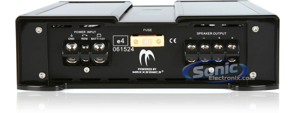

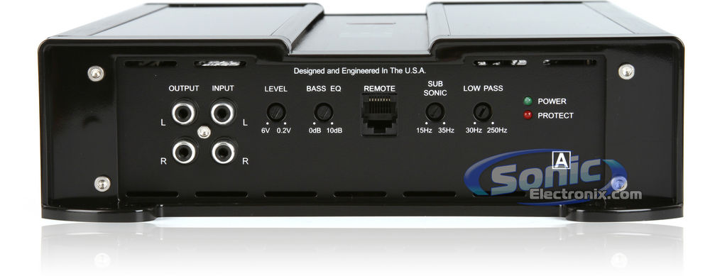

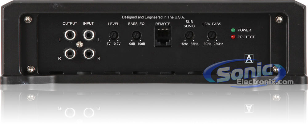

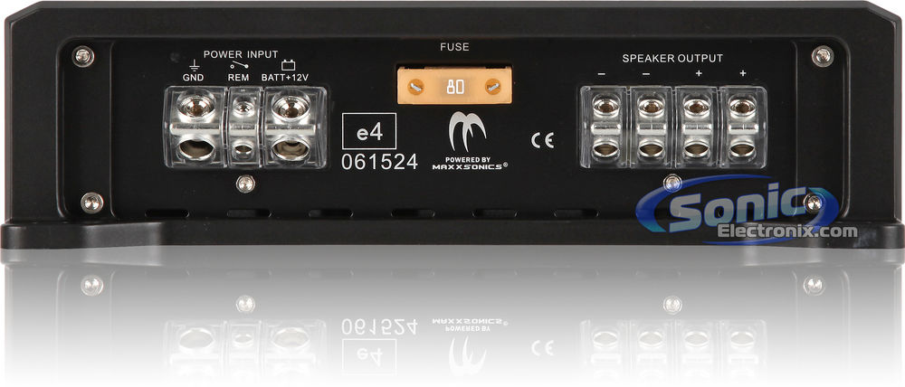

So i take it they are exactly the same amp

I don't think I would really care, two amps rated at 1000rms and another at 2500max and they each run a single 80amp fuse? They are either the worlds most efficient amps or highly over rated! I only know I don't want to use either!

If you think a 1000 watt amp really needs more than 80 amps of fusing, you are mistaken. People started correlating amp rating to power output, so a lot of times amp use a slightly unnecessarily amount of fuses that you'll never have a chance of blowing under normal conditions. Now, if you wire the amp down to
Also, look at what people are using for fusing in these orgs that base your class on your fuse rating. I believe someone said they're burping their Kicker 2500.1 with a 60amp fuse, and doing 30sec runs with a 120amp fuse.

Lots of amps are underfused for the power they claim
