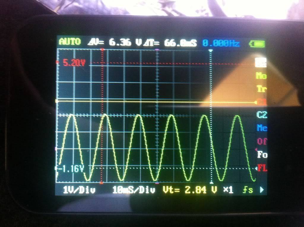

Wondering if you need any certain type of O-Scope to set gains...
I found an O-Scope cheap on newegg ($80) and not sure if it would work for setting gains..
Newegg.com - ARM DSO Nano Mini Pocket-Sized Handheld Digital Oscilloscope
Being it's so cheap in comparison to what I've seen before, I'm curious if this would work at all. It's cheaper than a DD-1 and other scopes... Wouldn't mind tossing it into my toolbox if it's worth a ****.
Opinions...?
That scope is great for setting HU, highs amps and anything under 3k, but it's only 80vpp (volts peak to peak) with the 1x probe. If it comes with a 10x probe, you're good to go. It's an aawesome tool. It looks just like an iPhone. I love mine.
Looks like it'd be just the ticket for gains, except as mentioned you will need a X10 probe for the voltages that we usually deal with. Ask Newegg if there is a X10 probe available for it.
The pictures aren't real clear but it looks like the probe does not use the industry standard BNC connector.
Hmm.. Sweet! Looks like I'll be ordering one of these here soon. Will be nice to have. I don't plan to go over 3k anytime soon so it'll work great.
