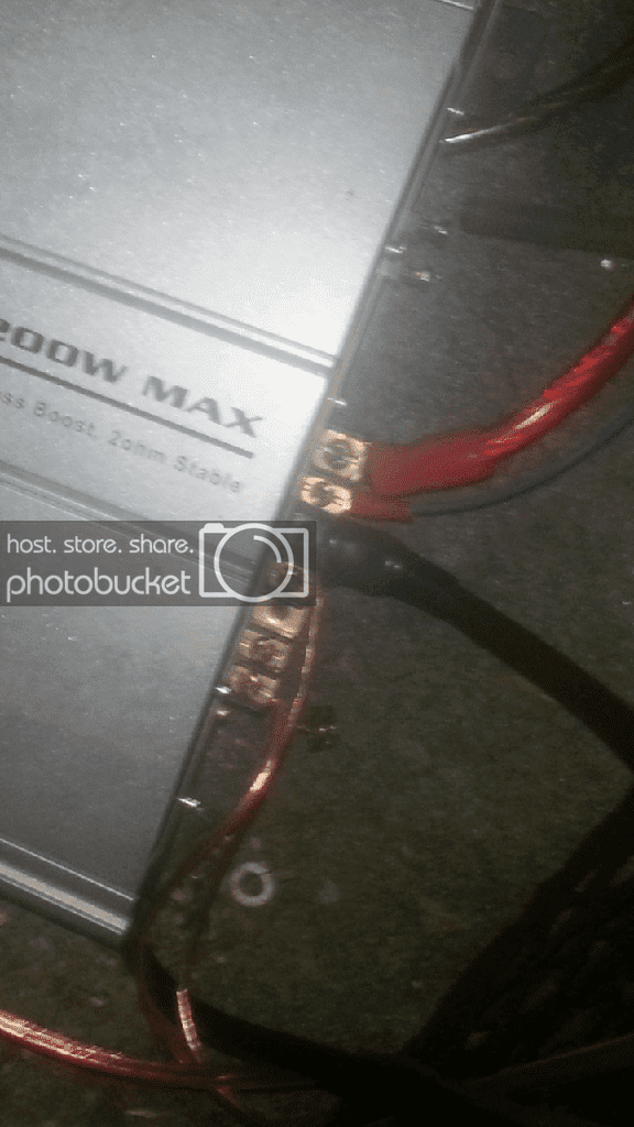

I have a single kicker CVR 12 in a ported box with a SPL 1200w amp, I just completed instillation yesterday and today I was listening to music and then my amp was cutting in and out then I smelled smoke in my car so I opened my trunk and I noticed the black rubber from the ground on the amp was melting and smoke started coming from my amp, help!! I'm thinking it's just the rubber melting that covers the gold spade connector? Also my copper wire on the ground turned black/sliver color, any help would be appreciated and the amp still powers on and works, thanks

OP. Either you have a poor connection on that ground cable or the amp is burning up because it's cheap Chinese junk and has some internal fault.... possibly both.

Best to verify that the gound is firmly connected to the amp, the terminals are well secured, and you have selected a good spot on the frame of the vehicle and sanded it down shiny to connect the other end. If you have verified your ground is good there's a problem with your amp.
