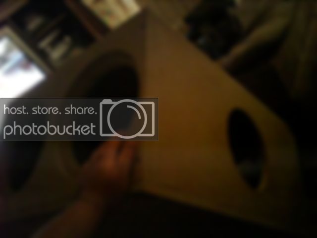

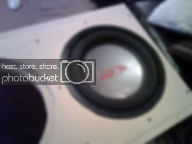

Well im doing another class for USACi this year....StreetBeat 2, so what a better way to try out 10" Type Rs....thisll be my first time using them and will round out the cycle for me with Rs.
Box Specs:
4cu .......6in aero.
DK what ima tune it too yet.....i could go 29-38hz...might go around 35hz
Thanks to Mobeious for the cutsheet...even though he bishes all the way when i say i wanna..... "try them this way".......//content.invisioncic.com/y282845/emoticons/biggrin.gif.d71a5d36fcbab170f2364c9f2e3946cb.gif
Gonna get em wired up tomm....and see what happens //content.invisioncic.com/y282845/emoticons/smile.gif.1ebc41e1811405b213edfc4622c41e27.gif
Thanks to Kenneth1083 for help with the box as well

i see 2 axis braced X and Z..what about the Y axis bracing??? mainly that big nekkid panel in the rear?? maybe a vetical brace against the piece??
props...you coming this weekend???
yehhh....I shoulda...if this works out ill take the top piece off and do that and bottom/top braces

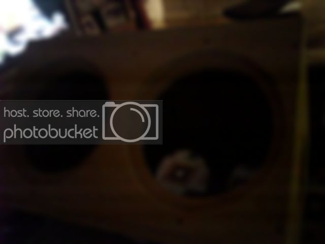

Welp ....im back off too work to finish.
Had to come home and gets me some allen wrenches, cutters, 50hz tone cd, drill bits, watermelon, 1/2 cup of Capn Crunch (peanut butter), the prize outta a Cracker Jack, Boardway McDs monopoly piece, foam #1 finger(LSU) , and a National Treasure 2 ticket stub

I was just about to ask this.
I think the guy was curious about your port area because according to the "rule of thumb" you are 1 sq inch under the minimum of 8 per cubic foot. You may not have any issues though.
