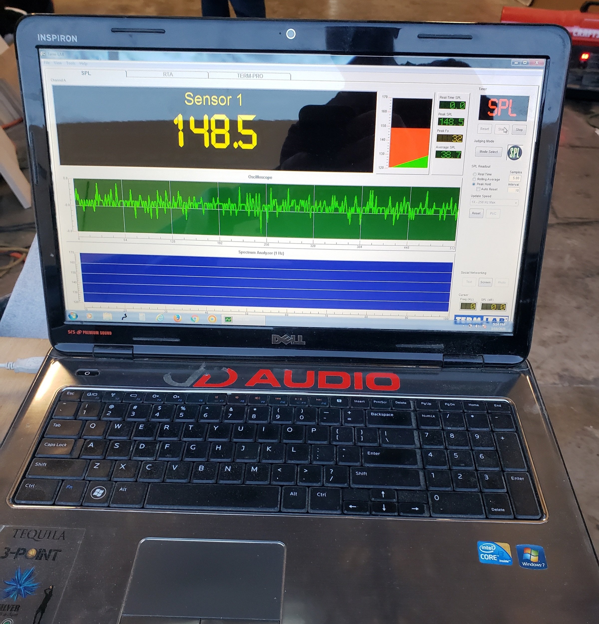

I think the SIA is running Korean capacitors like the SALT line. I was running an MD3000 on an AB HD15. The SFB's are better IMO because they can handle more volts. The Taramps pretty much only like 2 volts. The Sundowns can handle more. My VFL 8's did a 148.5 at 32 hz. from the kick.
I am impressed at the frequency, little fellas get down! 4 8s will be the equivalent of at least a 15, a 15 doing those numbers isn't shocking so if broken down like that and running collective 3k to them makes sense. The wow factor and its still impressive I don't want to take from that. I will believe what ever you tell me what you metered. I don't see a sense in lying but anyway either way congrats.
Almost as much cone area as 2 12's and his score is metered "outlaw". It is very probably 146 and small change metered DB Drag style which is OK for that power and cone area in a pickup truck.
