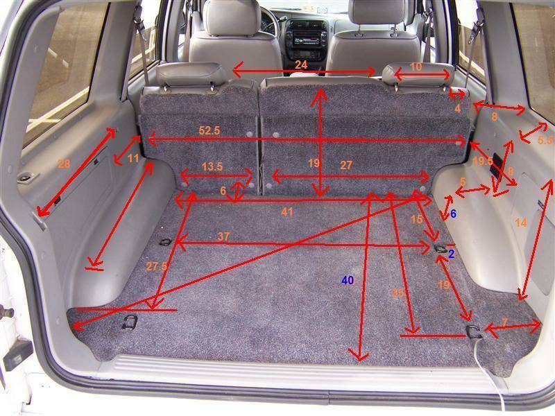

Give me some measurments i can get you in the 150s with a fi 18 and that 3.5. Its really abit much for it but its perfect power for comps..
