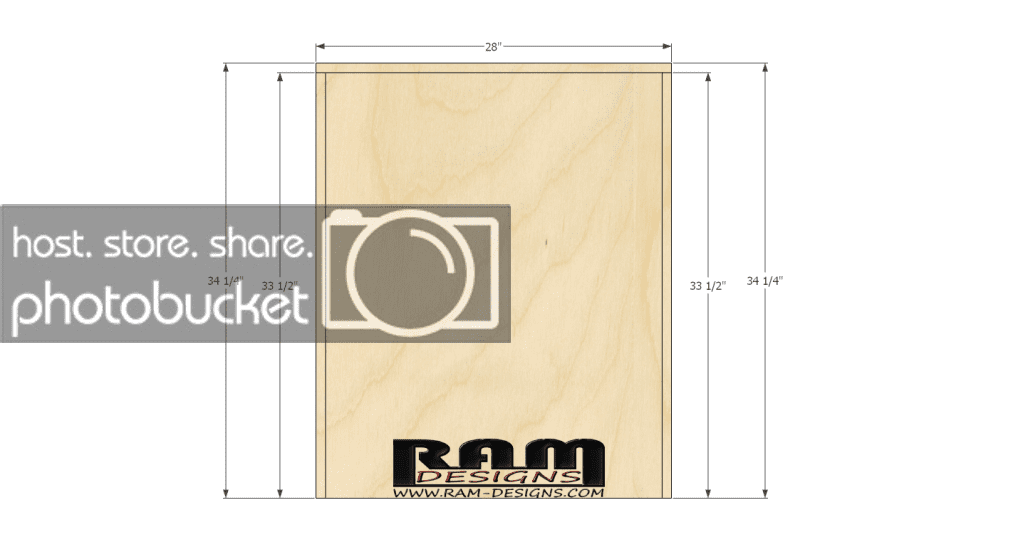

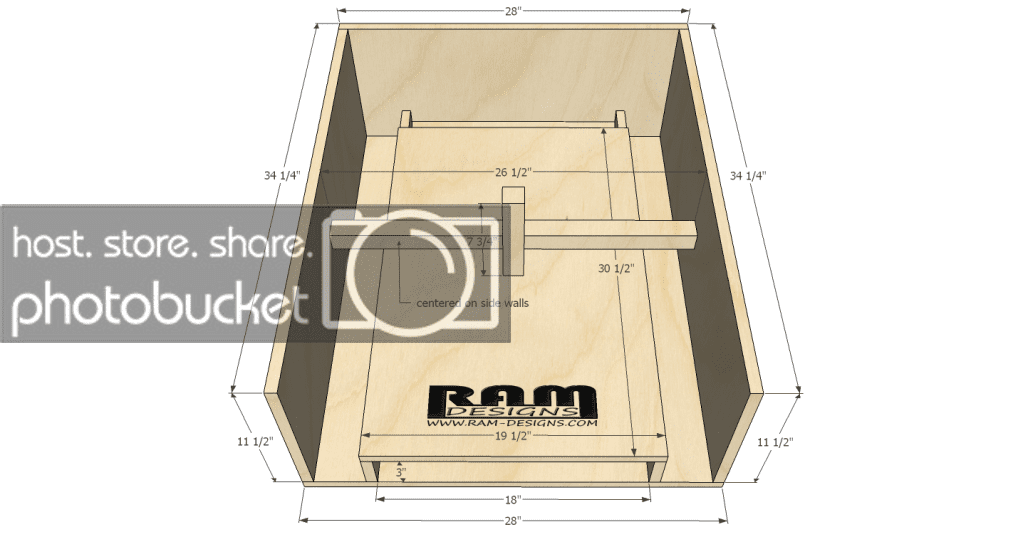

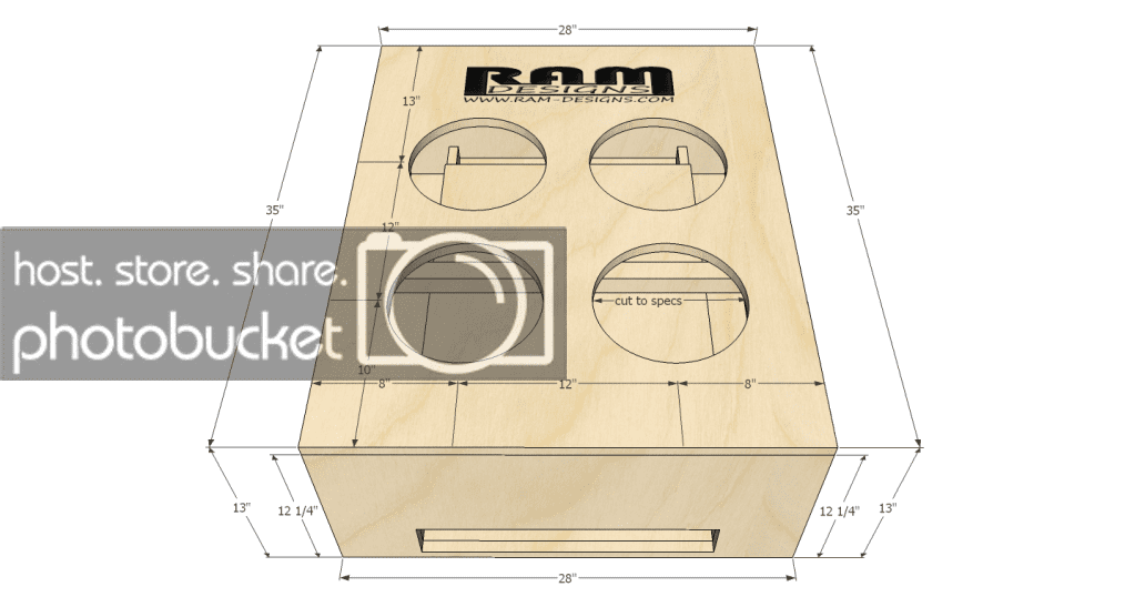

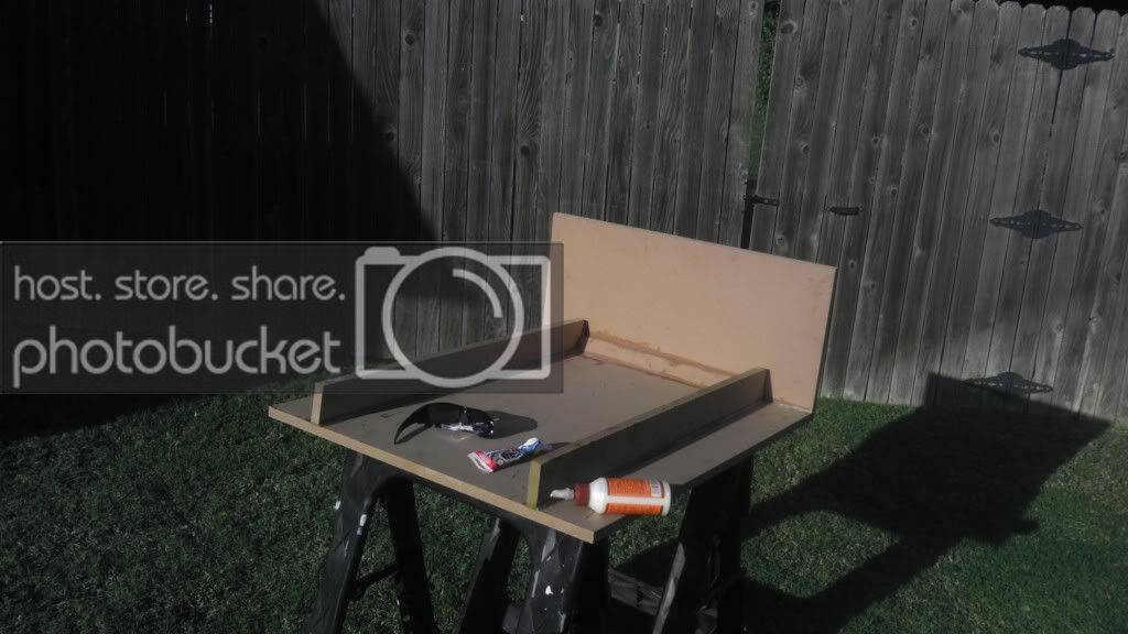

The wait is over! 4ft^3 tuned to 30hz after all displacements and such. Quad Skar VVX 10s will have a final load of .5 ohm and will be ran of a DAT Prototype hellfire 2500 should see a little over 3k out of it at .5

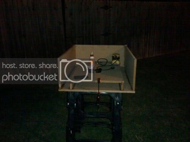

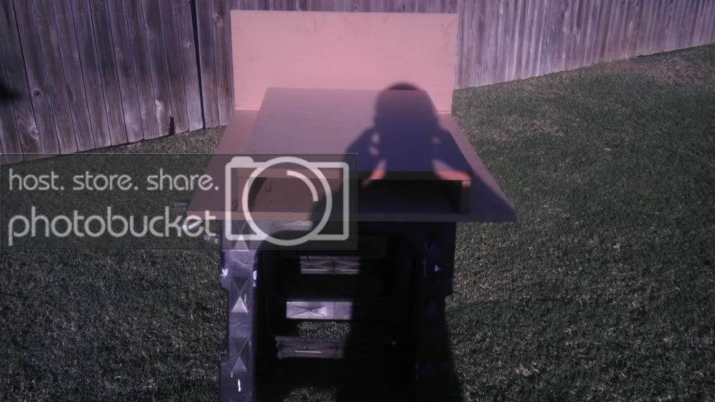

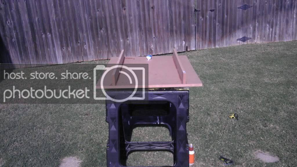

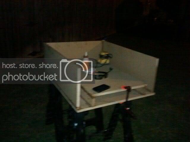

Updates ran out of sunlight will have to finish it tuesday! I have never built ANYTHING out of wood this is my first time building really anything so be easy lol i did well imo have to put on front and top and cut out out for subs and it will be done!

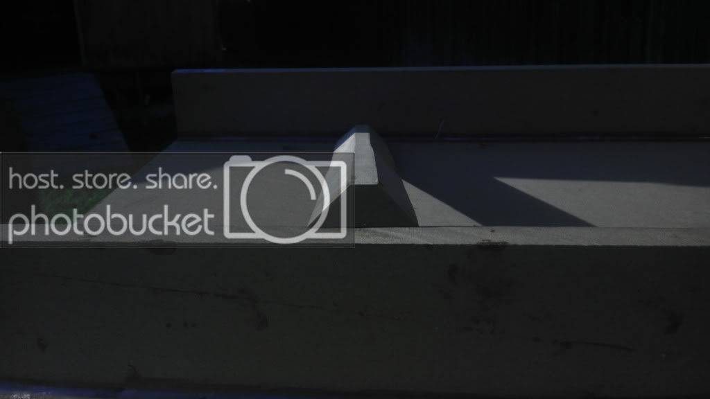

My first 45* ever!
Lol eager to learn really what flaws do you see?

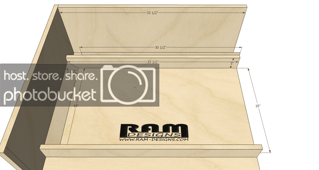

Slot ports that don't fill up the whole width of the box restrict the air movement because you introduce a lot more corners. A "traditional" box that has a single large slot port on the bottom with a big 45 shoved in the back corner allows for great air movement whereas that design really blocks a lot of it.

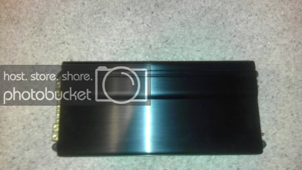

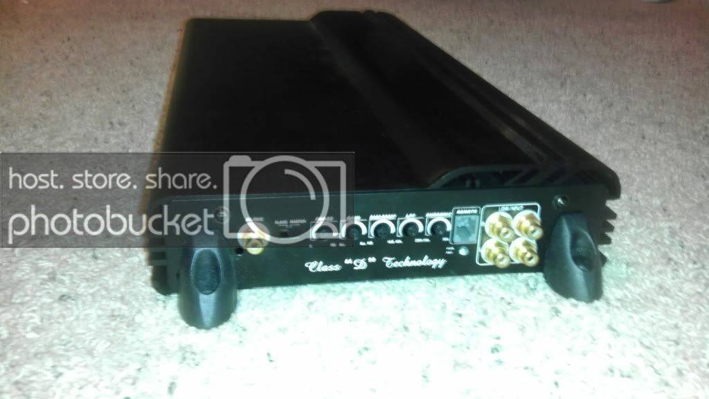

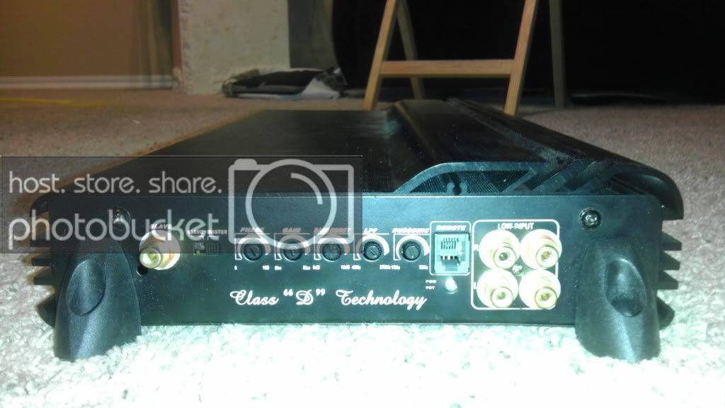

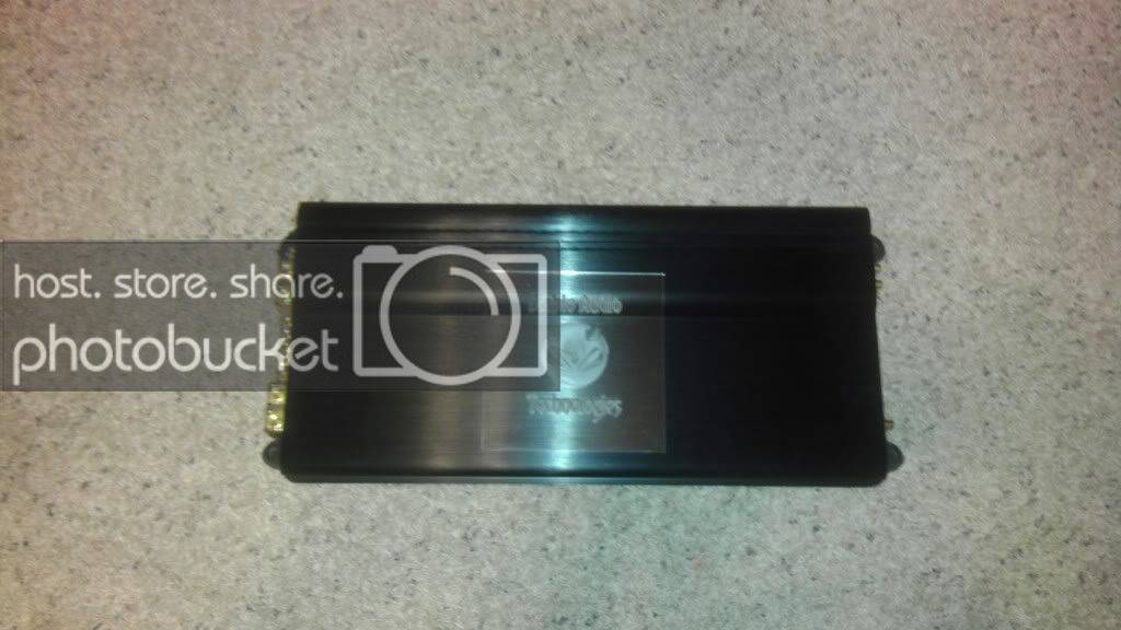

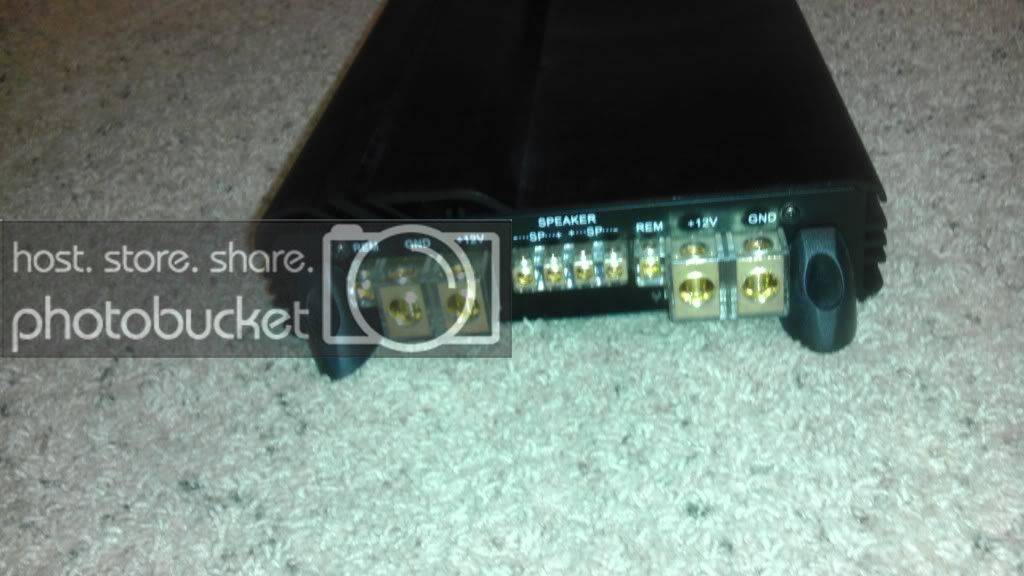

Got amp today love the look of this thing solid black very plain no etching at (its the prototype) seller through in some goodies a plexi glass etching of DAT logo and name which im thinking ill use it on a amp rack or something he also threw in some quantum audio 1" tweets i have no use for but ill take em! Picking up some more 0ga sometime soon locally going to do a complete run + and - from front to back and get my alt back in and install comps finish box and buy subs
Bro you did not buy a DAT amp! WHAT THE FUCK WHERE YOU THINKING!
and on the box, it looks like you cut the sides 3/4" to short..... unless you are going to cut out the part for the port and slide it over instead of placing a front piece on it and using a flush trim bit on a router.
Yes i did buy bro been wanting to try one but like i said its the PROTO the productions models are what took a **** and yes im cutting the front to fit flush
Is that 1in mdf?
