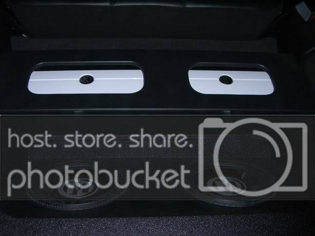

My sister just got her 02 SS back from the car audio shop. She got memphis speakers all around and an alpine 9855 mp3 player. For the rear she got a Memphis 1000d and a Memphis 300X4(white marine amplifiers to match exterior paint). She is not happy with the subs. She got talked into the cheaper m-class 10'' subwoofers (200W rms each) in a sealed probox. Im pretty sure the amp is wired at 4 ohms currently so its not being used to its potential. The bass is not loud at all but i didn't expect it to be when she told me what she chose. The memphis 1000d she has is a pretty good amp from what i have been reading and the only thing holding her system back is some nice subs. She wants some nice subs that are loud and clear and that will work in her ProBox. Im thinking of getting some Diamond D3's or maybe some D6's (Amp puts out 1100 watts @1ohm). Have any other suggestions? Looking for some less expensive yet good subs that will tromp on these memphis subs. What subs will work good in a rather small sealed enclosure (.86 cubic feet per side) with about 550Wrms to each?
Pic of Stereo:

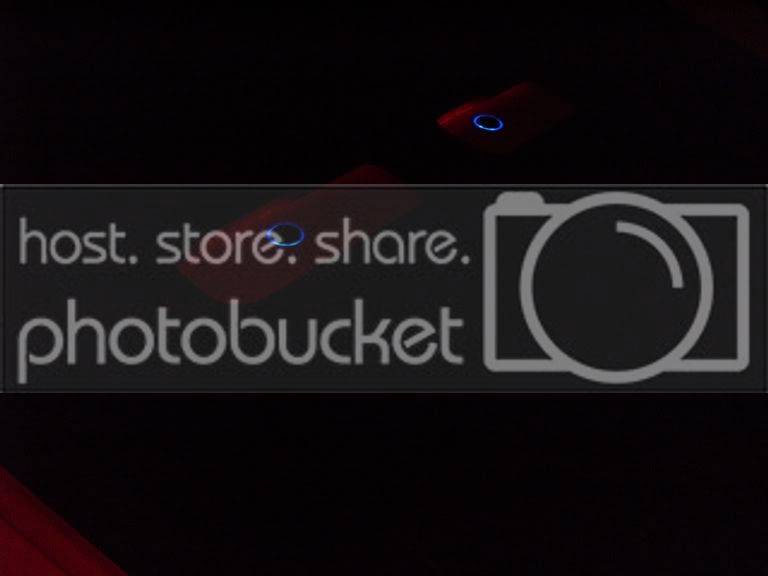

Pic of Stereo at Night:
