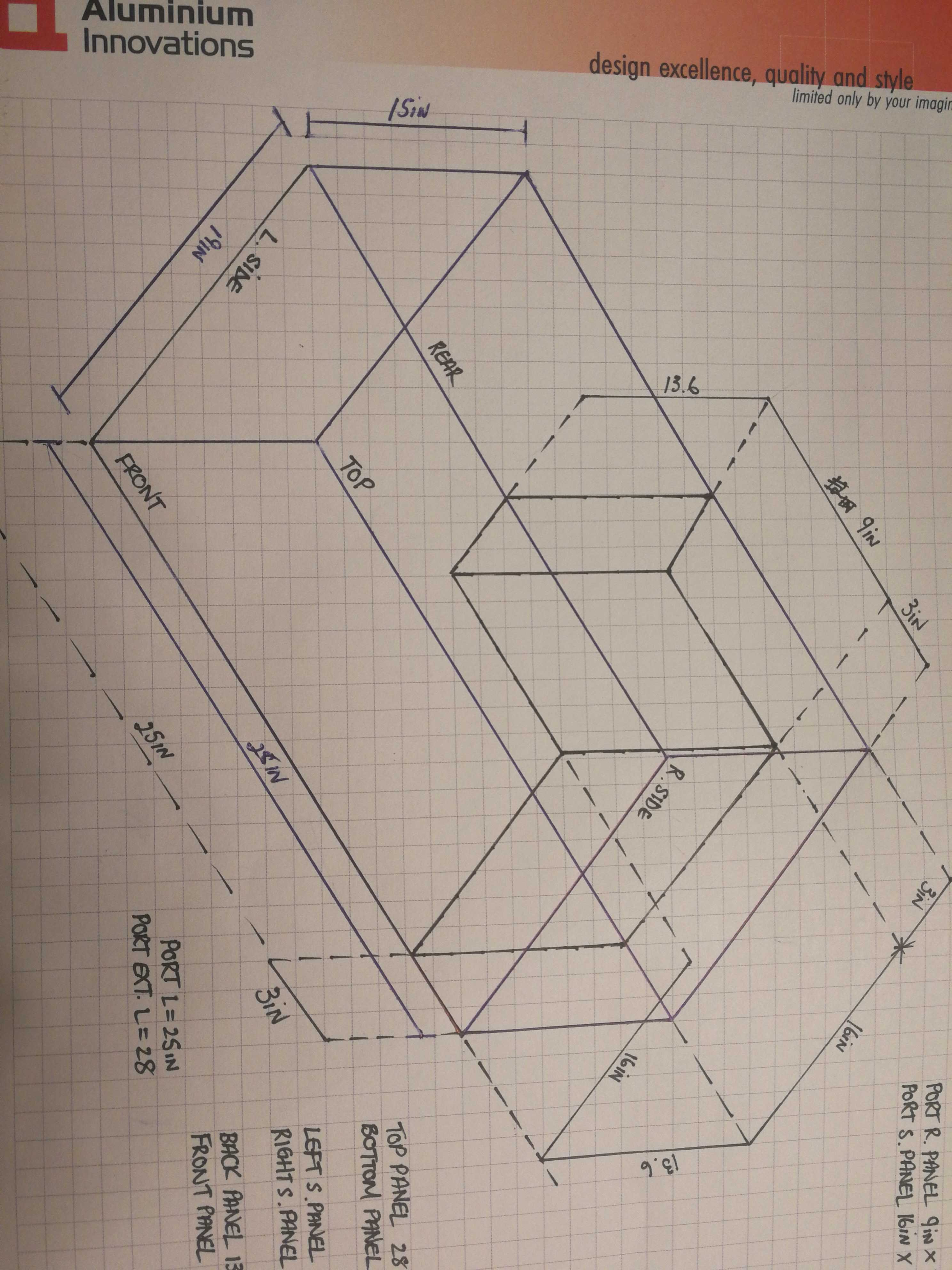

Okay.. So it does really seem quite difficult and I am stuck big time so hear are my measurements. 40cm height. 76.5cm width. 44cm depth All measurements are external (18mm MDF) All up it's 107. 2LTs. A single sub requires 50.6LT so I hope I'm on the right track there since I'm running 2 subs. I'm aiming for about 32-38hz but feel free to coment negatively on that. I'm struggling creating the correct measurements for my ports an find somthing that directly concentrates on how to do calculations for the port... So plz help.

Would appreciate anyone double check before I begin cutting.

You've created something close to this...
You gonna' go with THAT ^^^^????
BTW... It'll probably have poor low frequency extension... you're "Bonecrushers" will probably become "Braincrushers" in that box...
If you can fit it in your "boot"... this looks to be really strong at a low tuning... if you are curious I'll do it up in Torres but I'm getting tired of this... give me your EXACT measurements available with the battery in there and all the way to the hatch... I'll adjust for port clearance...
Looks like you adjusted the box measurements to fit... and ended up with a very small box, space makes bass, the 4 ft3 net box was smallish but I went by the measurements given... what space IS available with the battery in there?.. come on man... this is getting old fast...
That hand drawing actually hurts my eyes.....no joke. Too many lines intersecting one another makes it difficult to see the actual enclosure he drew. Might be better using Google Sketchup or similar drawing program.
It's nice huh?.. no accounting for material thickness and he just arbitrarily hacked the design then came up with a 2.7 ft3 creation all by himself... I really tried....
With the space he has based on his drawing he might be better off with both drivers in sealed, or single driver in ported, but the pair in that ported space would need to be tuned for spl high tuned I guess.
