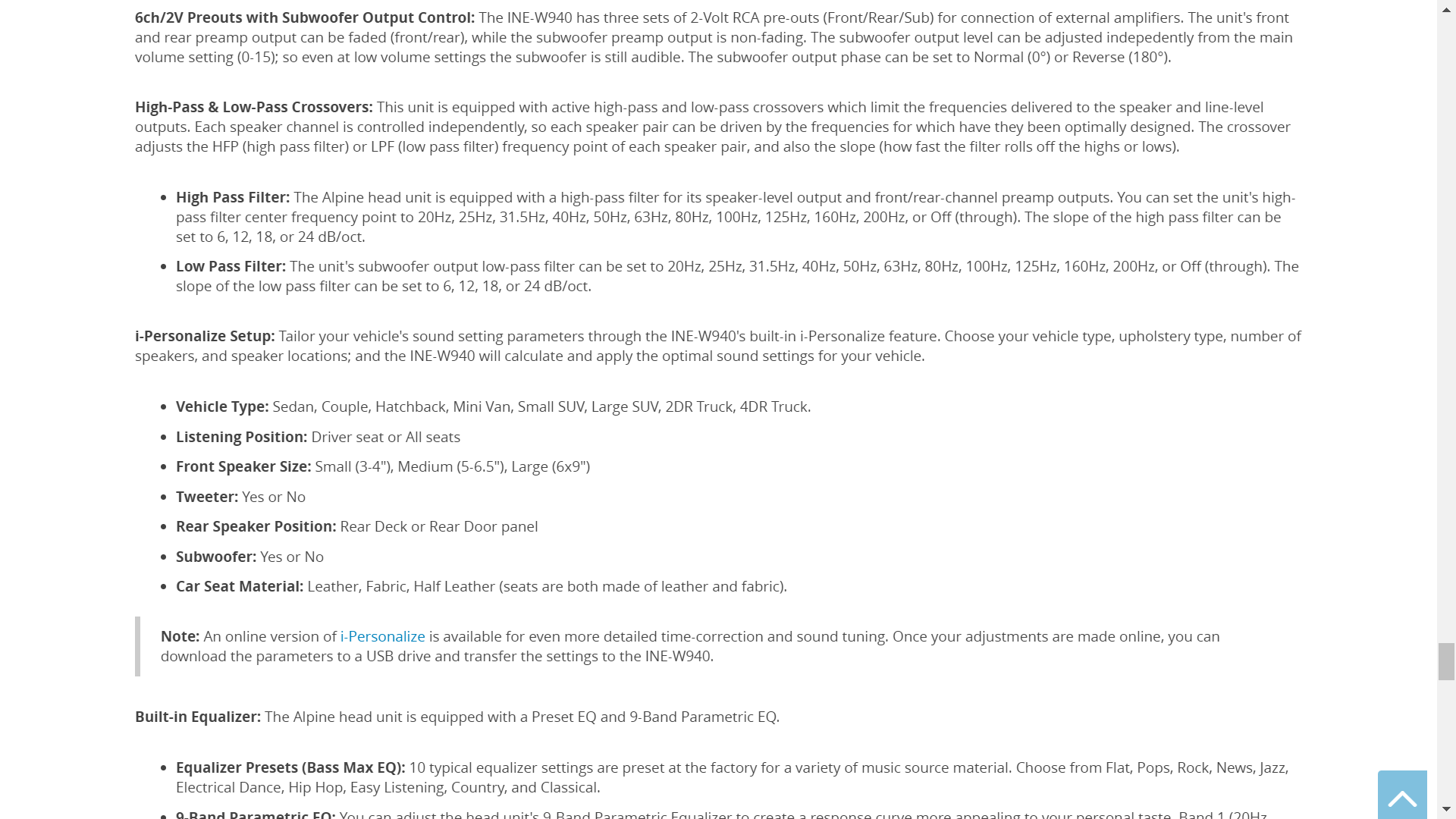

no it doesn't
It requires both a mid high pass which is anywhere from 50 to 200hz. A mid low pass which is anywhere from 500hz to 8000hz, a "High" high pass which is anywhere from 1250hz to 12,500hz.
Your alpine just has basic sub woofer and mid high pass filters, extremely basic doesnt go anywhere about 200hz and thats only for subwoofer and midrange, nothing to control upper midrange nor tweeter. compared to what we are talking about. You still have no clue what we are talking about sorry to say, most people cant absorb that concept properly and think they head unit does what we are talking about and they cant be anymore wrong. Its fine since its a hard concept to grasp for most that just assume car audio is plug and play while being completely oblivious to physics and more advanced concepts of car audio.
no it doesn't
Your alpine just has basic sub woofer and mid high pass filters, extremely basic. compared to what we are talking about. You still have no clue what we are talking about sorry to say, most people cant absorb that concept properly and think they head unit does what we are talking about and they cant be anymore wrong.
Im not saying for sure it does but I will be having a good look and confirming with you what it does have... In any case I'm still gona get the head unit u speak of cause it does have a much more extensive audio settings. I sent a msg to the seller to find out the DAC of that jvc.
Sent from my MHA-L09 using Tapatalk
I'm saying i'm 100% sure I even listed the crossovers you have specifically... I know more about your head unit then you do apparently. Again crutchfield has everything listed even more than the manufacturer website themselves. Sorry, i'm a head unit enthusiast. I know almost every head unit and what has what features audiowise. Not sure how a head unit of these specs would warrant a high sell price when its only weak 2 volt pre-outs.
Bladdy hell mate give me a chance to educate myself lol... Can you tell me how to get to that page you post with those specs.
