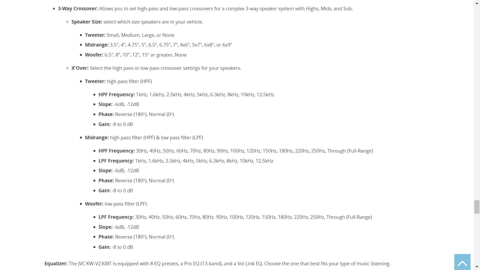

its a lot more limited audio options wise. 9 band eq vs 13. no active networks either.
$240 brand new.... Bargain? Will do the job? 13band eq.

If you plan to run components in the front (separate midrange/mid-bass driver and tweeter) then an active network capable HU is awesome!
Okay then I'll stick with cheffs choice cause I'm running mids with splits in both rear and front.

@Papermaker85
how is that line of jvc?
Seems pretty similar to yours but it doesnt list the DAC they use inside.
[quote name='Bassman999']So much better than passive x-overs and no need to use x-overs on amps[/QUOTE]
I'm actually surprised to see another brand of head unit offering active network mode other than pioneer aka the jvc ones. Kenwood doesnt have it but jvc does.. thats wierd.

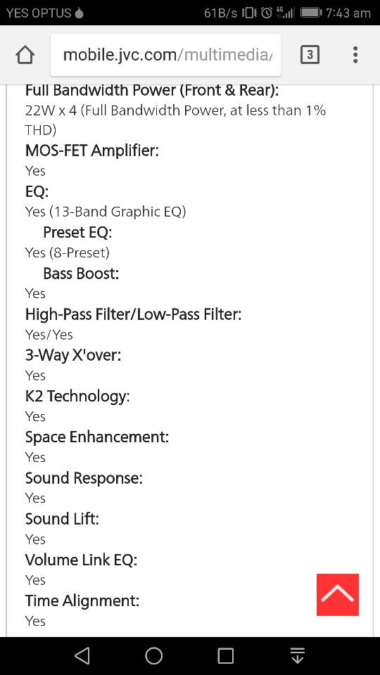

I'm actually surprised to see another brand of head unit offering active network mode other than pioneer aka the jvc ones. Kenwood doesnt have it but jvc does.. thats wierd.[/QUOTE]Specs for that jvc
