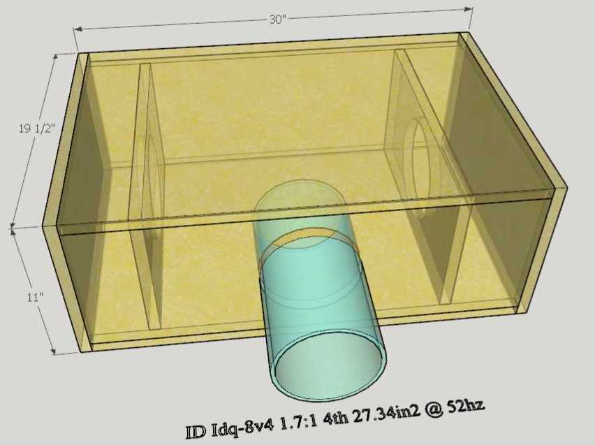

7-800w? On that lower power I think a nice set of Idq-8's in a 4th would do great.
Would something like this fit in that Q50?
It went into a Lexus iirc and did very well on a 1K amp.
