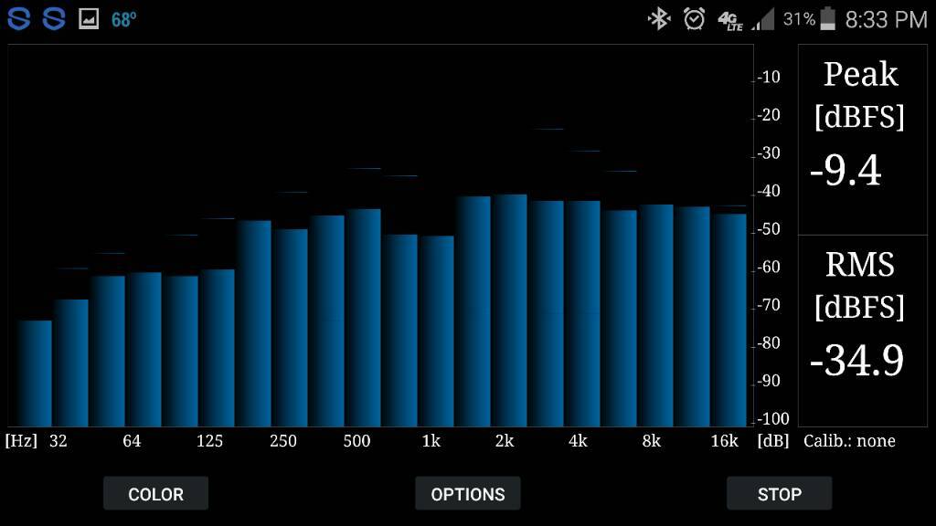

Well downloaded a rta analyzer on my phone don't really know how accurate it is ecspecially with the sub about 10ft behind me. I could use some tuning but little limited as far as the reciever goes.

Looks like my curve is going the wrong way. Lol

In regards to the RTA, your phone is inaccurate below 200Hz due to the wind filter.

Figured it wasn't all that accurate but was fun playing around with it. Though my neighborsthink I'm crazy with the pink noise going and my tinfoil hat on.

Pretty much. If you could just flip it around it would be a good start. But if you are using the phones mic to get this reading it's not accurate.
Thanks for that. I figured it wasn't but some fun jacking with it a little. It's all a learning experience. I figured I had little more low end.
