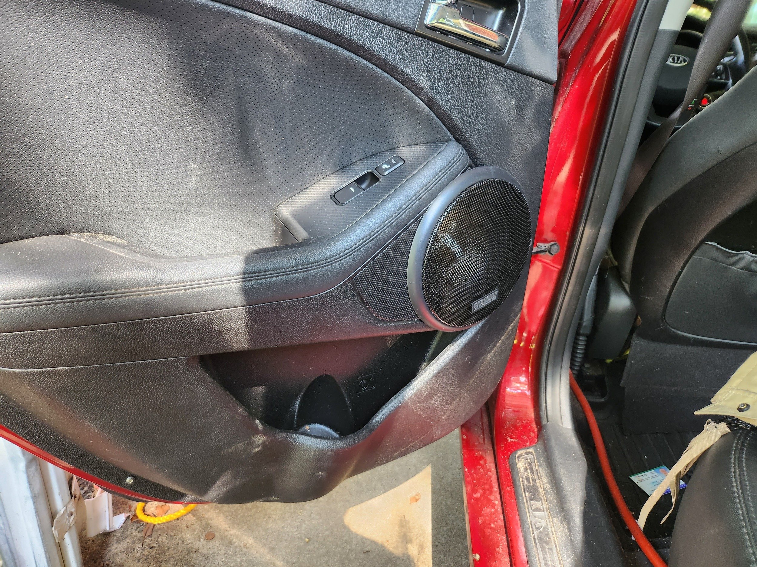

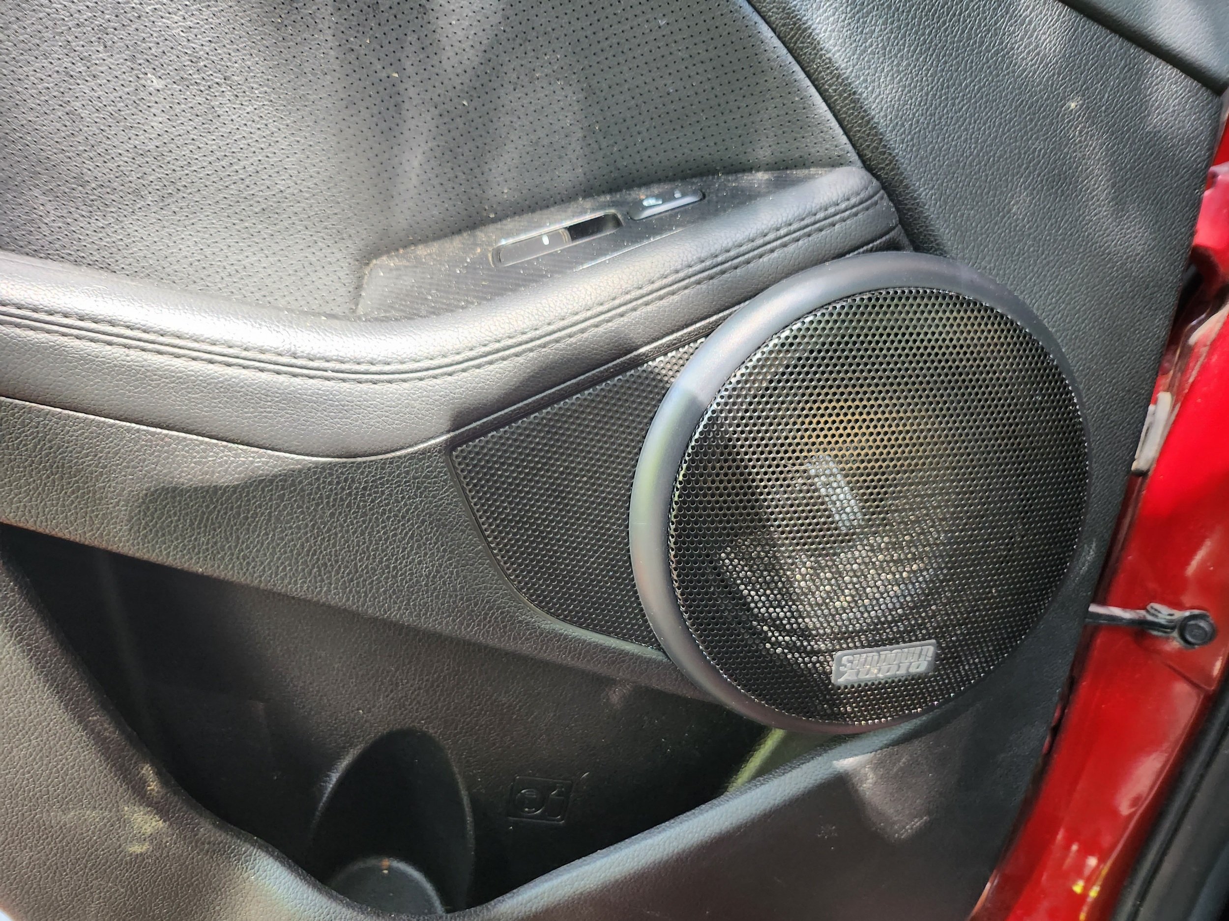

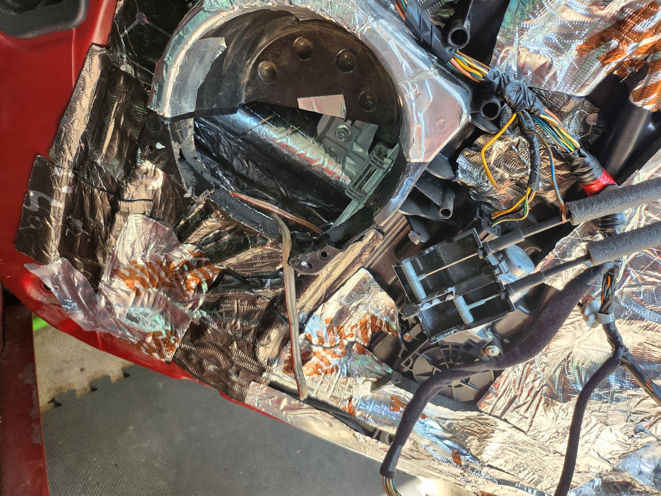

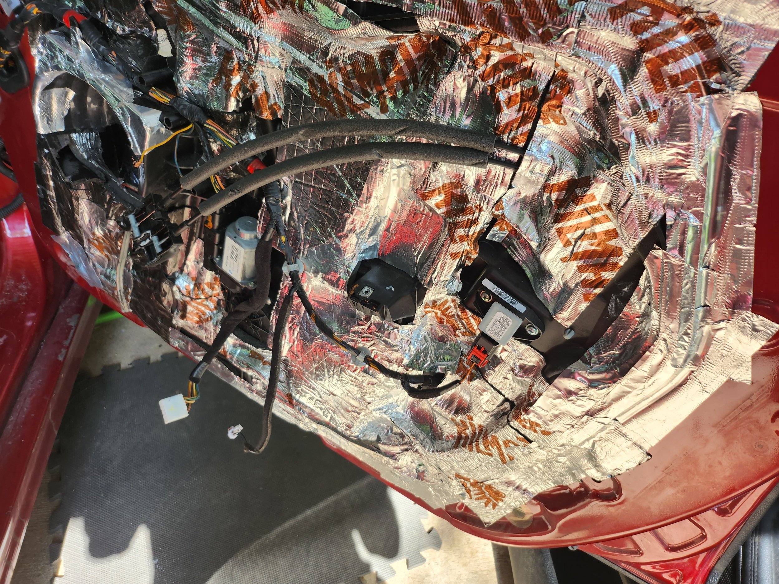

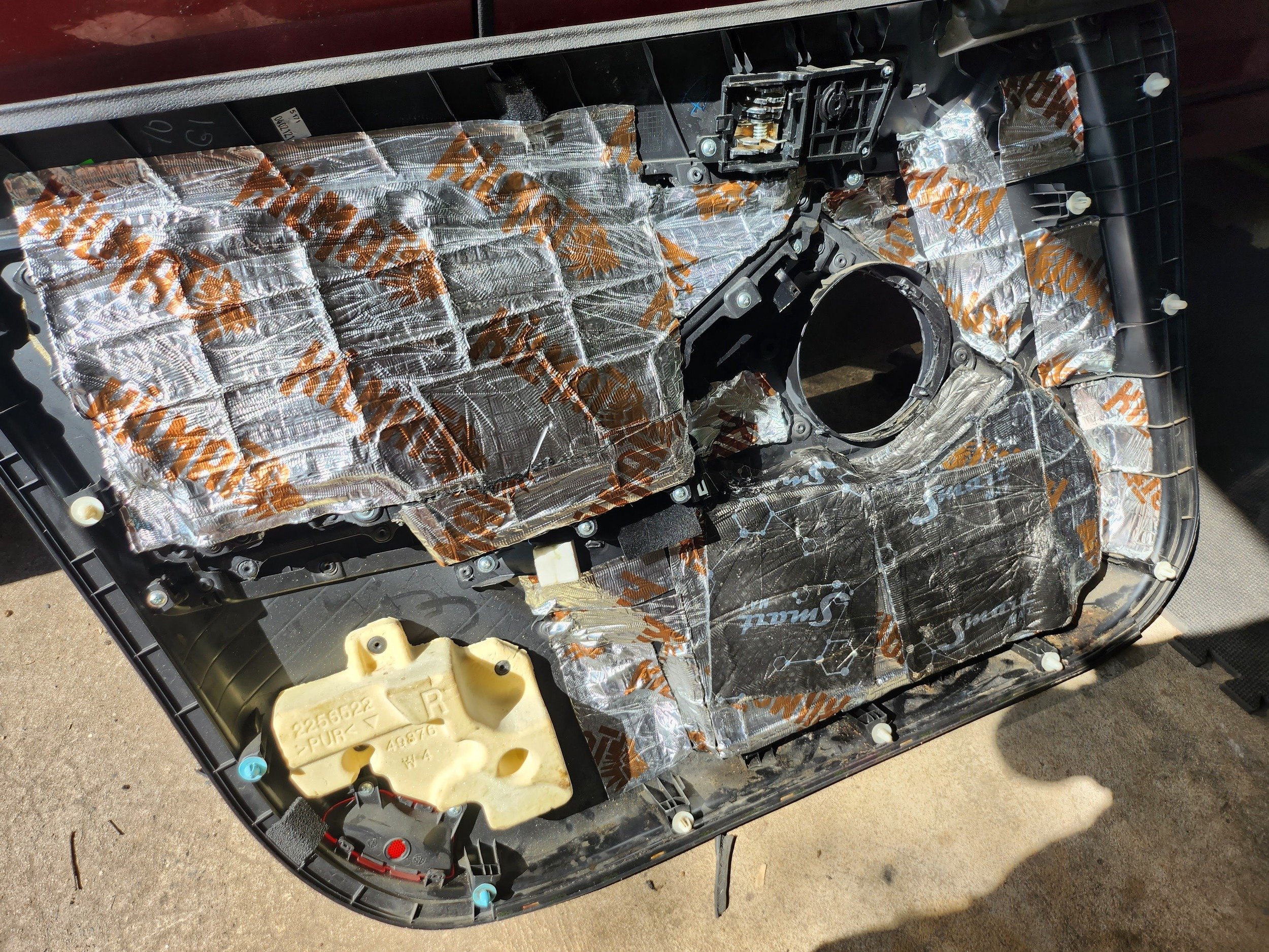

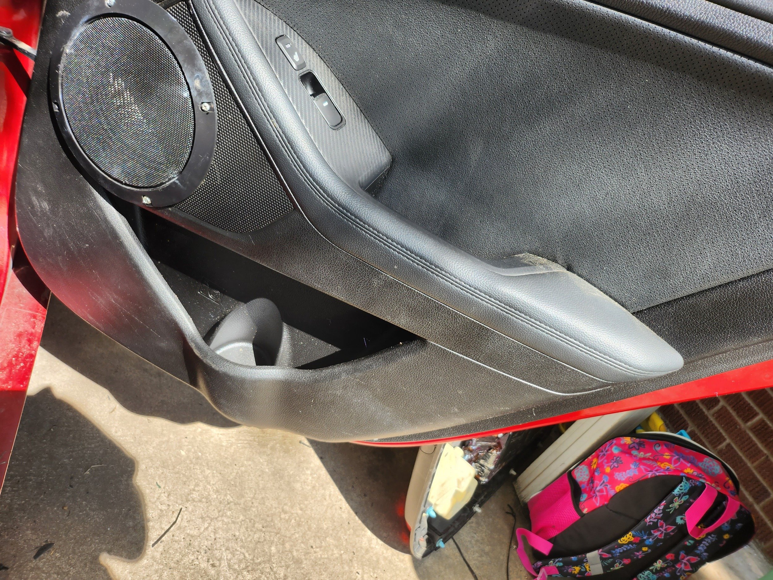

Would like opinions on my set-up. Running a sundown audio salt 400.2 pushing 4 sundown audio neo pro 6.5 an 2 bassrockers marine 6.5's. Sundown sia 3500 to a massive Audio hippo xl 122 sub.i have a phd art 2150 an another salt 400.2. A sfb 1000.4, ds18 exl sq 1000.4 and a 600.2. Needing advice on what I should use for best sq.i also have 2 dc audio 6.5 subs,a nvx xad 21. Other equipment that I have ct sounds meso 6.5,massive Audio m6r, LORD OF BASS 6.5 THAT ARE 5.4 OHMS,AN DS18 SQ SET,WITH 2 TWEETS,2 MID WOOFERS,2 COAXIAL SPEAKERS. INSTALLING IN A 2012 KIA OPTIMA SX. I HAVE 72 SQ.FT OF SOUN DAMPENING PLUS QUATER INCH ALUMINUM BACK FOAM IN IT.THE INNERSIDE OF OUTER PANELS, BOTH SIDES OF MIDDLE PANELS AND INSIDE OF DOOR PANELS ARE ALL COVERED WITH SOUNDPROOFING. RUN NEW 14 GAUGE OFC WIRE TO THE DOORS, 2 RUNS PER DOOR,, INPUT AND RECOMMENDATIONS ARE MOST WELCOME AND WANTED. CAUSE I CAN'T DECIDE WHAT, HOW TO USE WHAT I HAVE. IM WANTING A LOUD SQ SYSTEM. I have a expert px1 dsp an a dd audio ds1 dsp. PLEASE HELP. IM NOT A NOOB, JUST BEENV20+ YRS SINCE I'VE DONE INSTALL.i made my own sub enclosure, it is a labyrinth design. Tuned to 40 hrz. Plays really low an load.I HAVE ACCUIRED A LOT OF EQUIPMENT FOR THIS PROJECT. AGAIN PLEASE HELP. THANK YOU FOR ANY ASSISTANCE. BERNEE69

My thoughts:
1. Pick a DSP to use. Choose what you are comfortable using and one that provides you the control you want.
2. SQ results from a proper tune of a proper install. You have a start, but the devil's in the details here. Deadener alone is insufficient - proper seals/gaskets are required and sound absorption in the proper locations is key. Each driver should have dedicated airspace that is not shared with any other driver and that airspace should be non-resonant.
3. None of the speakers you've listed is what I would classify as "SQ" but that doesn't mean you can't be happy with it. The PA style mids will sound like a PA mid regardless of what DSP you have. But if you want to be loud, it's the way it usually is. I would run B&C for a "SQL" build.
4. Once you've chosen the DSP you then have limitations based on the number of output channels. Ideally, each driver is on a dedicated amp channel and each amp channel has a dedicated DSP output. That gets difficult with multiple drivers unless you have a really flexible DSP (i.e. JL Audio VXi amplifiers can do 40 discrete channels of DSP from a single hub if you do five 8ch).
5. The amplifier selections are usually impacted by physical space limitations, but if that isn't the case, you can match amplifier to speaker with higher power amps to midbass and smaller amps to mids/highs.
