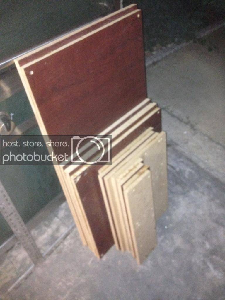

Got all the wood best thing about my job is i get free mdf because they use it to protect the sheets of other wood in the palet.
Getting all the pieces cut. thank god that i have a table saw

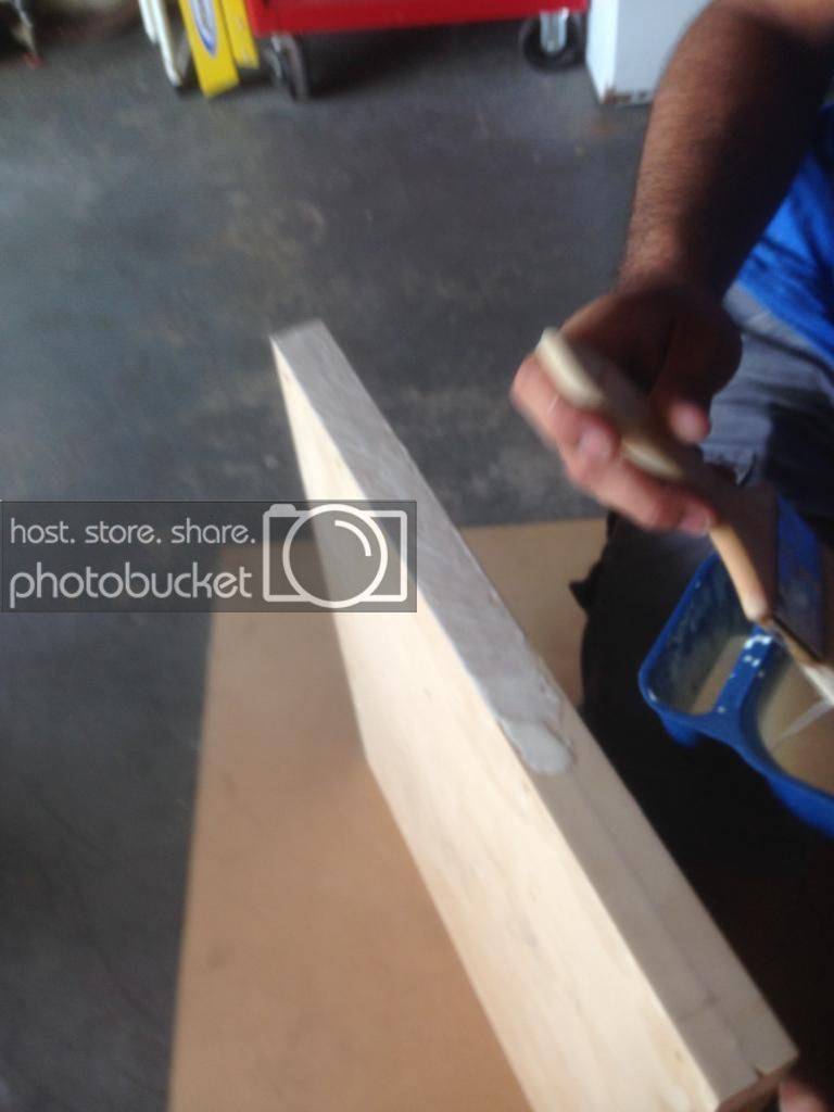

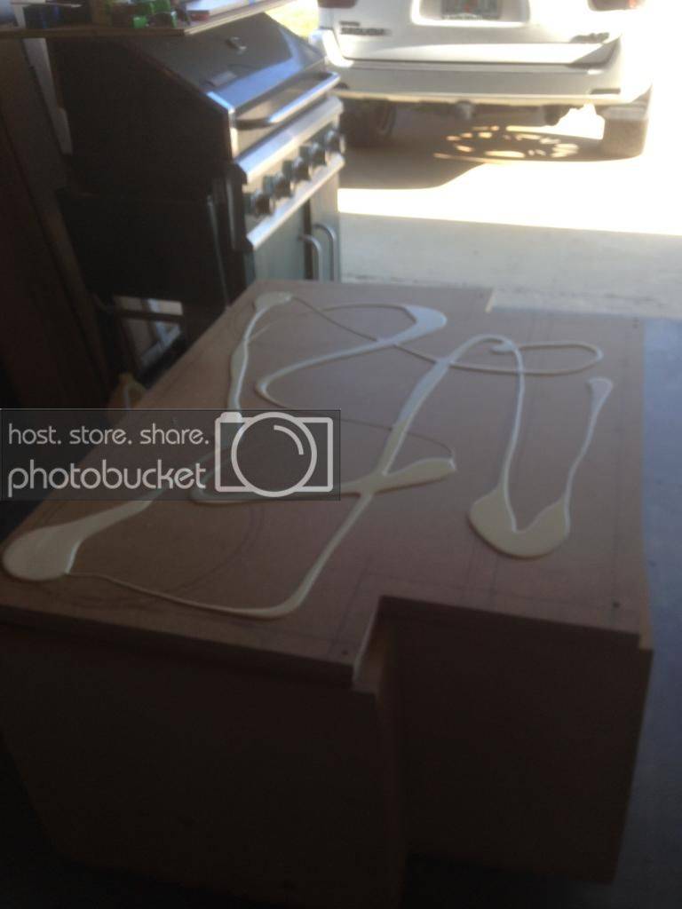

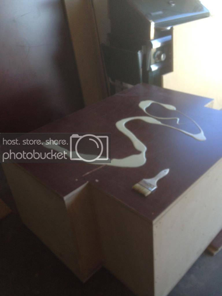

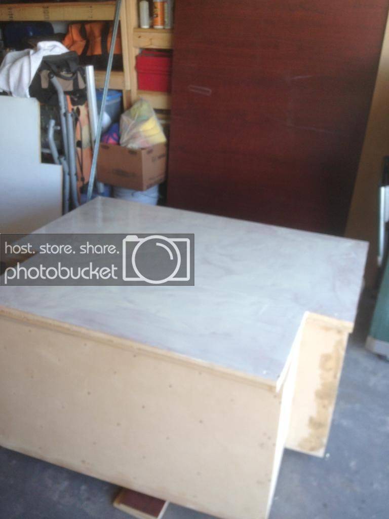

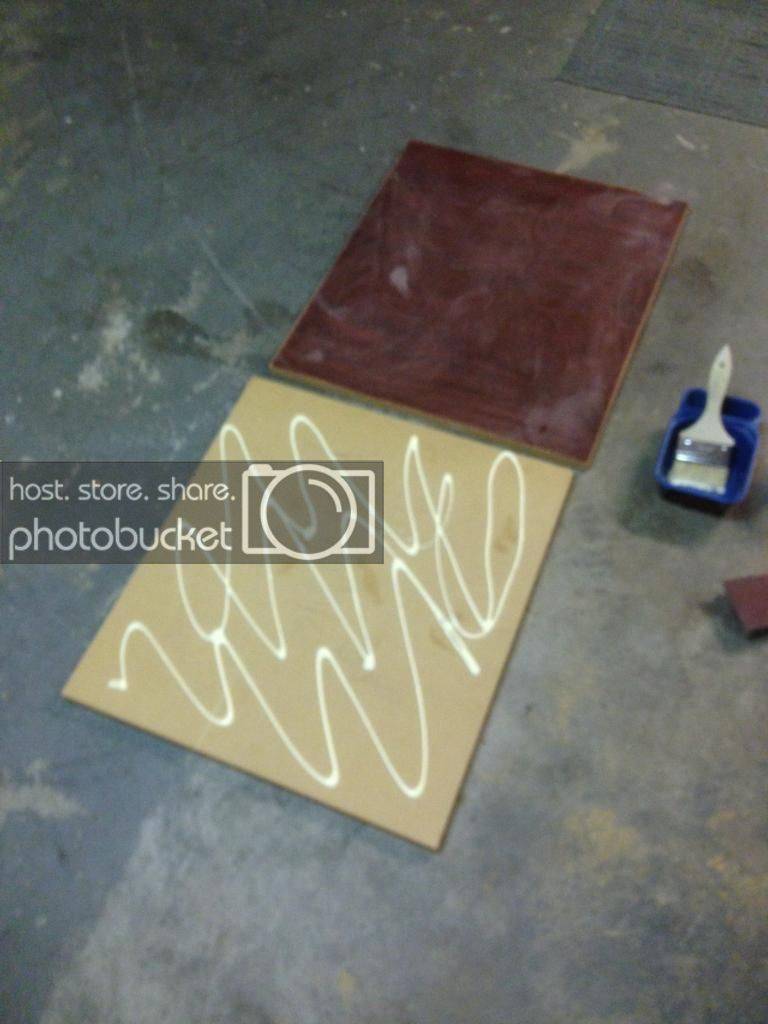

Glue glue glue. For the longest time a use to just squirt glue on and hope the pressure would spread it evenly. Seen someone on here spreading it around evenly and thought it was a great idea. Although this was you end up using a ton of glue thats okay becuase you cant ever be too strong. You may notice there is a brown coating on one side of all the mdf thats just the way we get it at woork for some reason. We scuffed if up so the glue would adhear better.
After using like 2 bottle on just the front baffle i decided that i needed some more

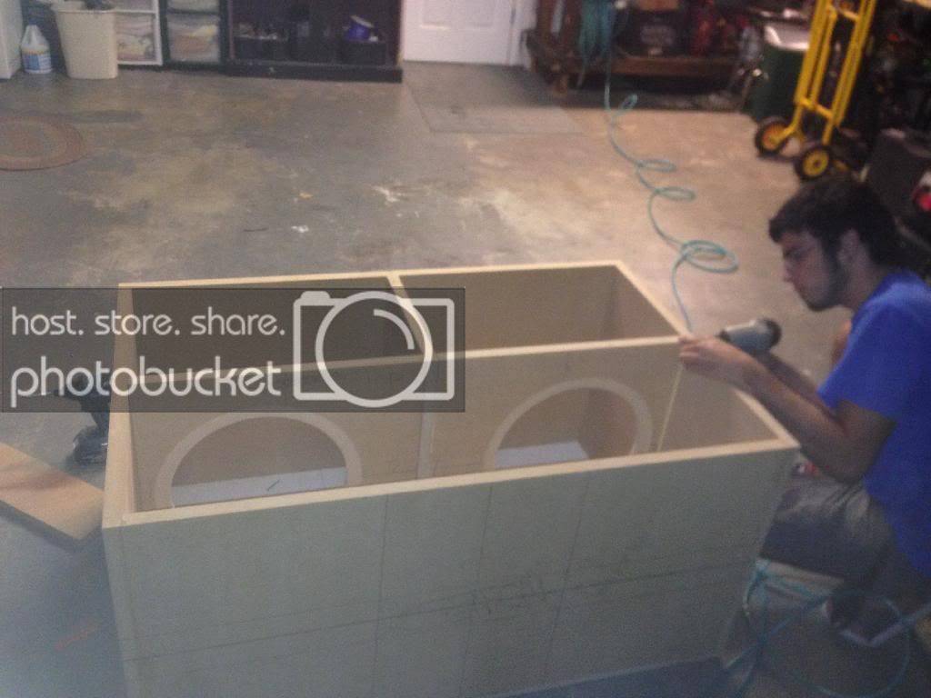

Getting the rest of the pieces glued on. i had to be careful so the seems all lined up right in the end.
okay well heres what i came of with and figures if would be the strongest bond on the corners and give more surface area of the glue to bond.
mocking it up to make sure everything fits. holy hell this thing is going to be heavy
more glue glue glue glue. every seam covered in glue.

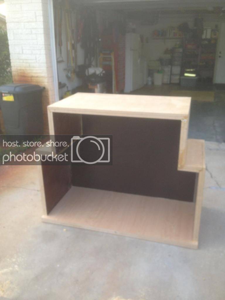

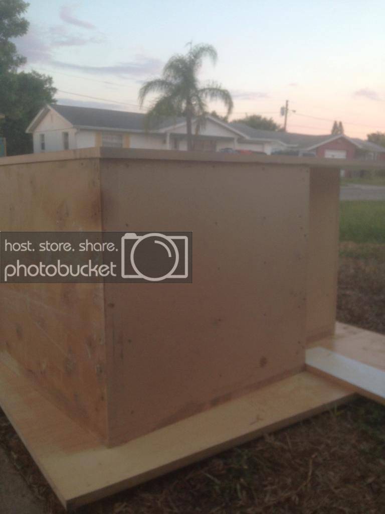

got all the sides glued and screwed together. and the front baffle screw on thing this is huge

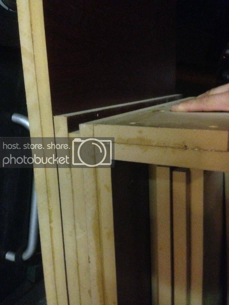

heres a better picture of the way the seams fit togther. very strong.

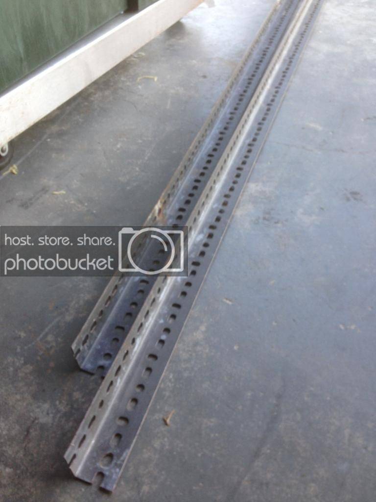

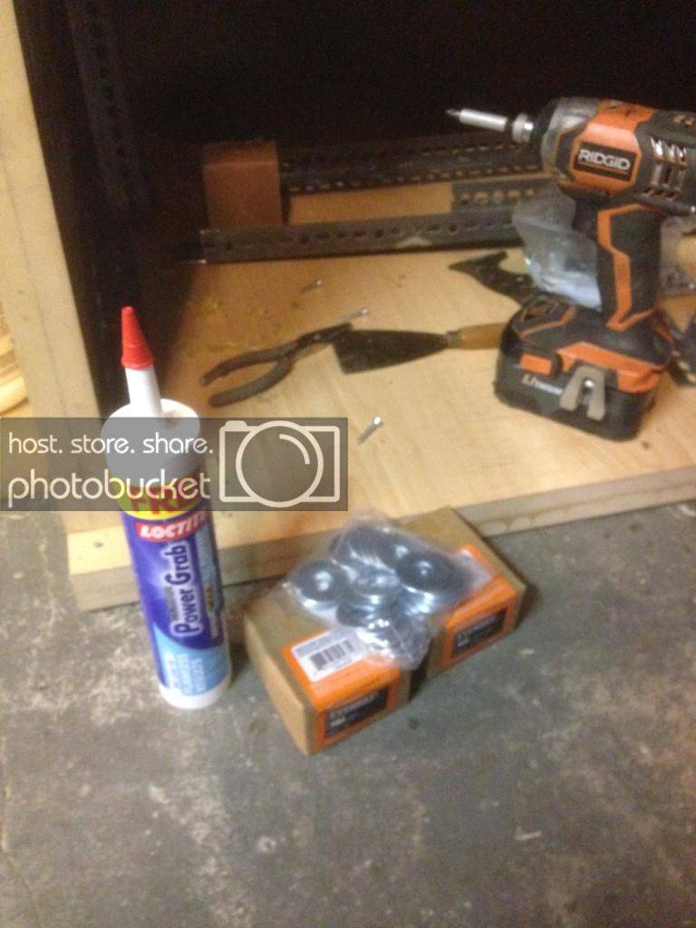

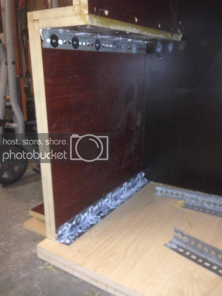

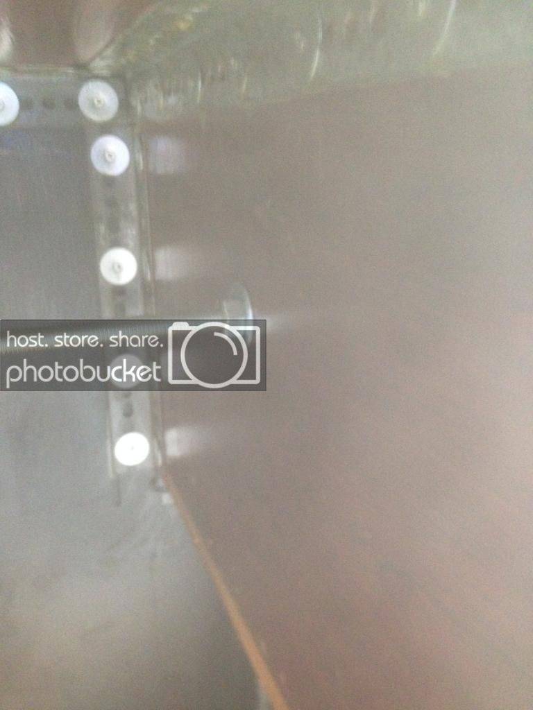

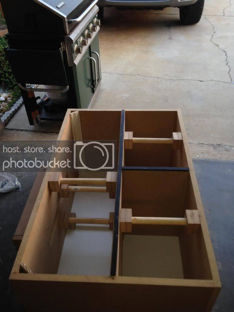

And as you all know a box can never be built too strong. I dont wanna have to go in a redo anthing on this box so im gonna build it as strong as i possibly can. i had some angle iron sitting around in the garadge
found some big flat washers at home depot i figured would be great and use 1 1/4" screws to fasten in. I also used some locktite behind in just incase. Over buliding is the key.

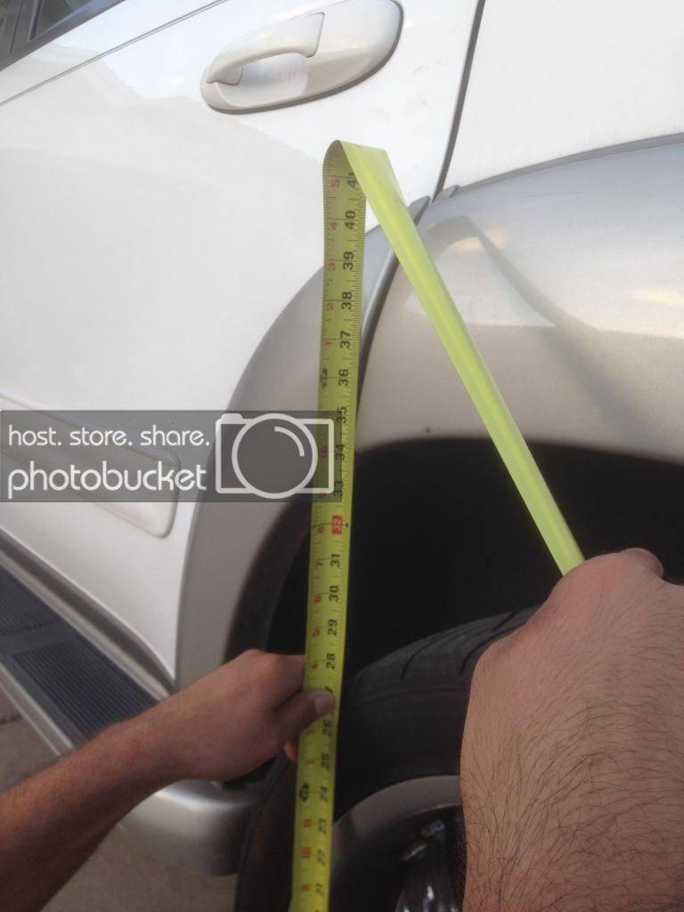

one more little thing a side bet between me and my buddy after thinking about just how heavy this box will be. he doesnt think that it will lower the back at all, im thinking with the weight of this thing so far it will for sure lower the back. what kind of drop have some of you had from big builds?

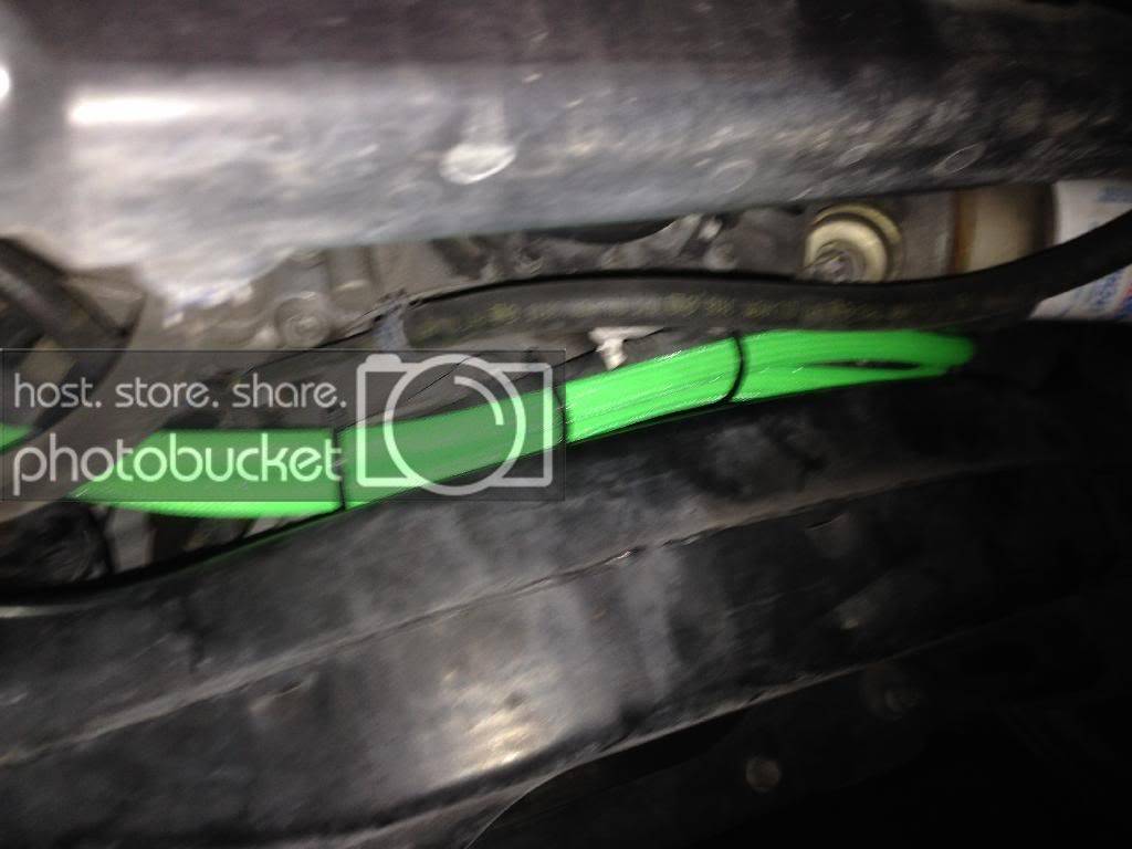

okay well didnt get anything done on the box today so i guess ill share some other things i have done to the truck. did the big three.
NOTE: its a little messy and i could have done a better job with the wire managment but it was the first time that i have ever done it and i didnt realize that planning ahead would be so important to keep the wiring clean and neat. Going to be redoing the whol thing with 2/0 wleding cable

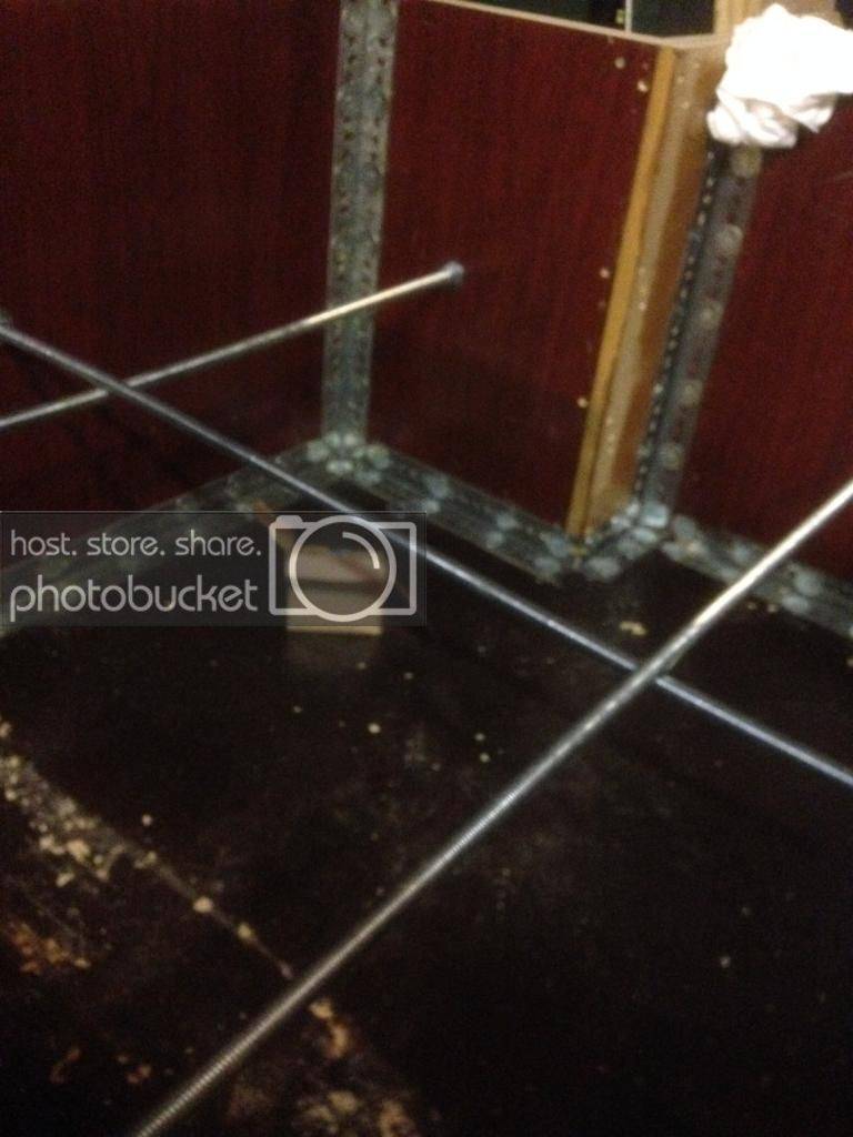

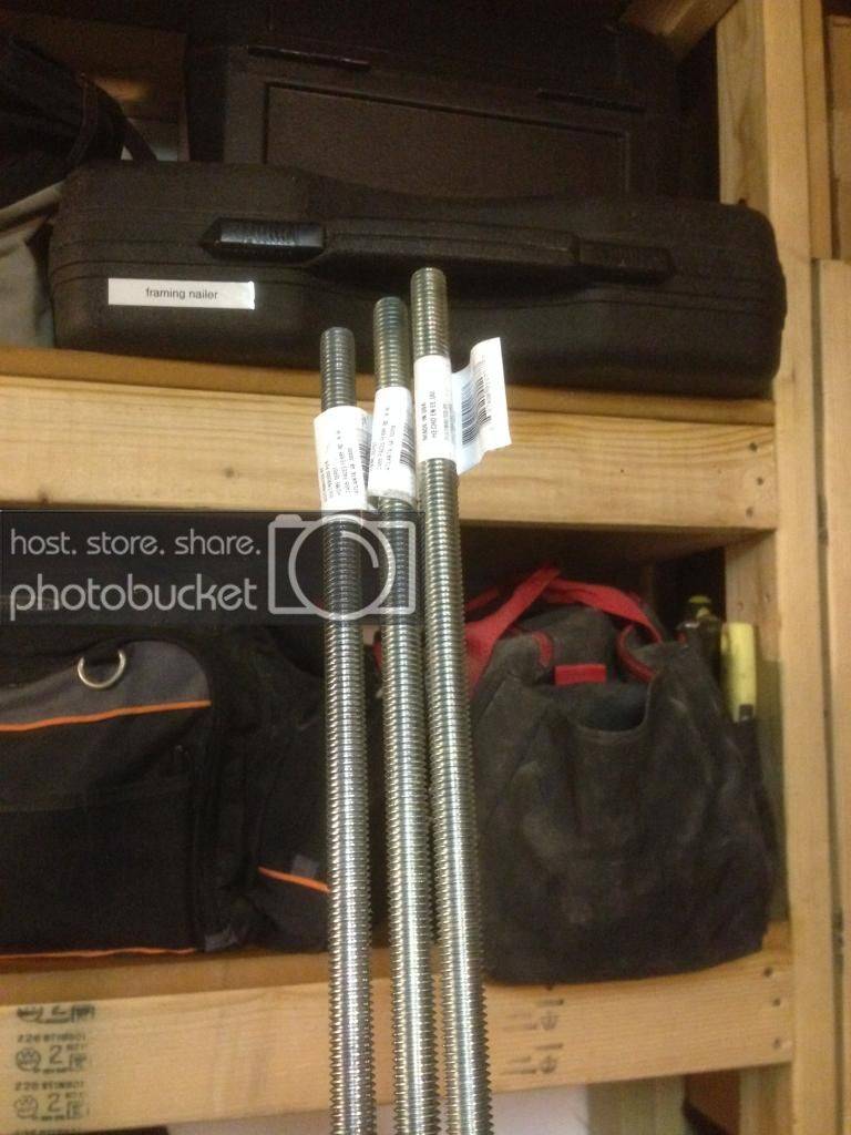

Okay so work has me busy as hell so I won't be getting a ton done during the week so weekends it will try to get the most done I can. Worked on more of the bracing and took and trip to the Home Depot. Decided to stop being cheap and go with threaded rod over dowels. Added the angle iron to every inside corner in the box that I could. Debating weather I should add it to the inside corners as well.

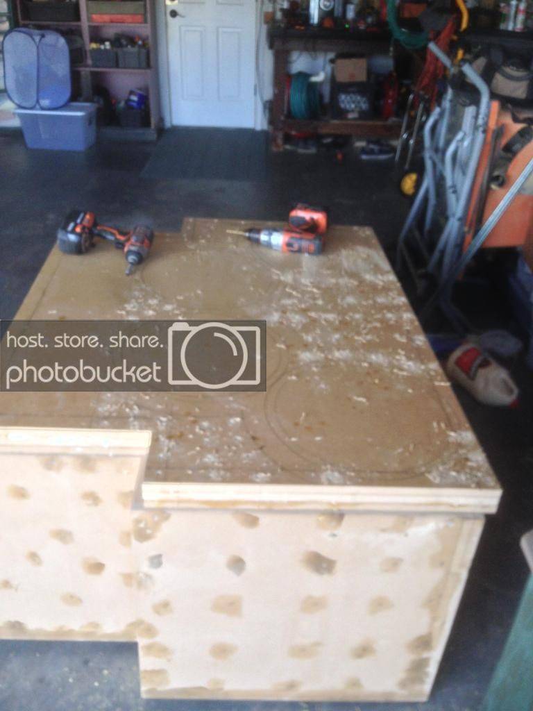

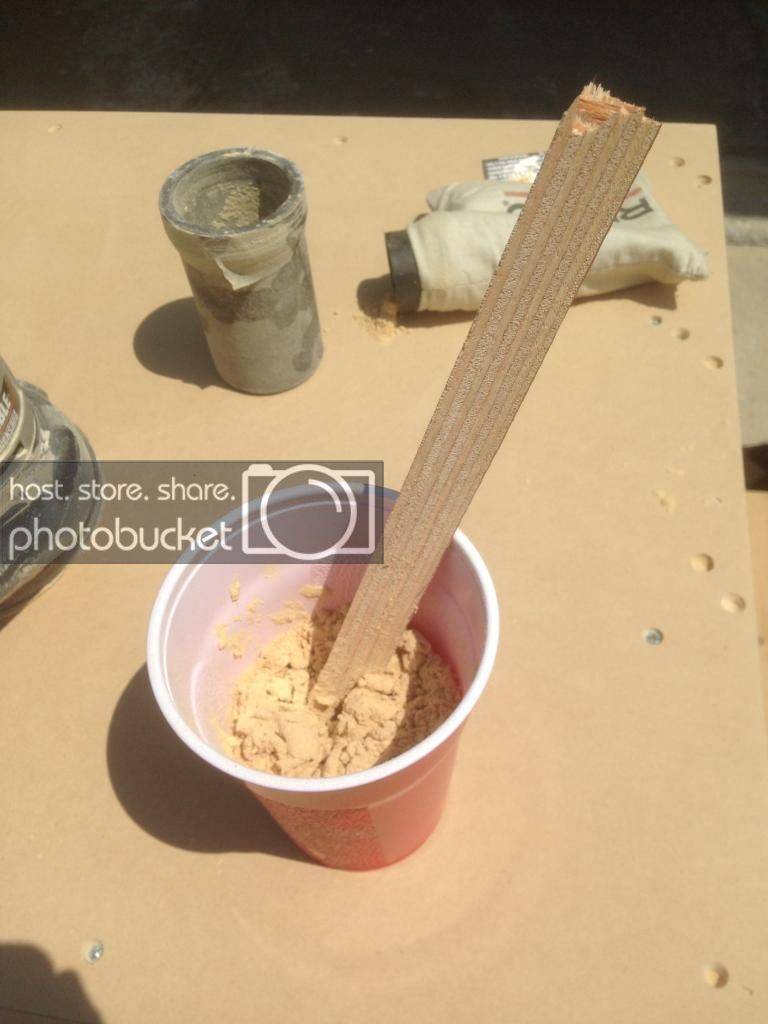

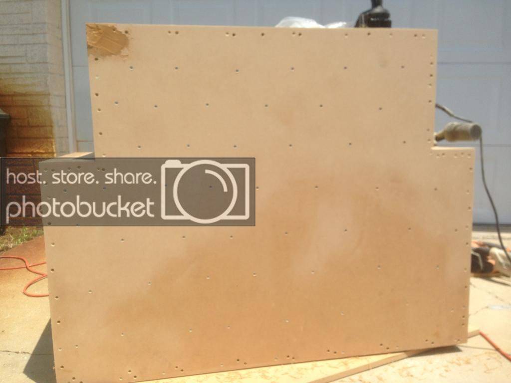

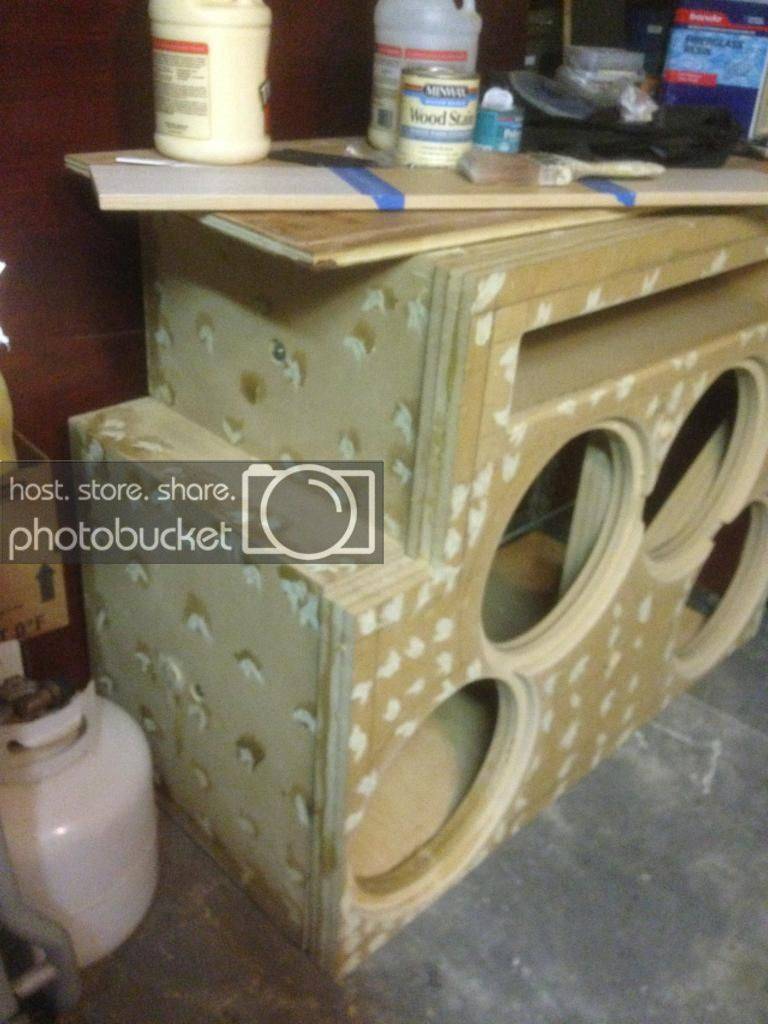

another update if anyone cares. Hopefully i will have 3 of the 4 subs at my door tomorrow and the other one should come in the next week. sanded the box and filled the screw holes. main reason im filling the screw holes is just in case any of them get loose.

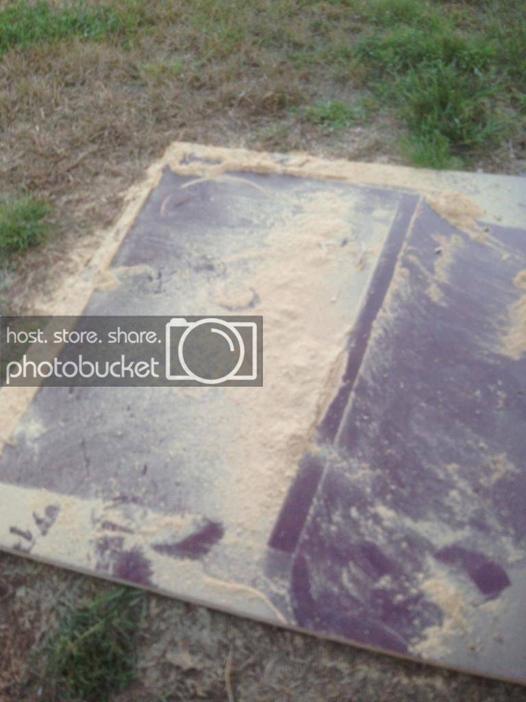

mixing up some filler. 2 parts glue to 1 art saw dust. works great if your like me and dont wanna go buy any filler.

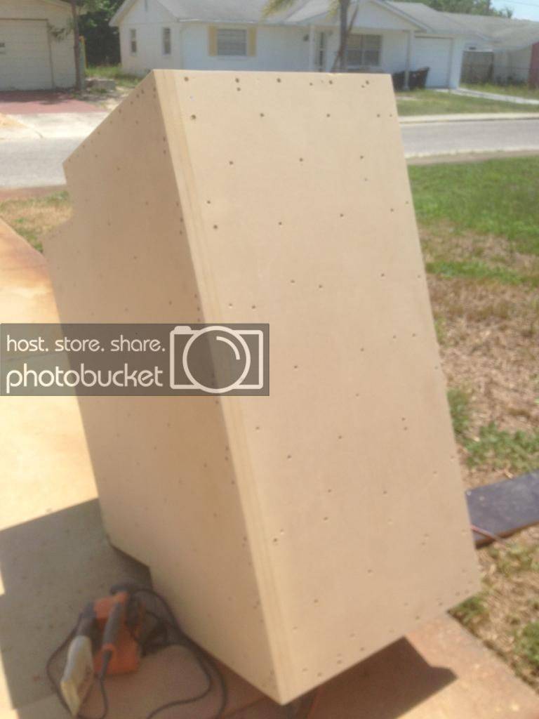

added more screws to the back of the box. After reading someones post here about when making a wall "if you have to ask yourself if its strong enough make it stronger" im going to live by these words with this box.I would have to guess there are over 400 screws in the box so far. atleast. and just like to say if you are not using a makita drill you should really give the brushless combo set a chance. By far the best drills i have ever used. I use them all day at work and they never fail or go dead.
yeah moving this thing around by myself is really not fun at all. not to mention the hellish weather in Florida. but oh well its got to be done.

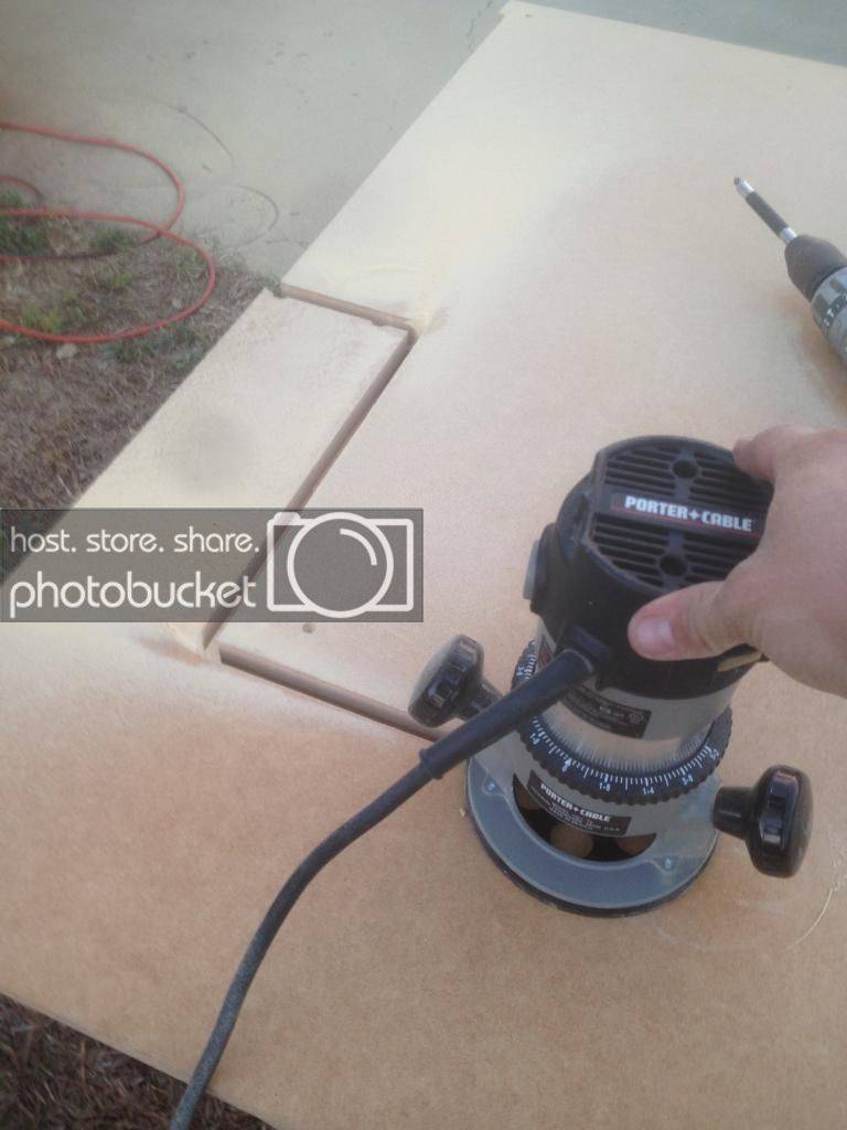

Also cut off 1 1/2" from the bottom because i wanna make my front baffle a full piece so it caps off all the sides figured it would be better to have this a full piece so when i cut the subs out i have more beef on the bottom for support.

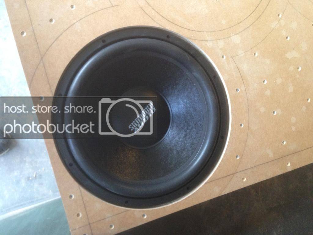

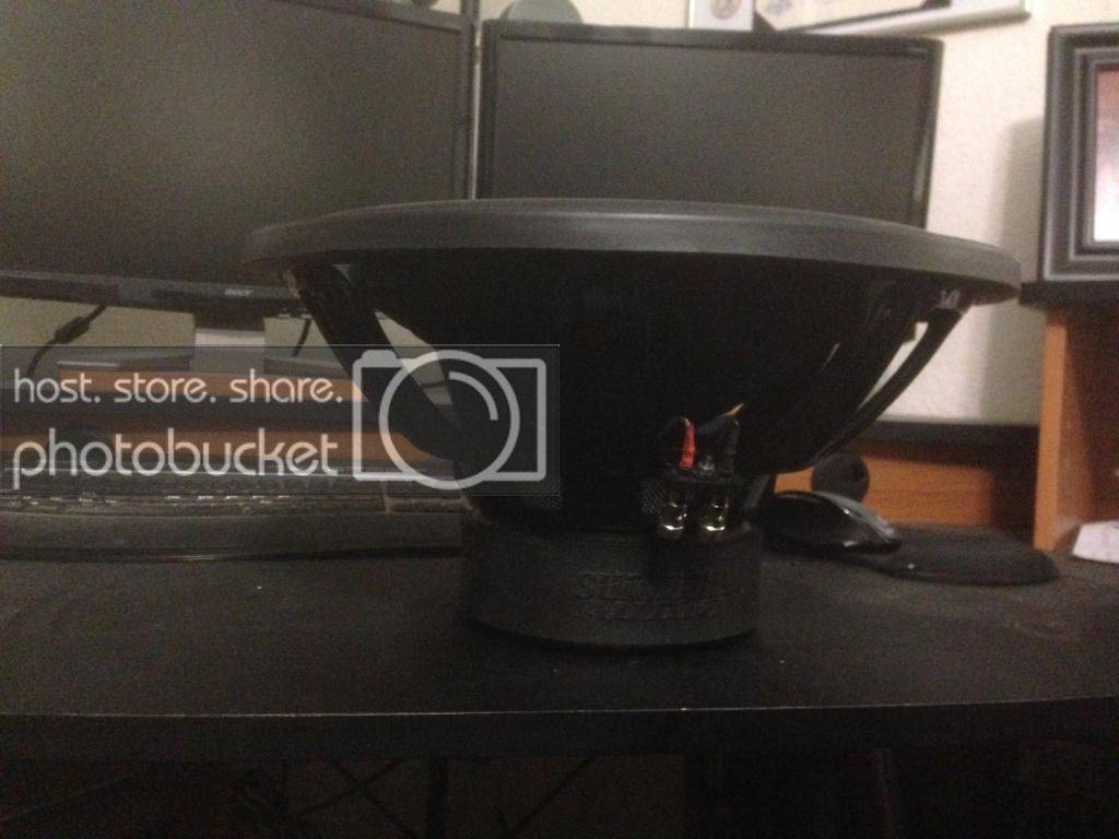

okay so i got the subs yesterday when i got home from work they were waiting for me. I have to say the pictures on the internet that i have found do no justice to these things. For "Budget" woofers they seem to be pretty well made. im defiantly a sundown fan after seem just there budget woofer.
got 3 of the 4 subs the last 4th one was back ordered they said about a week.

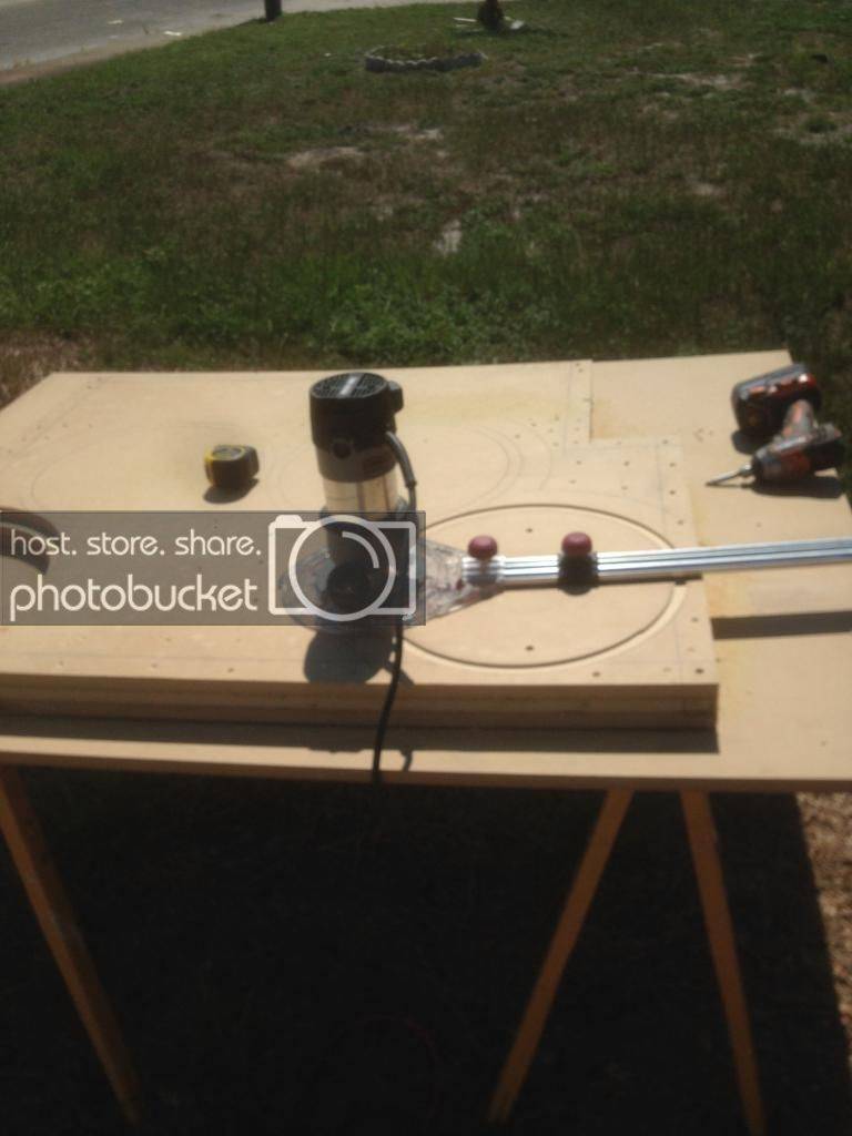

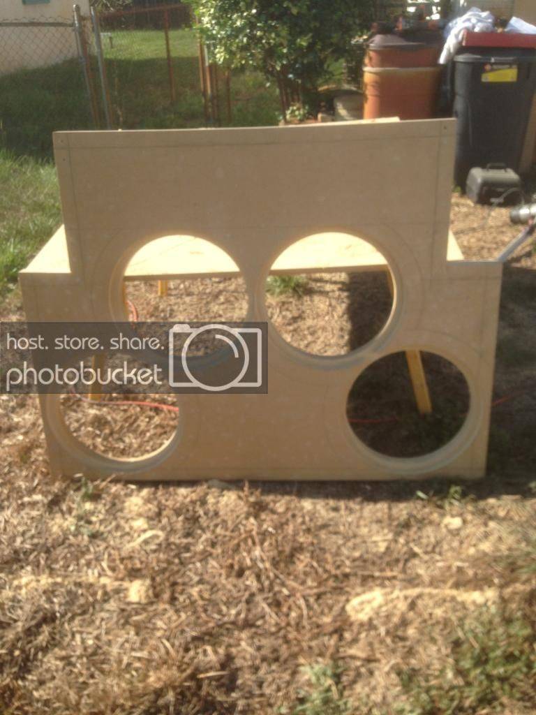

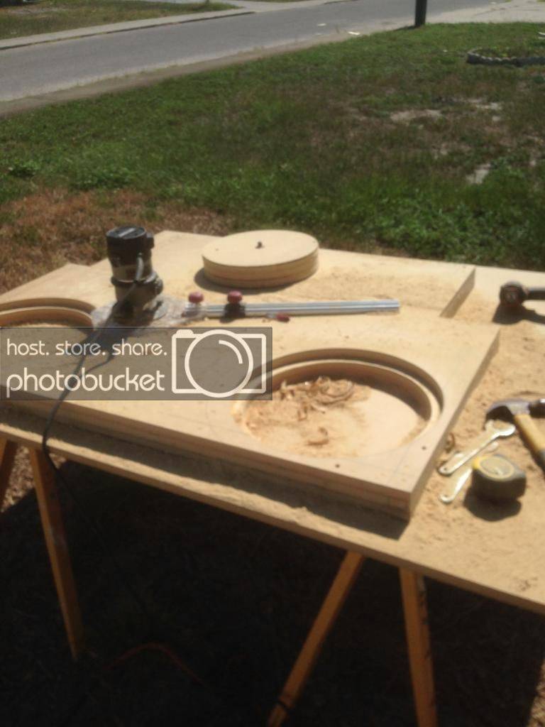

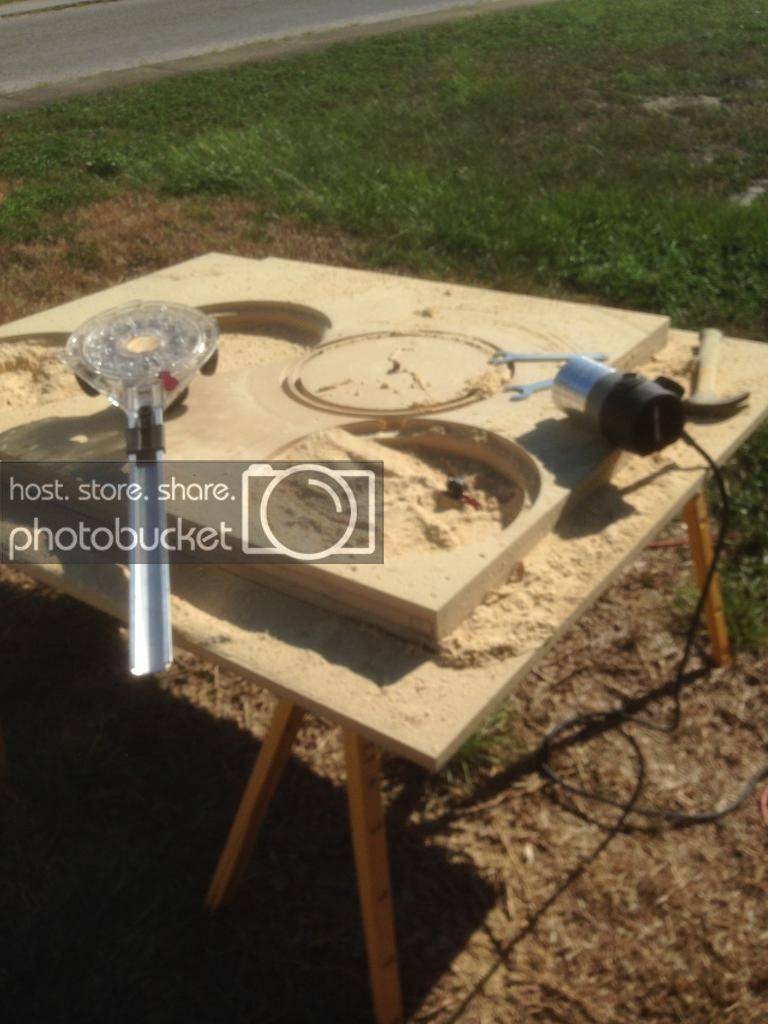

okay so i got motivated and got some work done today. got the triple baffle* glued and screwed together. and one of the speaker holes cut the box is finally starting to look like something. I really hope to get a lot done this week.
Just enough room to add the leds around the subs.
the dust from cutting just one hole.
**** i got bumped down to page three, should update more.

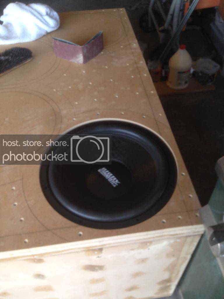

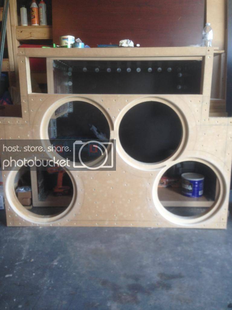

got off early again and was able to get the baffle done. Im thinnking im gonna brace it in the back with some 2x4's because the sub hole cut outs are so close.

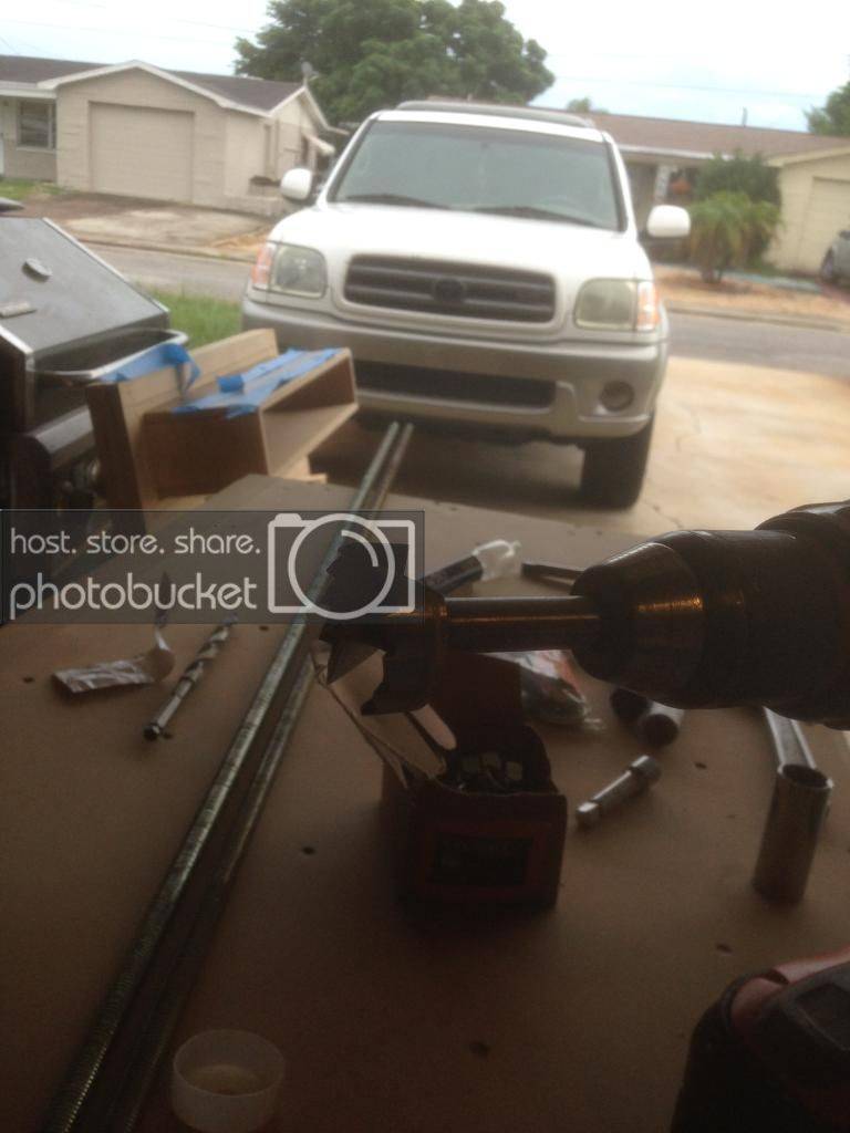

Sorry for the long wait on the update guys. I'm very busy at work and we are down a guy so I'm putting in a lot of overtime. I finally for the 4th sub. So I'm gonna try my best to get it in and playing next week. Here what I did Friday night

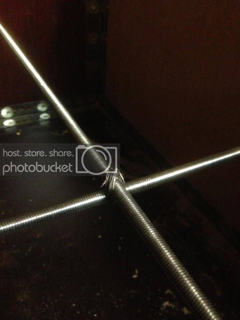

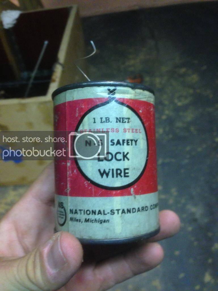

I started on the threaded rod. Used a Forsner bit to so the bolt and washer were flush. And then used a double bolt so that it would be harder for it to come loose and really cranked away untill I felt there was no way it could come loose. The thread rods that over lap are weaved through so it they hold even tighter and then I went one extra step and using saftey wire to keep them from rubbing or slapping together.
I might go pick up some fiberglass cloth and wrap it where they intersect and resin in for an even tighter bond.
And finally before I was done I filled all the screw holes as I've seen people having issues with screws coming loose from the intents vibration hopefully then will just be another extra strength thing so I can stop that from happening.
In thinking about wrapping the face in black vynal so I can show off the nice rounded edges in the baffle. That's mainly why I filled the holes on the face.

Looks like a LOT of work. Sanding all the screw holes filled with glue/sawdust has to **** balls. Next time get a cheapo can of lightweight bodyfiller. SOOOO much easier to sand.
Also for big panels I use a 6" paint roller to spread the glue, much faster.
