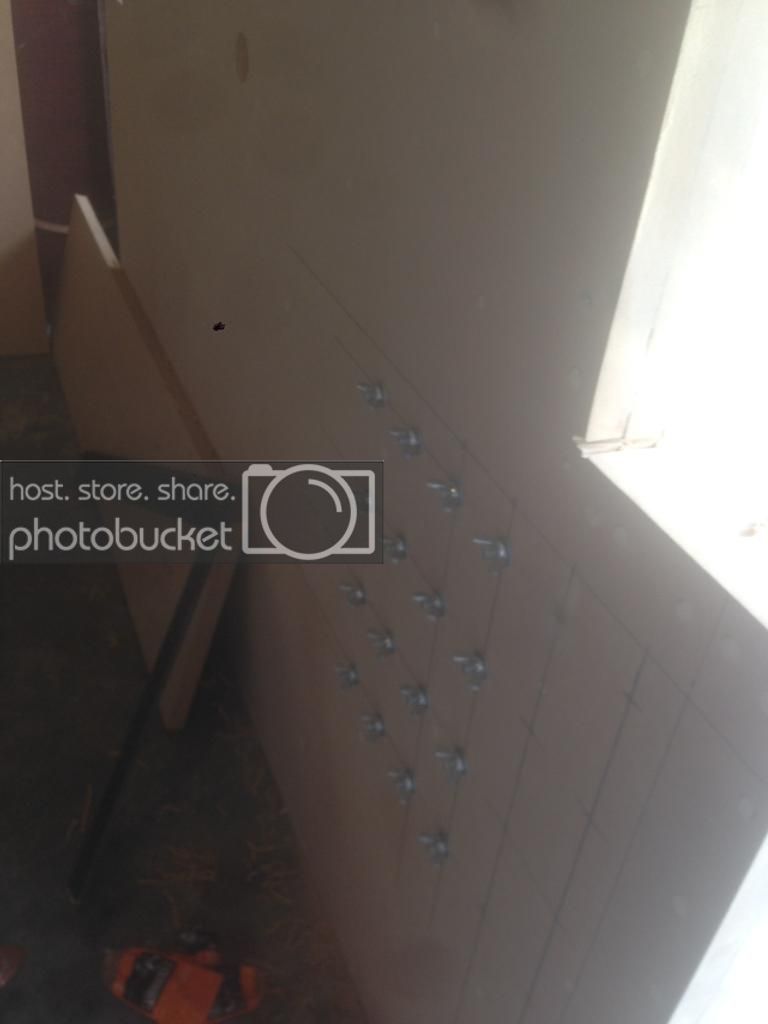

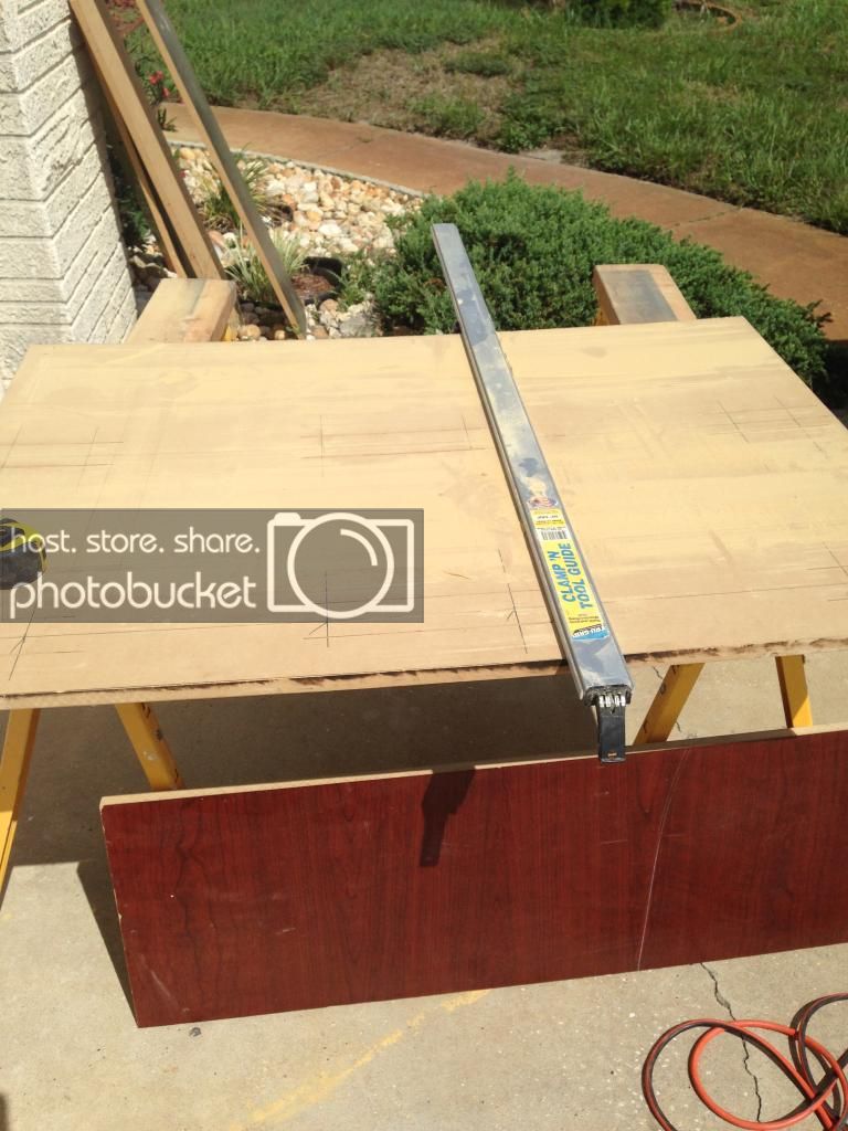

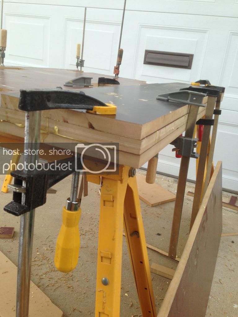

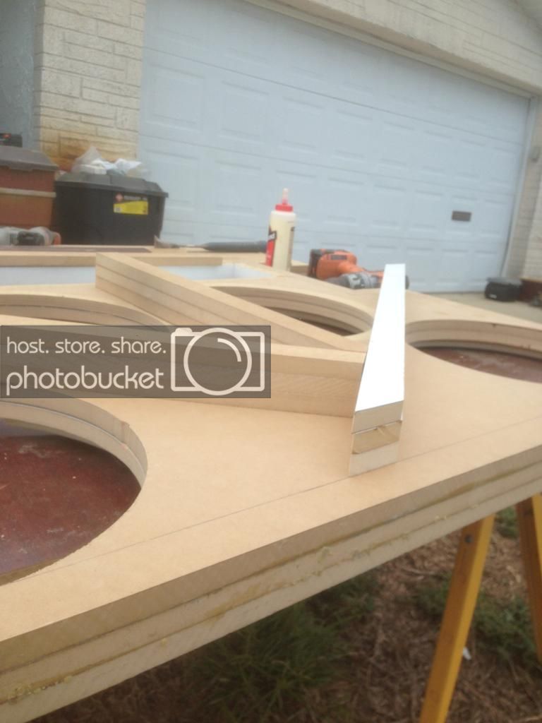

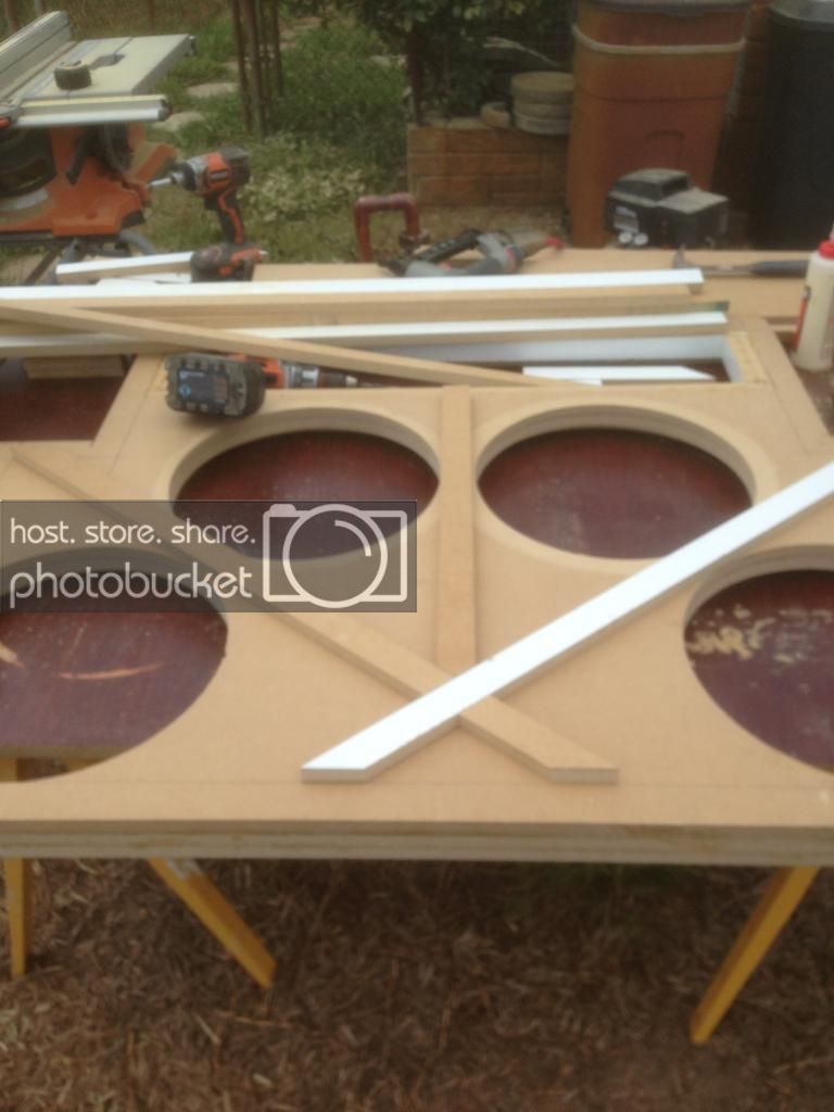

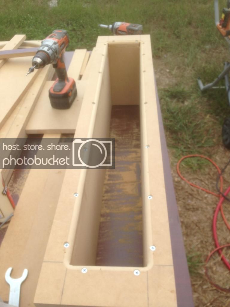

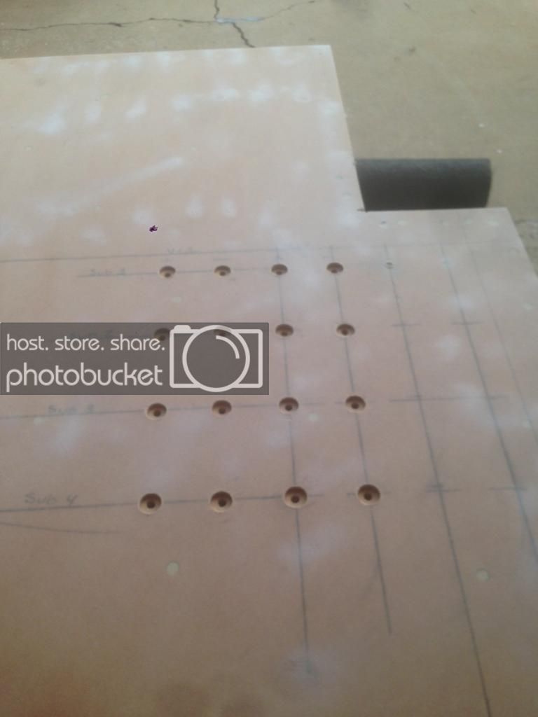

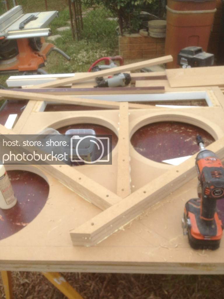

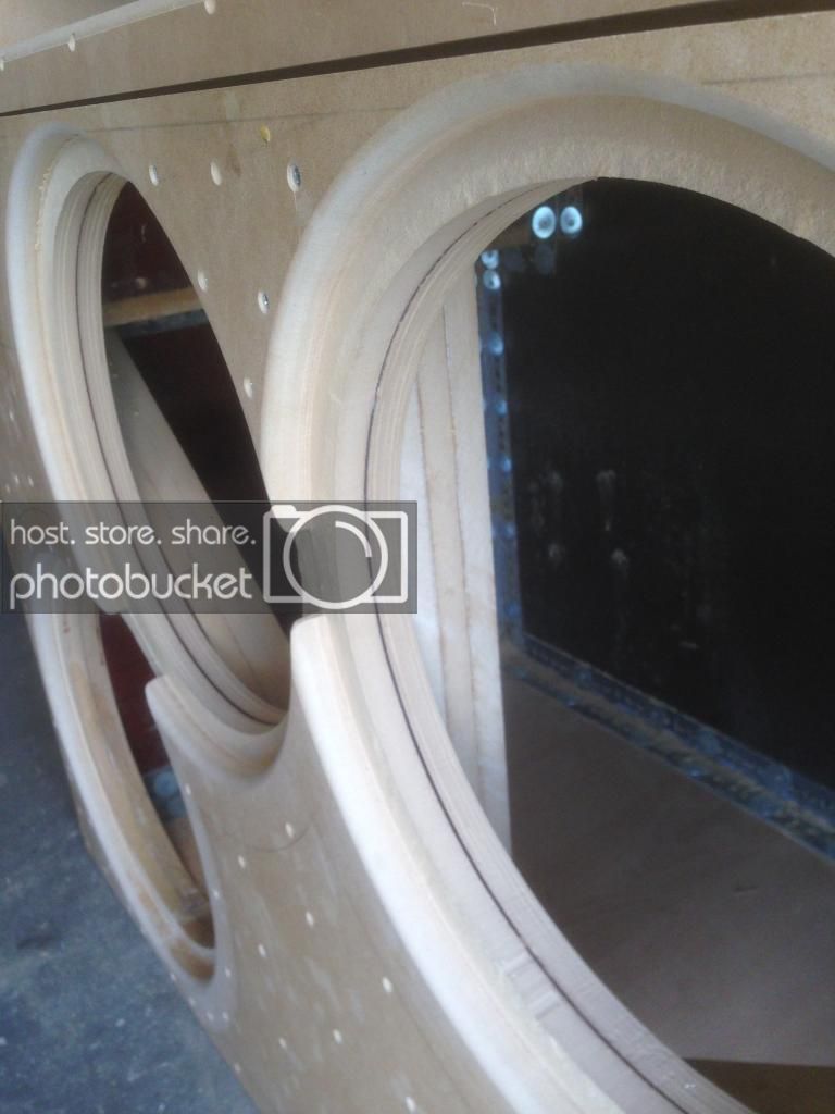

Looks like a LOT of work. Sanding all the screw holes filled with glue/sawdust has to **** balls. Next time get a cheapo can of lightweight bodyfiller. SOOOO much easier to sand.

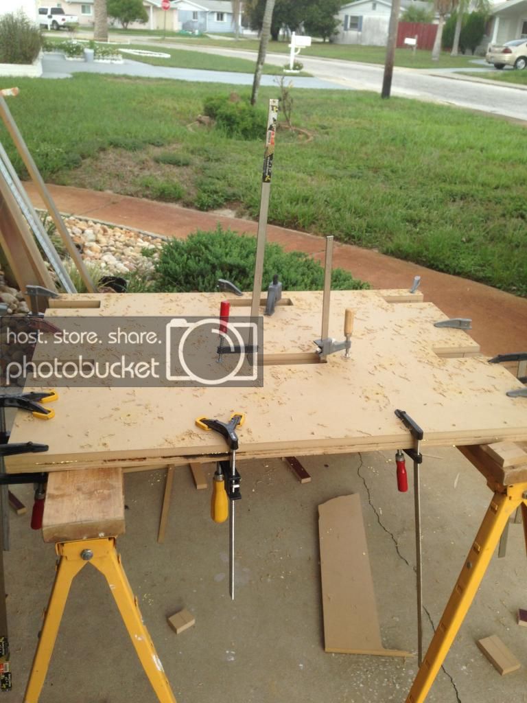

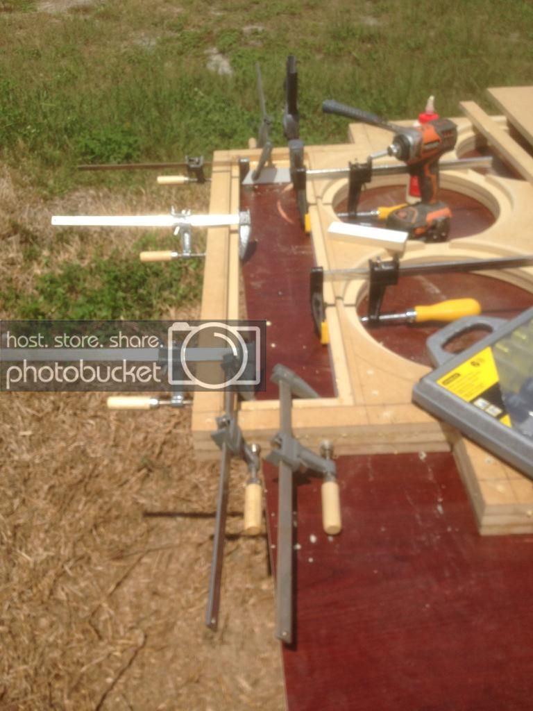

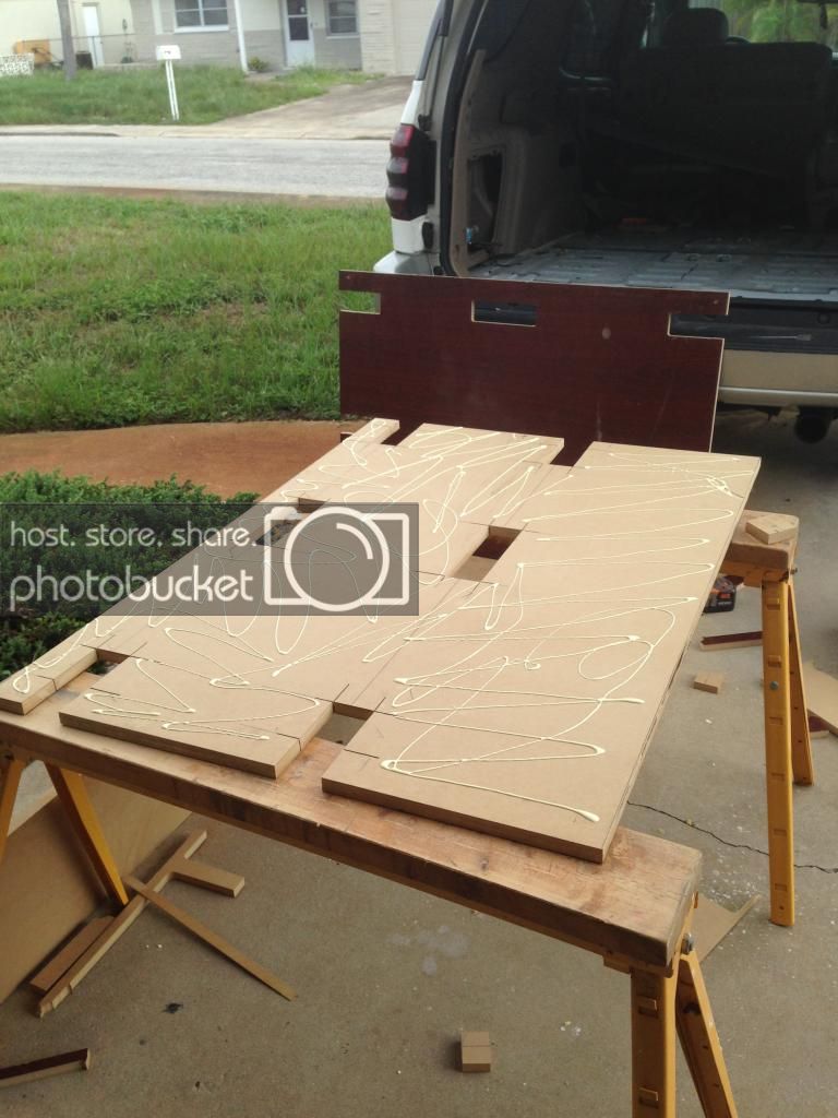

Also for big panels I use a 6" paint roller to spread the glue, much faster.
Build looks good and doing them right takes time, but worth it in the end...
Yeah if I do it again I'll do it different. Glue roller sounds like a great idea. Thanks for the tips man.

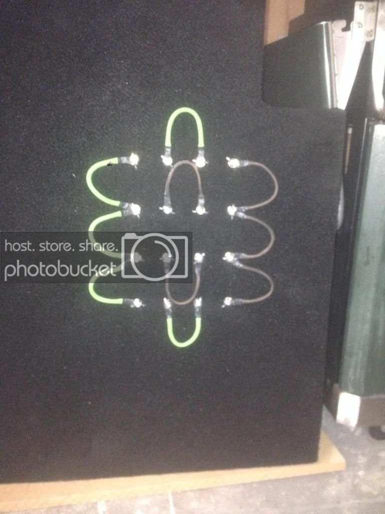

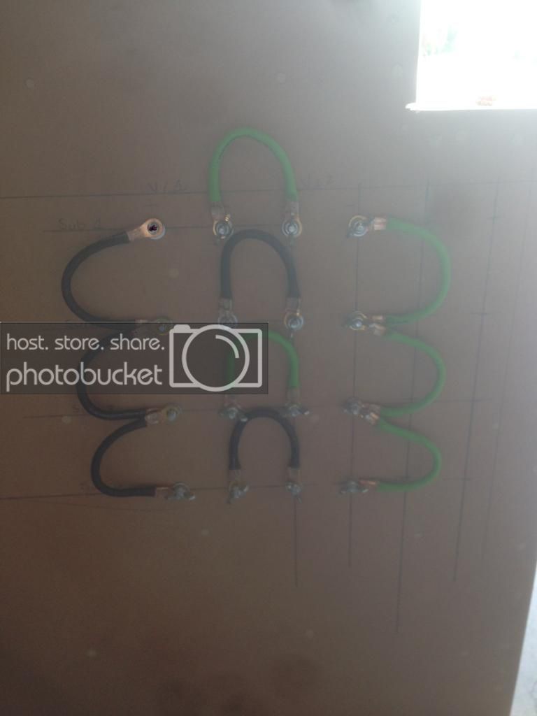

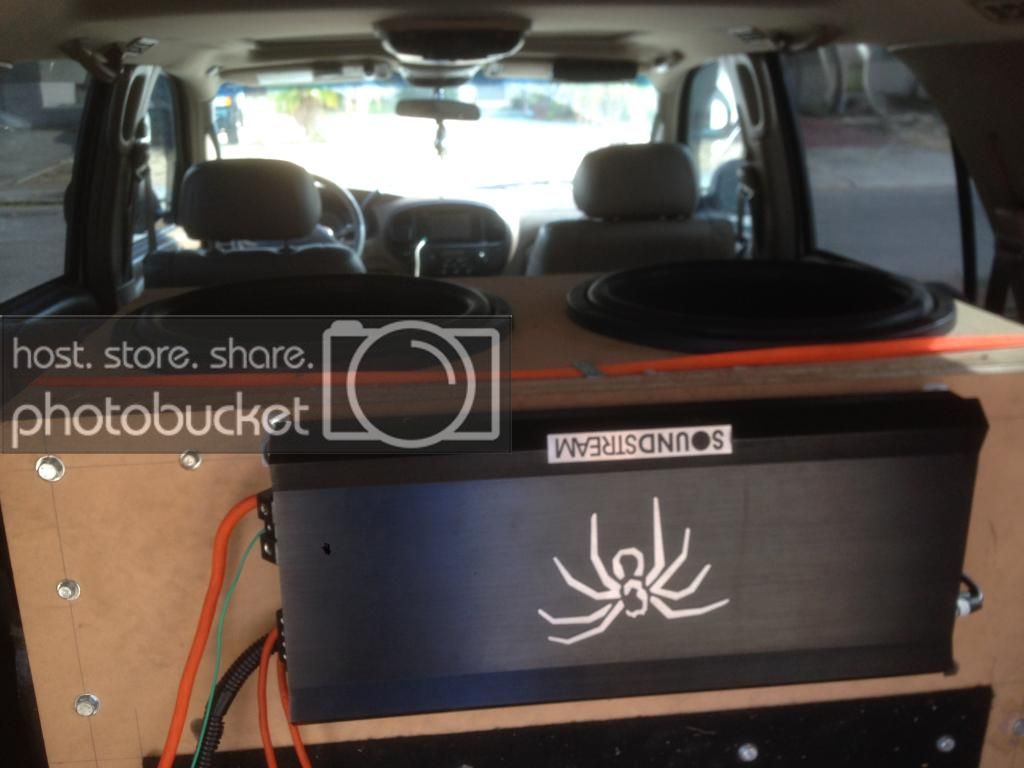

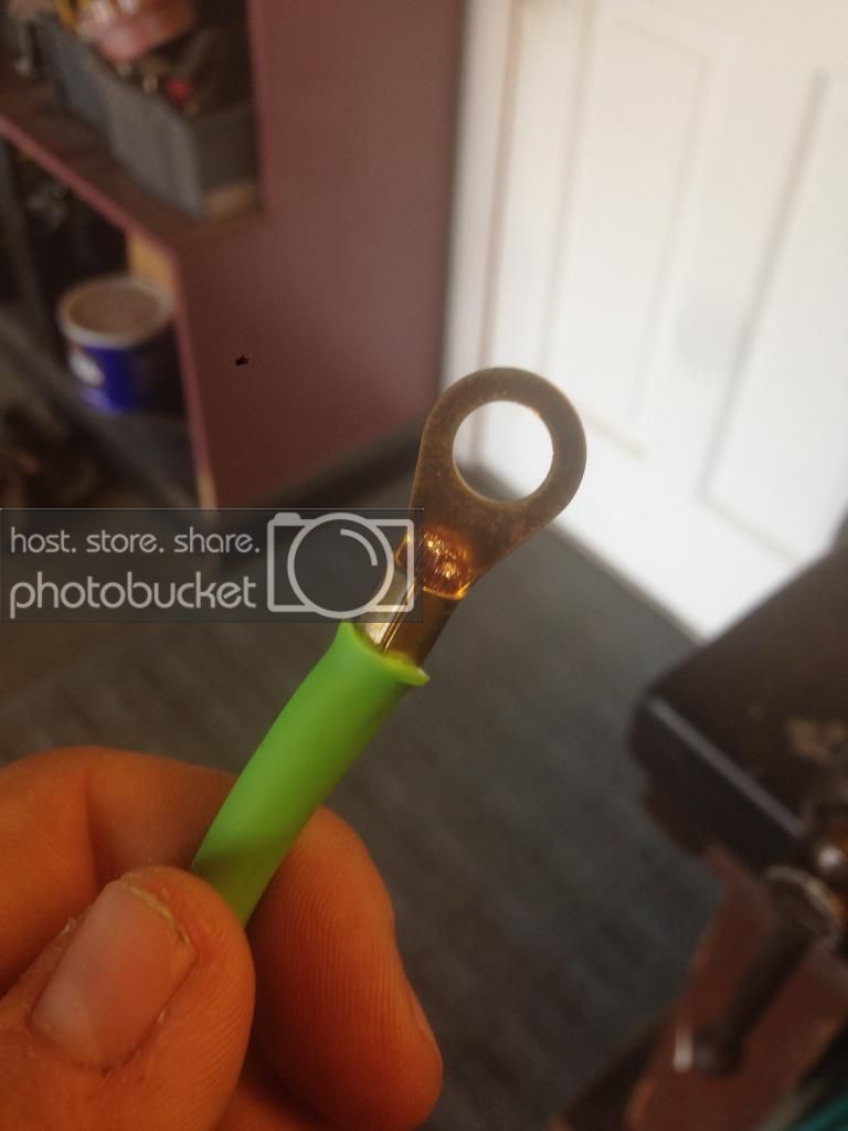

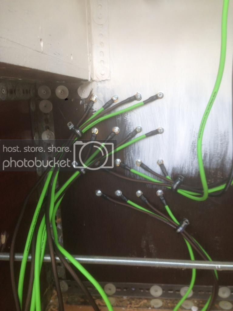

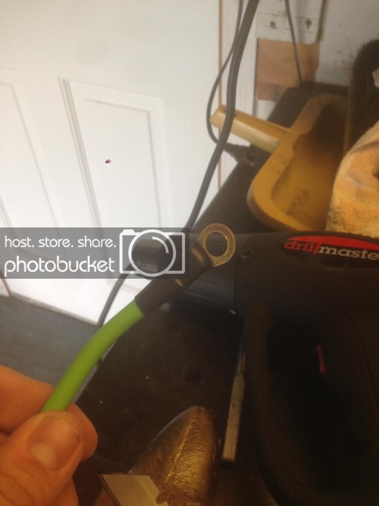

No time to do the terminal posts. Did one for each voice coil on each sub so I could easily change the ohm load without taking out the subs each time
Yes I know you will never see the fact that all the wires in the box match the others but I will know it's right lol

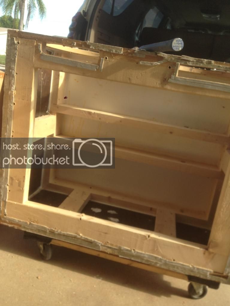

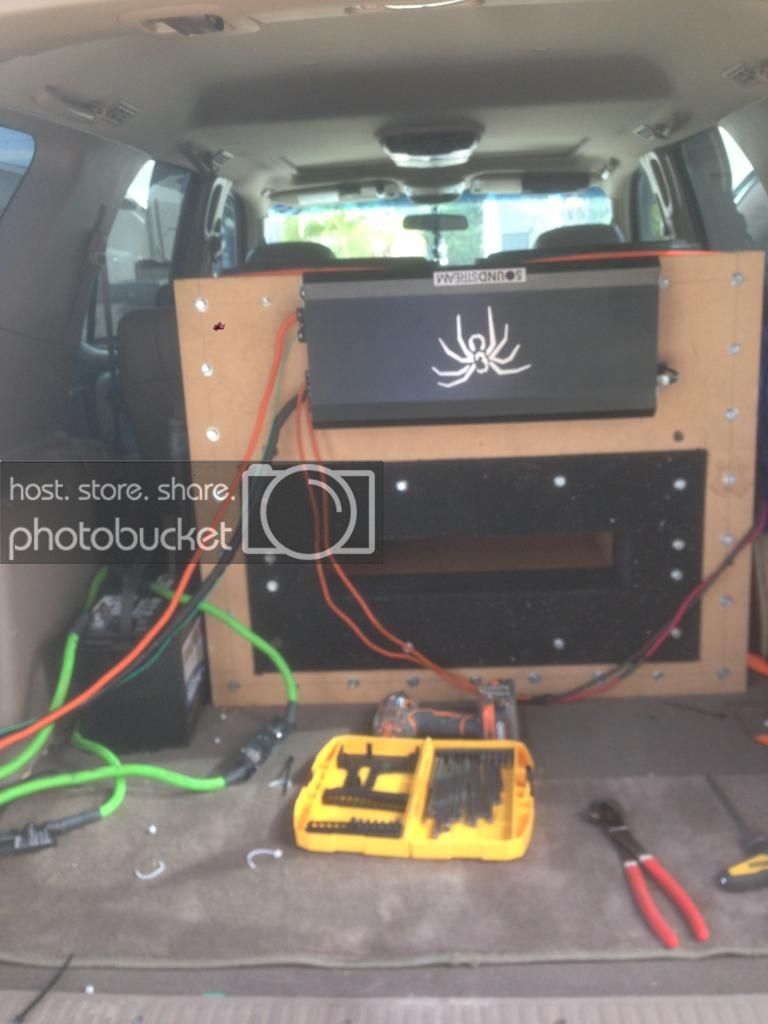

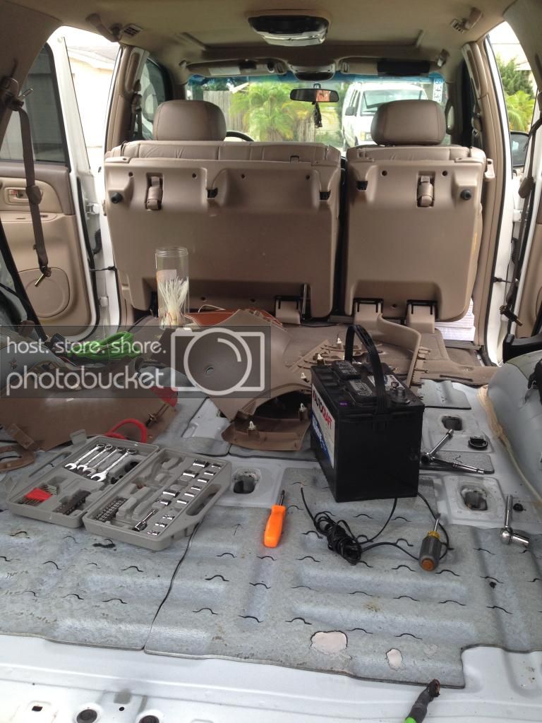

And then the tare down of my old **temporary** system took place. Let me stress that it was temporary so the wires were a total mess

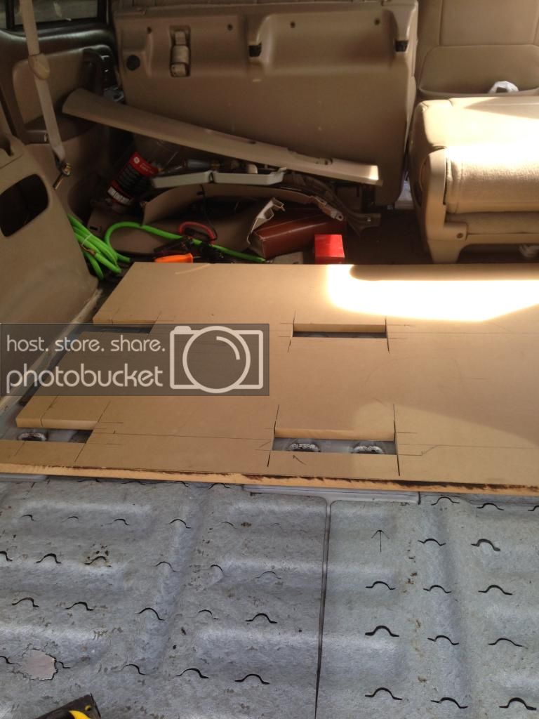

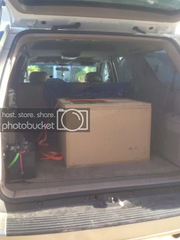

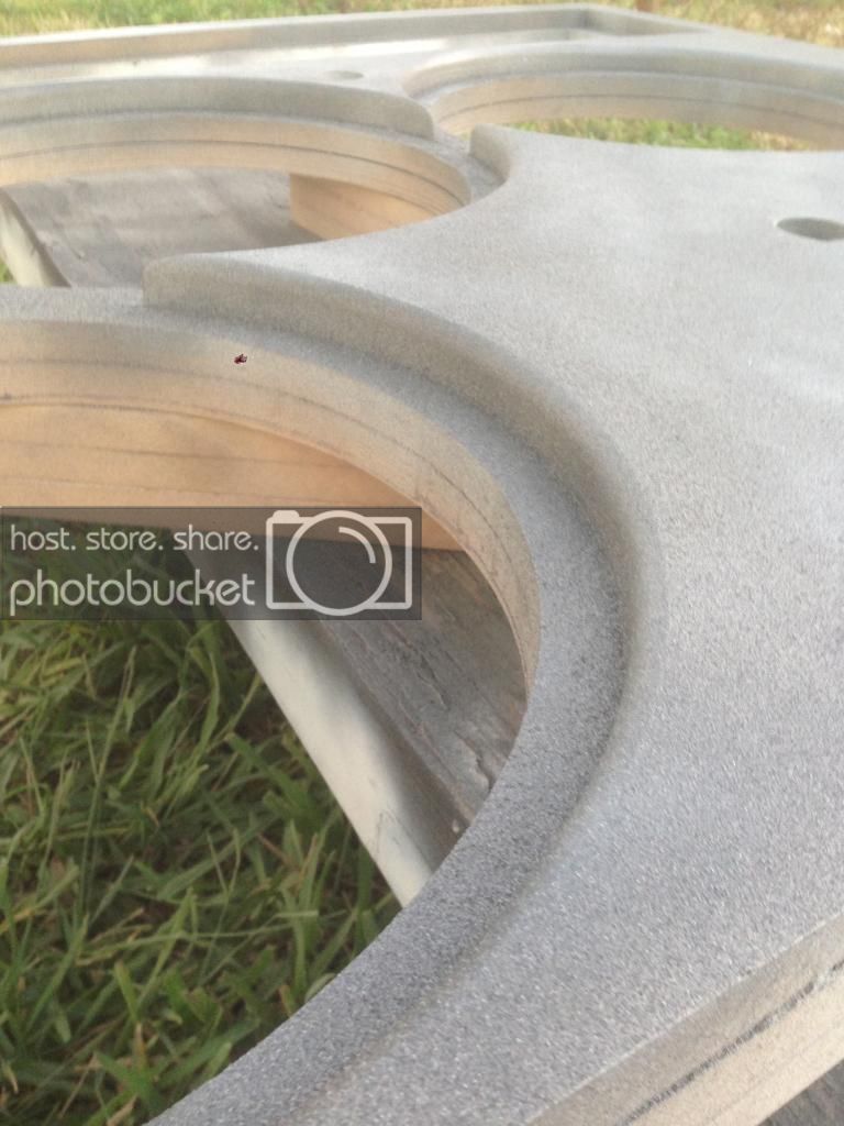

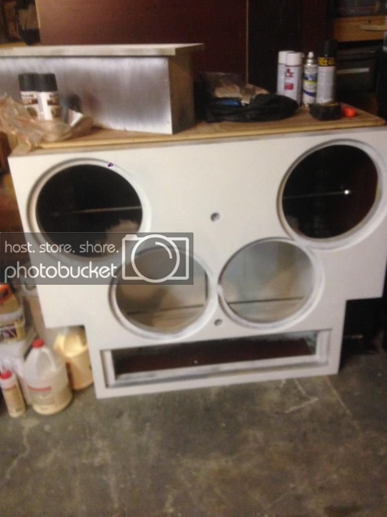

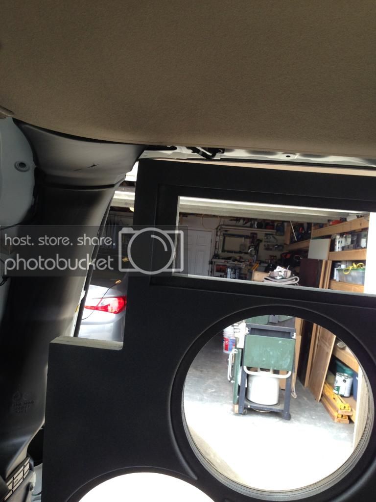

Baffle test fit. This thing fits like a glove not an inch to spare.
