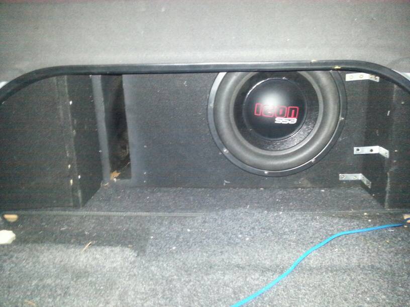

So I always heard that front facing a box is a bad thing but ive done it for well over a year and from my experience. You lose output but gain sound quality. Today I sealed the front correctly and wow, what a difference. Its massively changed. I lose a lot of weird upper harmonics that I was getting, ringing, and gained quite a bit output. It sounds 10x better.

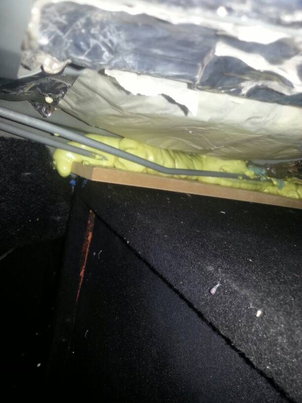

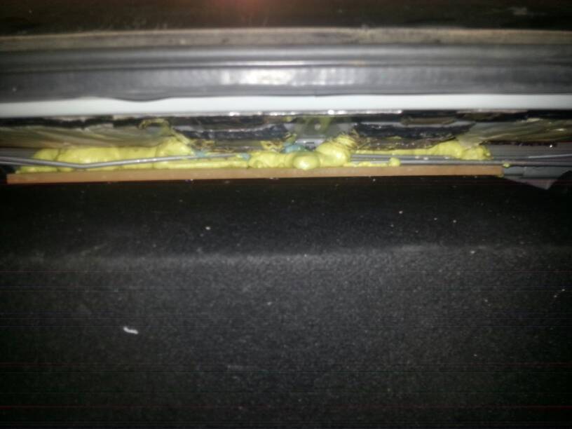

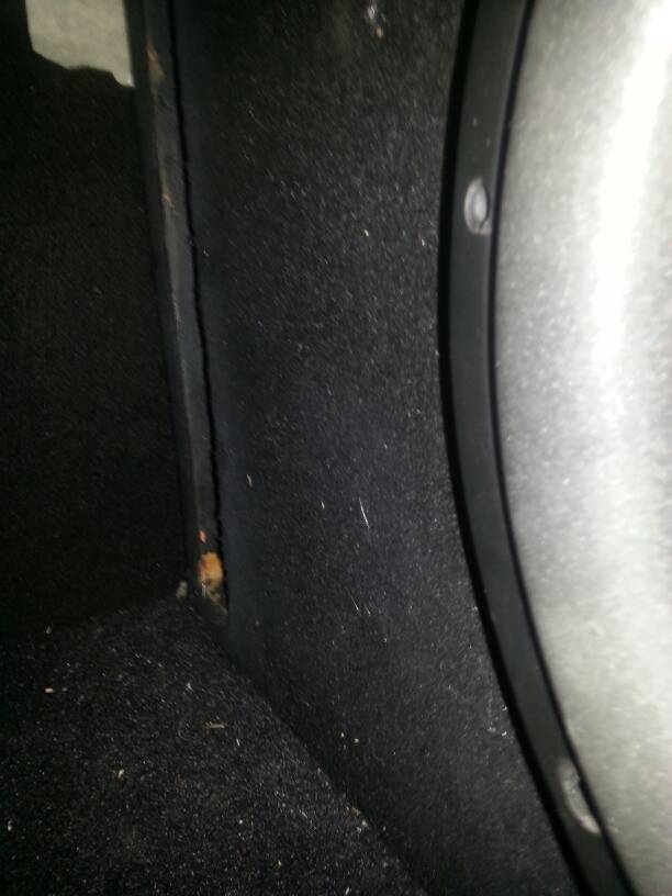

So essentially what I did was push the box as far forward as I could. Then took cardboard and cut out designs till I had most of the free space taken up by cardboard shapes. I transferred those to wood, carpeted them and mounted them to the box or wherever I could to make them solid. The top part was the big issue as the trunk is curved and the torsion bars get in the way of everything. I took a 1/2in mdf board and cut it the width of the box and the length of the distance between the box and trunk face. Pushed that forward and ontop of the box. Its held there be pure pressure.

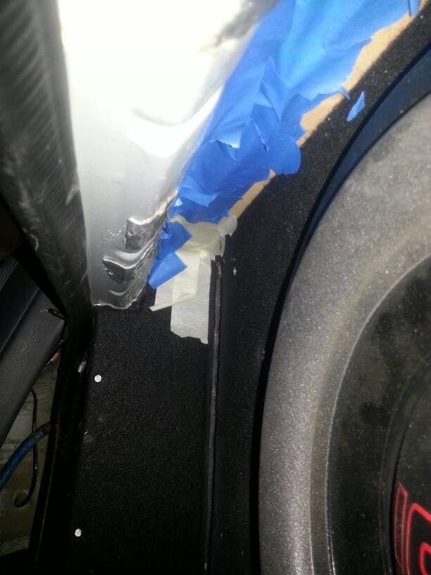

I got underneath it and paint taped everything between that piece and the trunk hole. Then I used some expanding foam to fill in that top area. It should only bind to the wood so itll be removable. This also stops those pesky torque bars from rattling from bass notes.

The trick is to take your time with carboard and get that as snug as possible. A small carpeted face from the rear view and you wont even see the foam.
