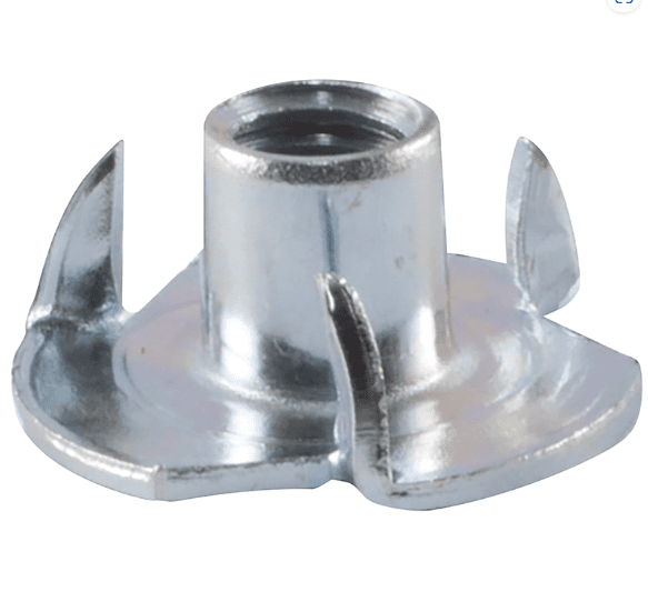

If you might take it out several times, you might want to consider T-nuts. They come in all sizes, but you would drill the hole big enough for that center section to fit in, and you tighten them down to pull them into, the underside of the wood. This allows you to use bolts instead of screws, so that if you pull em in and out several times, you won't degrade the threads. The length wouldn't matter either.
