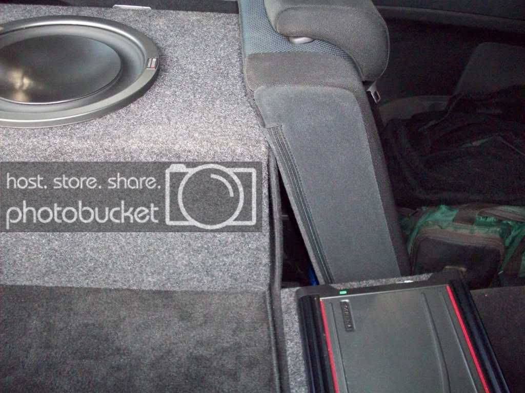

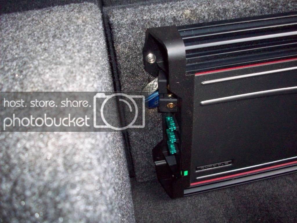

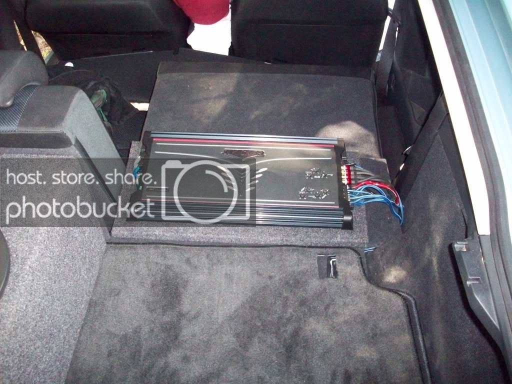

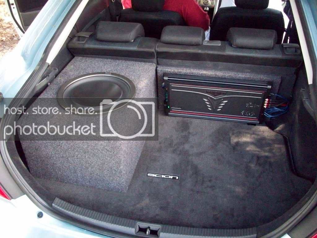

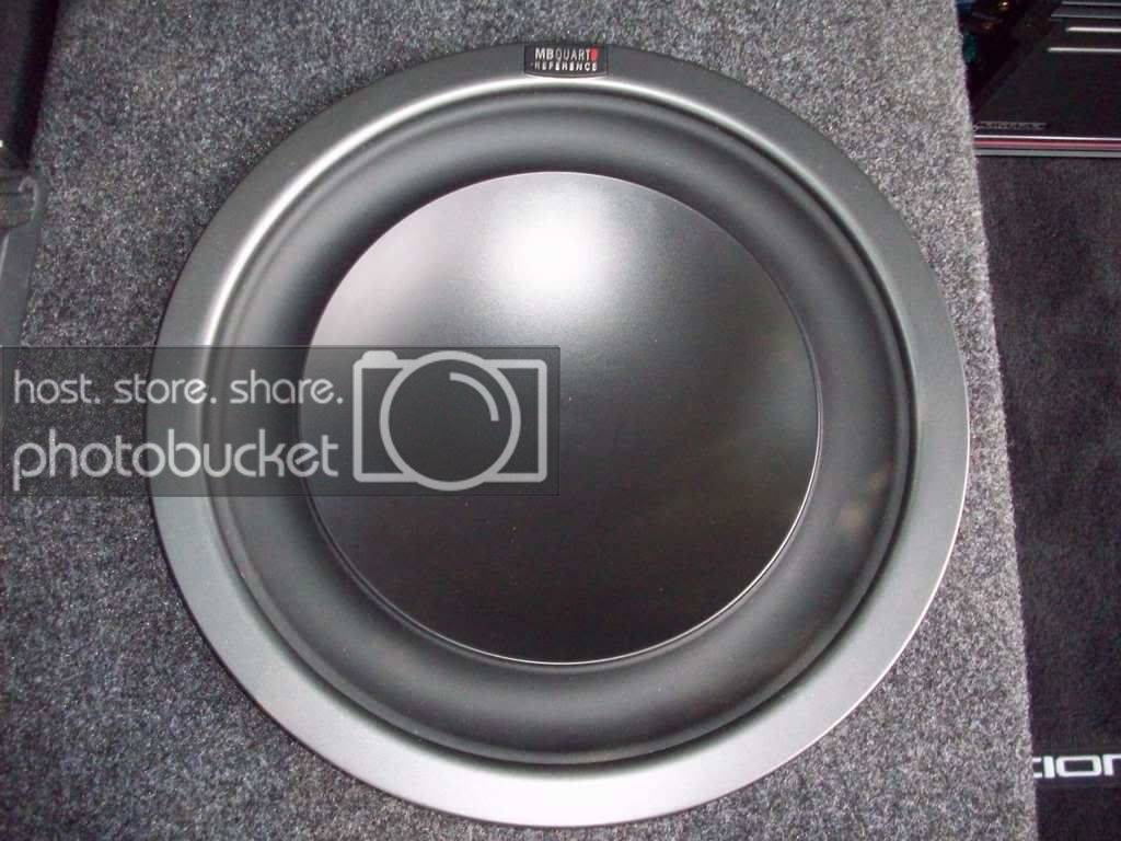

I got a little caught up installing, and forgot to take pics of the door speakers and deck install. but i have some pics of the amp and enclosure when finished.
The equipment:
Deck: PIONEER DEH-P6900UB
Amp : KICKER ZX700.5
Front Speakers : RSD65CS
Rear Speakers : RSD6.5
Sub : MB QUART RWE304 12"
Oh, and it sounds damn good:D
Whats the Max Dimensions of the hatch area? My buddy is picking his up this friday
im not quite sure, because i was not ALLOWED to use the whole area. But the box is 16" wide, the amp rack is 22", so it is close to 38" wide. The box shown is 10 3/4 " tall x 21" on top.

that was one of the main goals in this install.

Just to let ya know that design had to be modified as to the top height of the point where to you see the slot ports on the front. If I used the actual height of 18", those ports openings would of been firing directly into the rear seat headrests.
So the angle of the top was increased to clear the top of those headrests.
And just for clarification as the dimensions I put up, that top angle is spaced a good 4" away from the hatch, I used the angle of the interior molding trim seam between the hatch and interior.
Best advise I would give here is to make a cardboard template of the enclosure's side profile and use that to make any adjustments as necessary as to fit in the install area.
