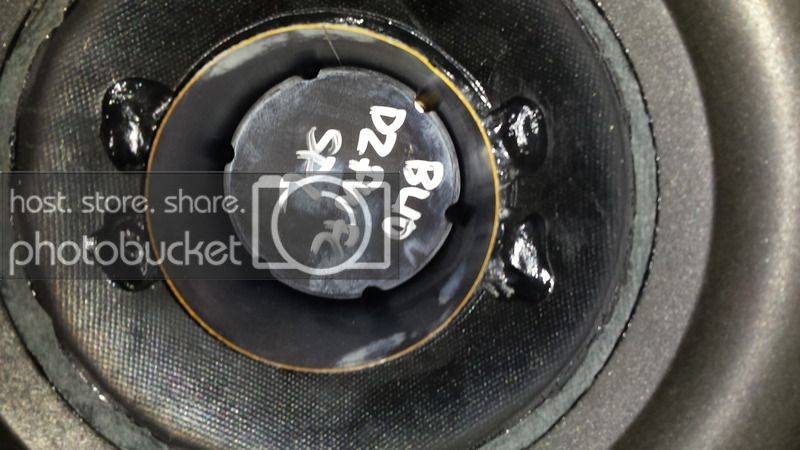

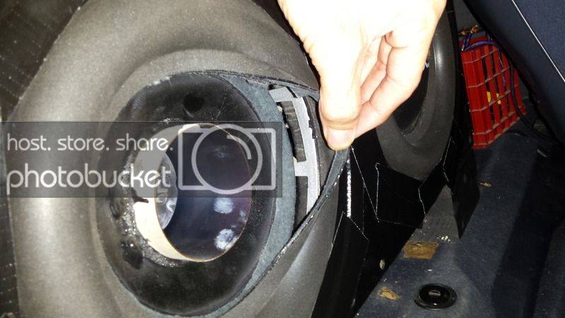

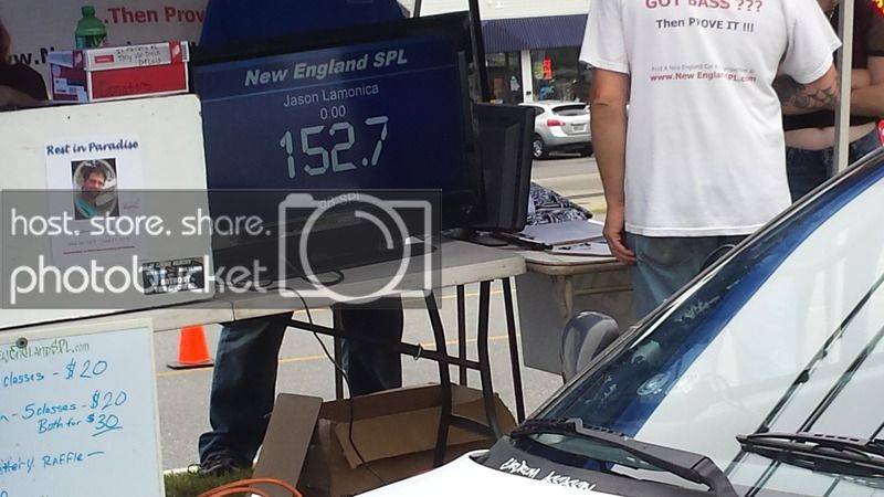

I think there were a few vehicles for sale, one being that blazer. I ended up doing a 152.7 on my first run, and then dropped my amps down from 1 ohm to .25 each and blew a dustcap off a sub after the glue connecting the inner surround to the cone failed, which caused suspension mayhem, the coil shorted out and kicked my amps into protect as well. Both subs have glue failure, but after burping them for so long it was bound to happen. All 4 coils still read good, so I just need some goop and glue and I'll be back in business!

I had built a new amp rack and re-mounted my amps Fri/Sat. One of my fuse blocks was falling apart so first run was a real disaster. After bypassing that, I did somewhat better on round 2, but it still wasn't my number (did 152.8 in Hyannis and 52.7 most of last season). I then noticed that while tucking wires I had switched one of my amps out of "slave" mode and it was over-driving into protect. I've noticed that when one amp goes out things sound and behave very badly. Silly me for not doing it a week earlier so I would have time to fully test and order new parts.... Saturday the neighbor had a big party and we were cooking out and shooting from early afternoon til dark. I had planned to test some on Saturday but I got caught up in the redneckery
I'm amazed you didn't break bend or fold that former! You should be able to glue that and get some more life out of it.
