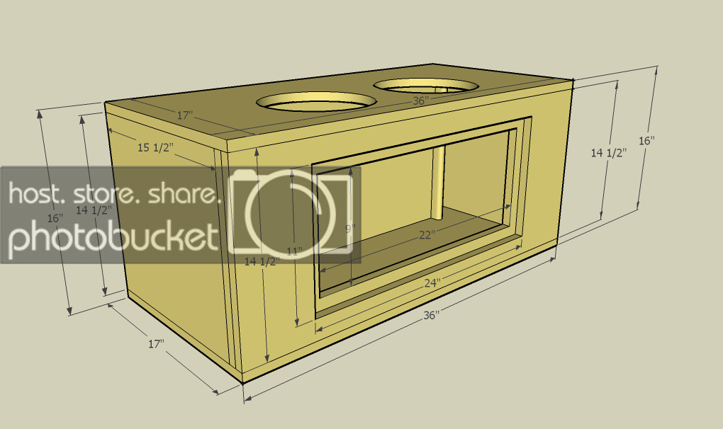

I had two different designs done by two totally different designers. Well, the trouble that the box depth (Box A) is a bit much for me to give up on one, and the other (Box B) seems to be too small. Not to mention that it has no bracing internally.
Box A (Was designed to have a plexiglass front)
Specs on this box are 36"(W) - 17"(D) - 16.5"(H)
http://i194.photobucket.com/albums/z51/qbenjamin/Polkfinalcorner.png

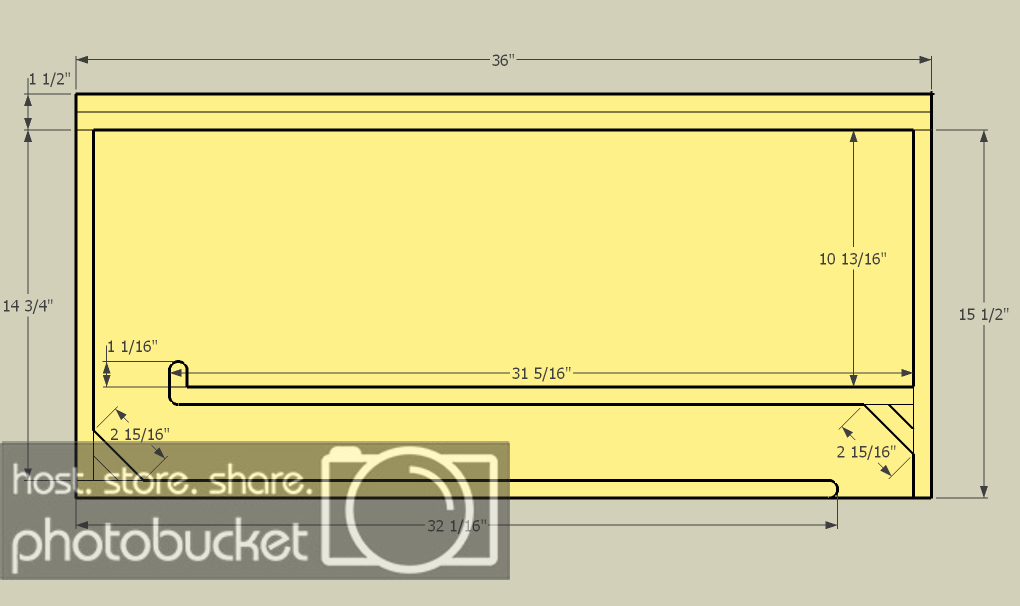

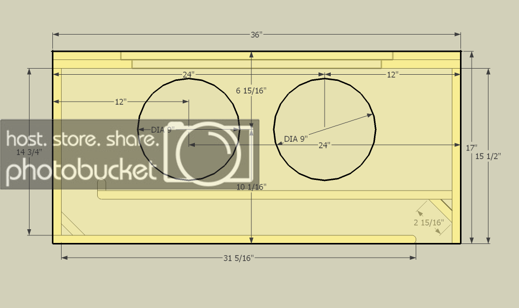

Box B (Basic dual box)
Specs on this box are 36"(W) - 12.5"(D) - 15.5"(H)
http://i194.photobucket.com/albums/z51/qbenjamin/GetAttachment.jpg
Neither box has a double baffle for the subs, but I normally go with internal bracing. Any help would be appreciated, as I really don't know which design I should use.
Is this box ported?
I don't see a port opening but it looks like there is a port wall inside?
Also no one can tell which one is the right one if we don't know what your looking for.
Post up what subs you are using along with desired box vol and tuning if going ported.

Yes, that box is ported.
Subs are 2 Polk SR 10D4's.
Max dimensions are:
W - 36"
D - 17" (Less = Better)
H - 16.5" (Less = Better)
Desired tuning 30-33hz......
the second one is 2.32 cubes after port displacment
the first one is 4.48 befor any displacment being i cant tell what the port is
with those subs i would shoot for 1.3-1.5 cubes per sub at 32hz

So which should I use?
Specs on that second one are as follows:
Port piece # 1 9.25" X 14
Port Piece # 2 9.75 X 14
Port Width = 1.75"
Port area = 24.5"
Port Length = 21.75"
