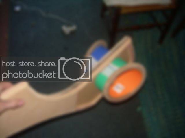

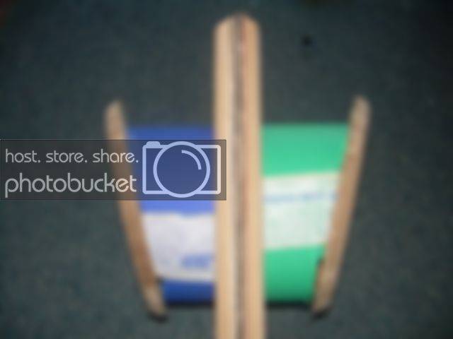

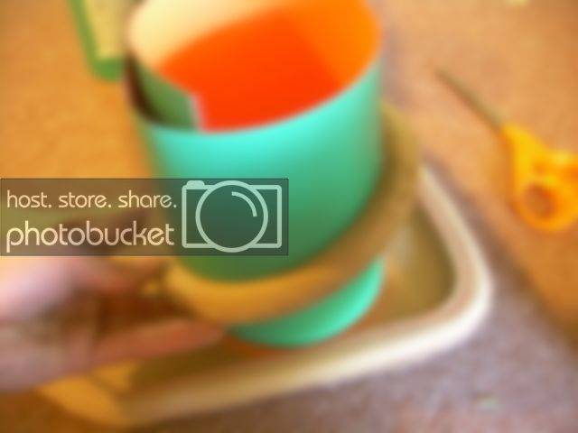

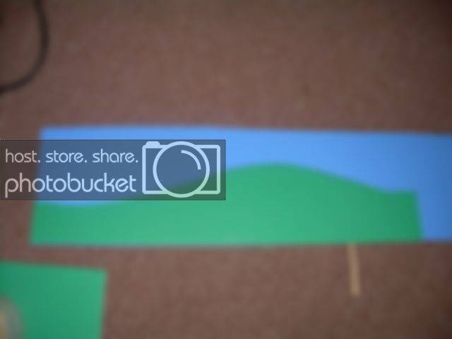

Hey man cool look and clean work, something I do in order to mount rings is use cardboard and roll it around the speaker and make a profile that way, then when you are done you can make an exact copy so that the pods are both exactly the same,
here are some pics...
THATS ABSOLUTELY GENIUS... THATS MOST DEF SOMETHING ILL HAVE TO REMEMBER WHEN WE BUILD MY PODS FOR MY ID CX 62'S
