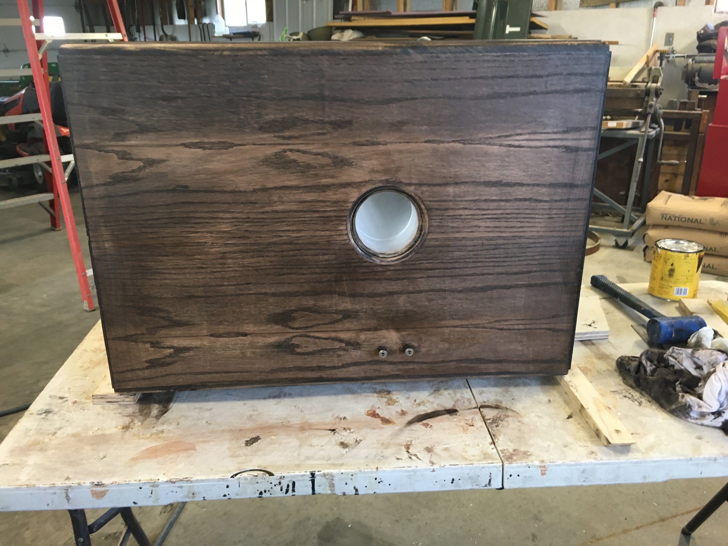

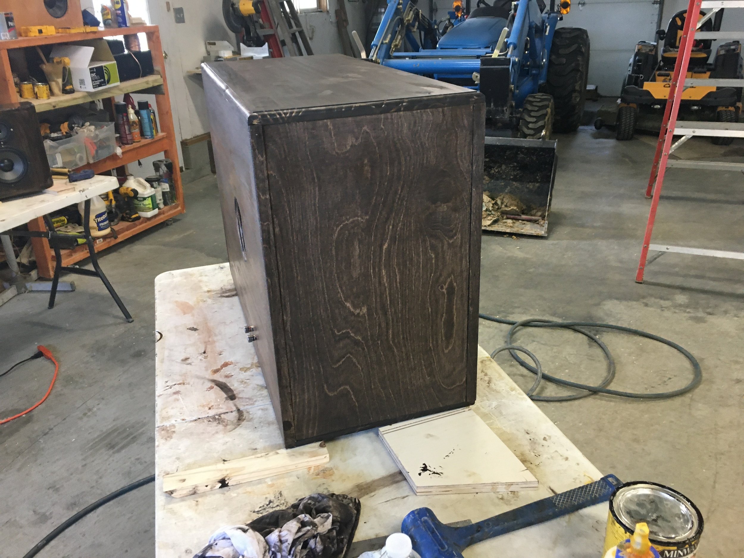

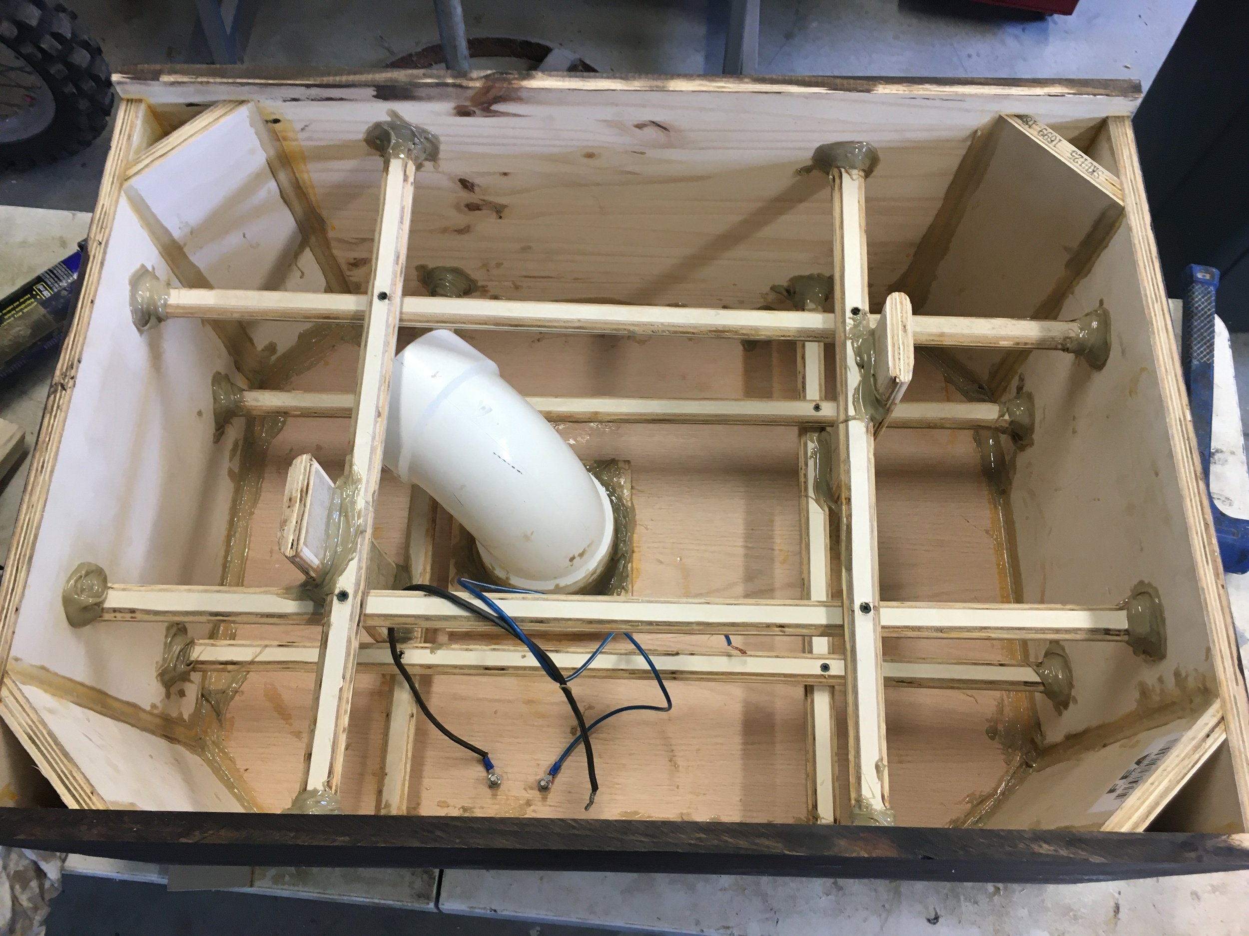

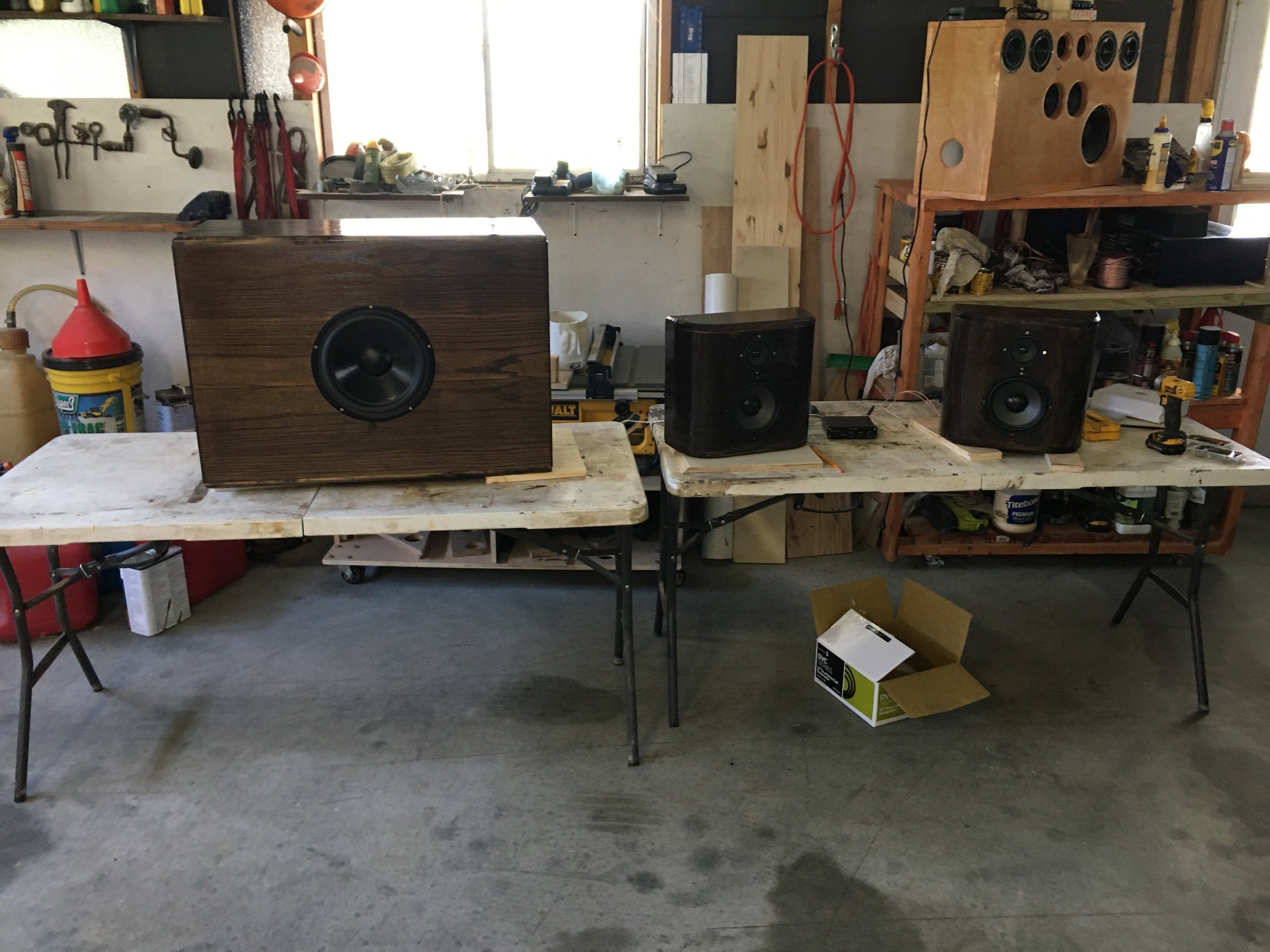

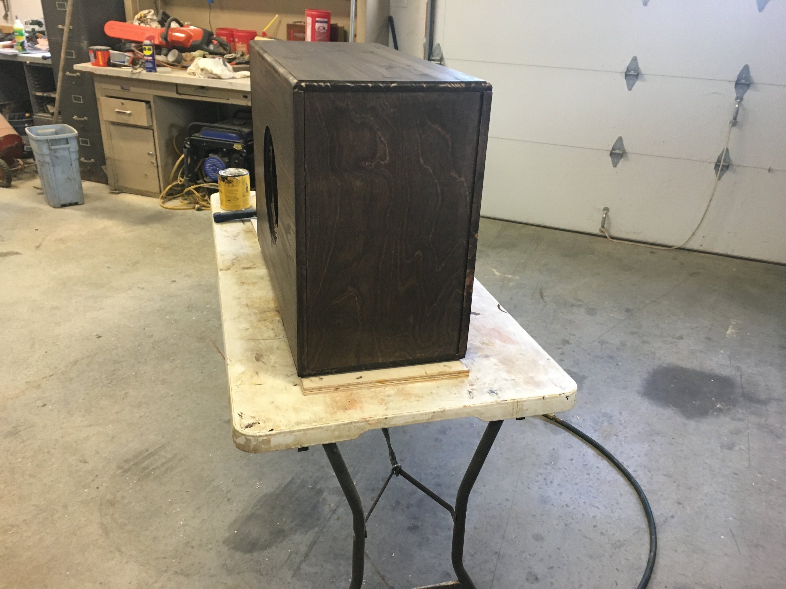

I just got this done today. Poor mans man cave for a buddy. Just a mishmash of wood I had left over. Birch,oak plywood and some pine won’t find any mdf. Hardly any power with a Dayton 2.1 amp. Sounds great even shakes the garage doors. No splits enclosures lite as can be. No pre stain ju
st a get it done kinda deal on a 50 watt 25x2watt amp no wood splitting all clamped no screws. It takes longer but you don’t have to use screws. It’s the glue that bonds the wood ATTACH=full]21575[/ATTACH]. ATTACH=full]21571[/ATTACH]

I heard MDF is common because of it's density and vibration resistance. does using pine or birch require more bracing?
I don't know the scientific differences but the 3/4" 13 and 11 layer pine is very nice and doesn't require any more bracing than another other wood i've used. I normally use fiberglass resin on the insides anyways.
