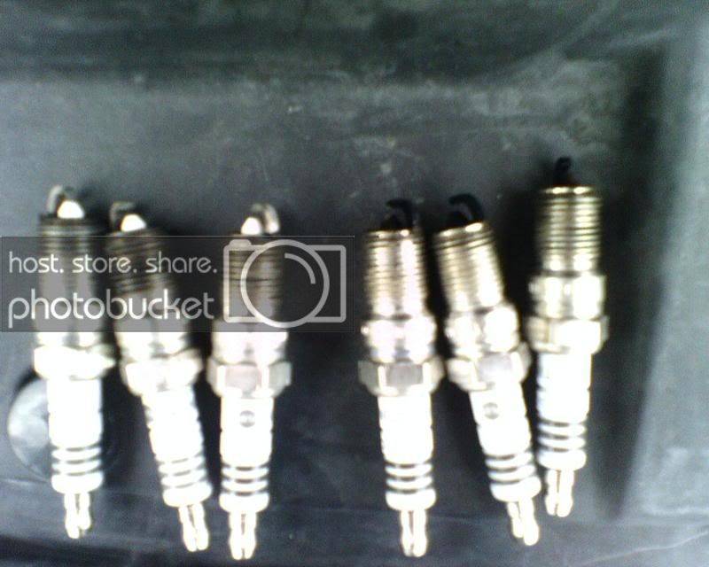

I've been getting really bad gas mileage in my sixxer... I'm talking in the single-digits. So, I took out all my spark plugs... and, well... I'm fvcking confused:
The spark plugs are in order of how I took them out. So the ones on the left is the passanger side, the ones on the right is the driver's side.

Obviously something is wrong. My question is: do I have to take it to a shop to fix it?

usaully it will set your CEL but go to autostoned and see if there is a code. There should be 1 O2 sensor on each downpipe and 1 after your cat. Not posotive cause Im not a Ford tech. But get it checked sounds like an O2 problem to me.
I've always heard those places will hook up to your car for free-- but, I don't even know how to begin to ask. Do I just walk up and ask if they'll scan my car for me?
If you've had the car more than a couple years, and you've never done them, then do them anyways. There's a way to test them, but it's not really worth it, if they're more than a couple years old. Also, be very gentle with the new ones. They have a porcelain element inside them, and if you drop them, it could very easily trash them. The Essex V6, had 3 O2 sensors, in most cases, 2 pre-cat, 1 post-cat. Cali cars have 2 pre, 2 post.
So I took my car to Advanced Autoparts today to run the codes.
I got P1151 and P0174
Aparently it's running lean, not rich? //content.invisioncic.com/y282845/emoticons/confused.gif.e820e0216602db4765798ac39d28caa9.gif
Anyway... What do I replace? The guy at Advanced Autoparts said MAF and O2. But, according to these codes, only the O2 is bad? Any help?
