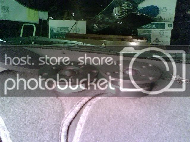

I actually have a pair of those tweets, that i've never touched. too lazy and i'm lovin' how the HDS tweets sound.
The HDS tweets feel to have much better build quality compared to the DX25s. dual mag vs single. solid metal flange vs. dinky plastic. I can't compare the sound since i haven't heard the dx25s yet.
