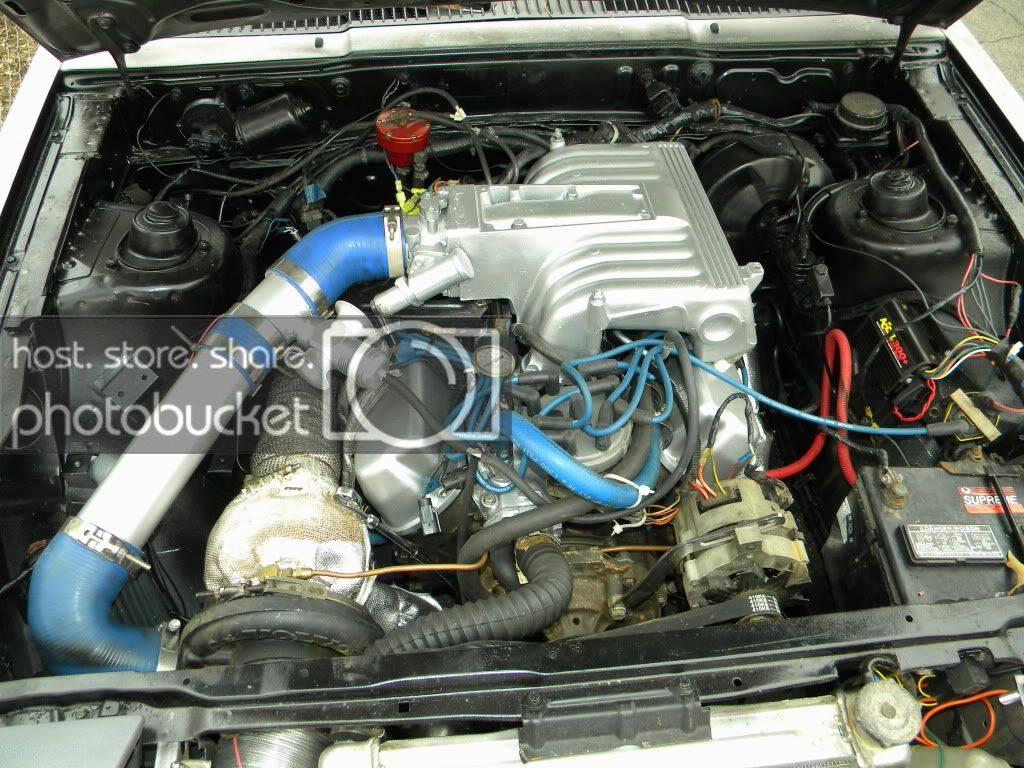

Silver and black one packed this:
Cool //content.invisioncic.com/y282845/emoticons/smile.gif.1ebc41e1811405b213edfc4622c41e27.gif
I take it the Bishi was gray with the turbo?
All of the conquests and starions were 2.6 turbo's. Only engine offered. the silver one had a 5.0 swap with a turbo.... It had enough power to spin your 13 alternators lol
