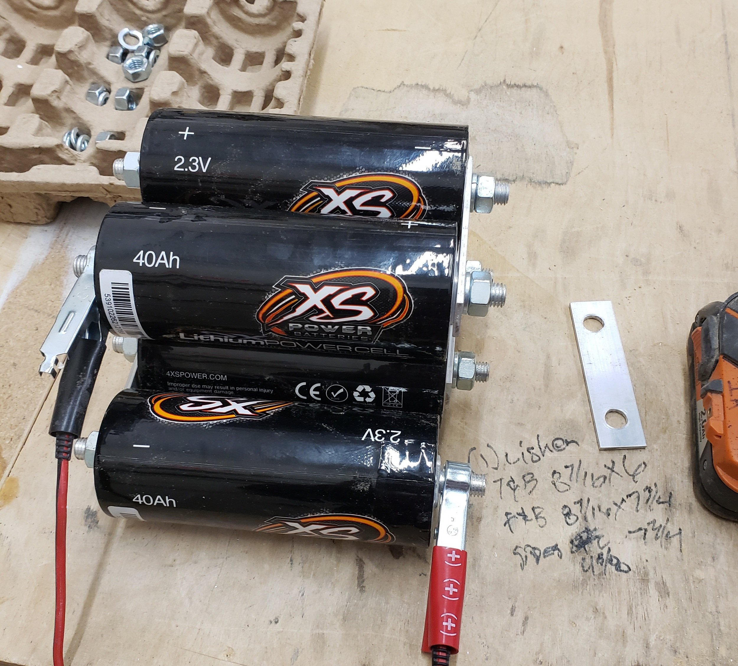

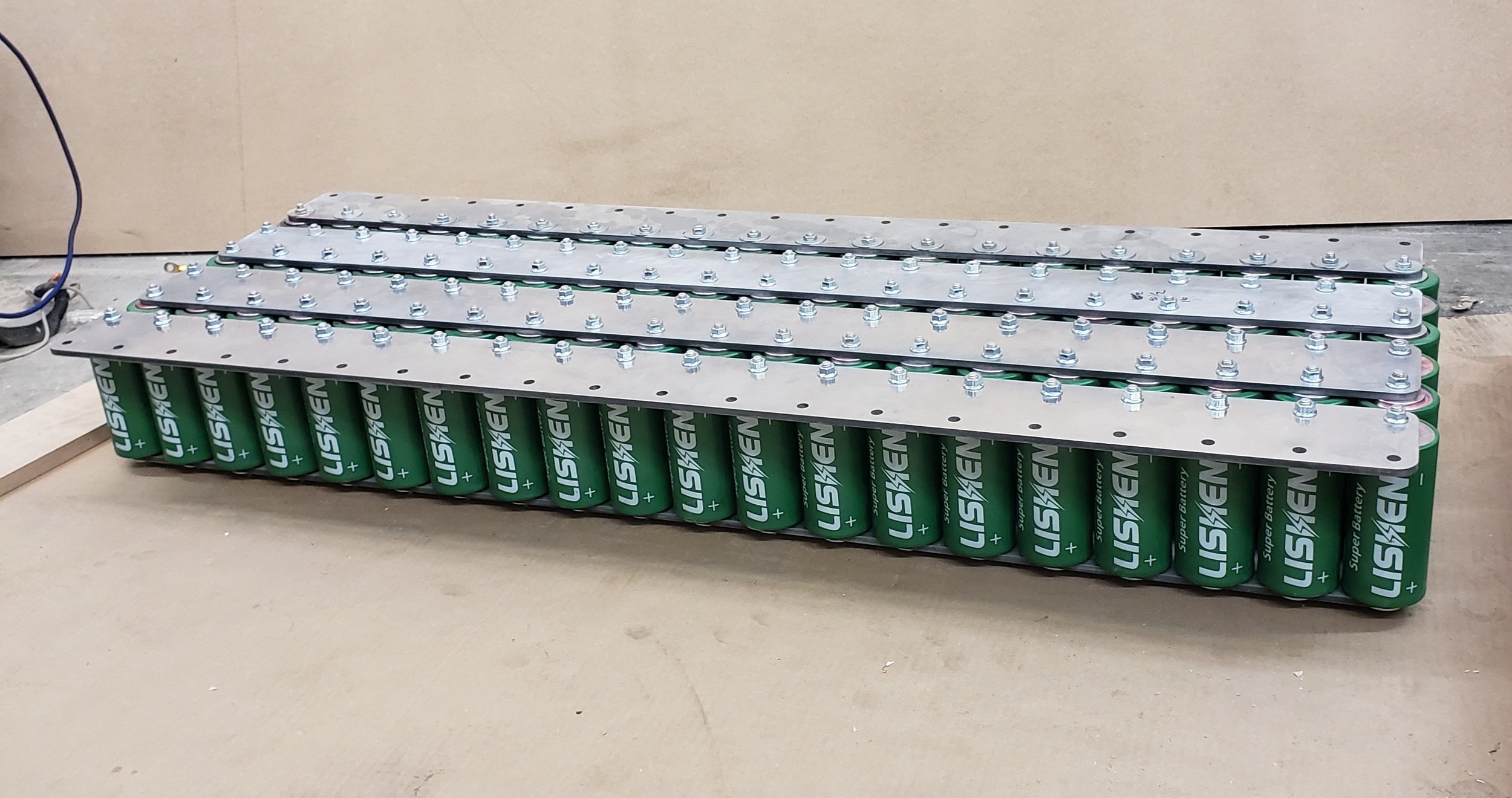

I was running a Sundown SIA3500 @ 2 ohms (3,000 watts) on two HD 8's with a 55 amp alternator, one AGM, and one bank of Lishen lithium (18ah). It can be done. 142.9 @ 33 hz.
Bench testing class A/B surfboards taught me that one lead acid battery is sufficient for un-neighborly bass. Logical online discussions have swayed me that alternators are the ones providing all the boom juice. So I am stuck in the middle.
Alternators, lithium batteries, and agm batteries. You don't need as much as the first picture. Maybe the second picture.
