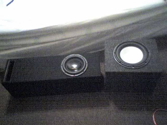

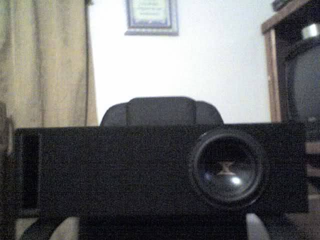

Just got the ninja box in Jason, and man let me tell you bro. You did a SUPERB job on the build quality. I swear it's best box I've ever owned (terms of quality) and the price could not be beat. 110% satisfied with the box aesthetics. I WILL test it out tomorrow (just got out of work, but I received the box earlier today) Here are a few pics for anyone interested.
and next to my infinity perfect 10.1 in a .85 cuft sealed enclosure. I love this ninja box!
sorry about the grainy pics //content.invisioncic.com/y282845/emoticons/frown.gif.a3531fa0534503350665a1e957861287.gif I really need a digi cam now :p
