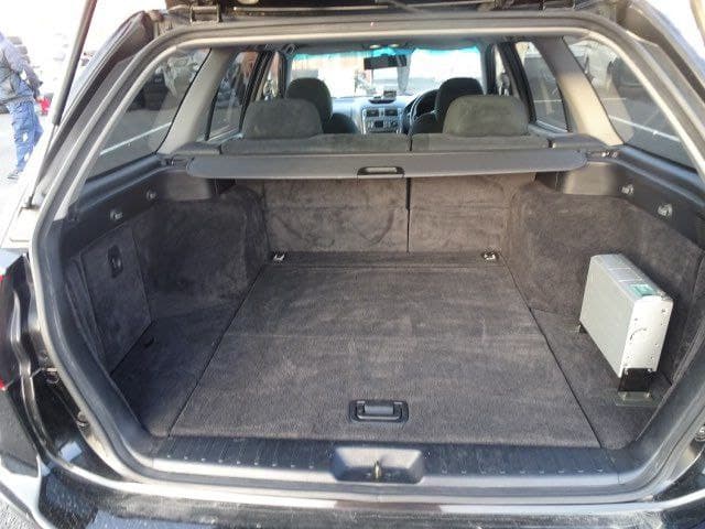

The subs are not together, there will be a sub box in a fender nook on each side of the car facing in toward each other. (one on each of the panels that CD changer is bolted to)
Might do a mono block with dual hook up, as mentioned the power delivery is not finalized yet.
