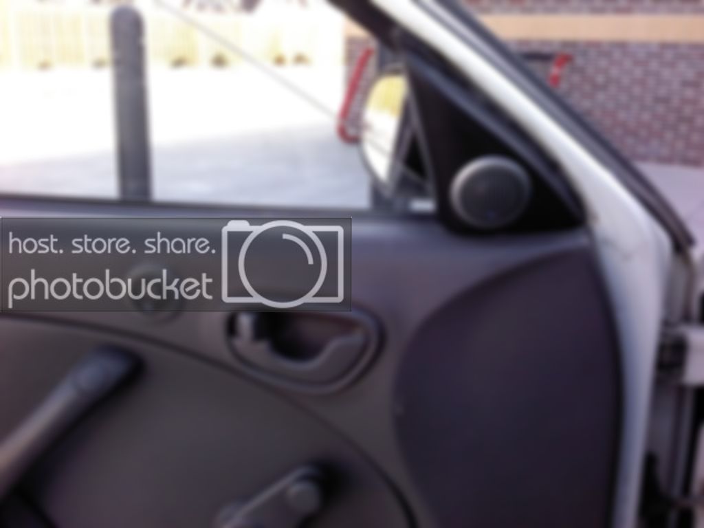

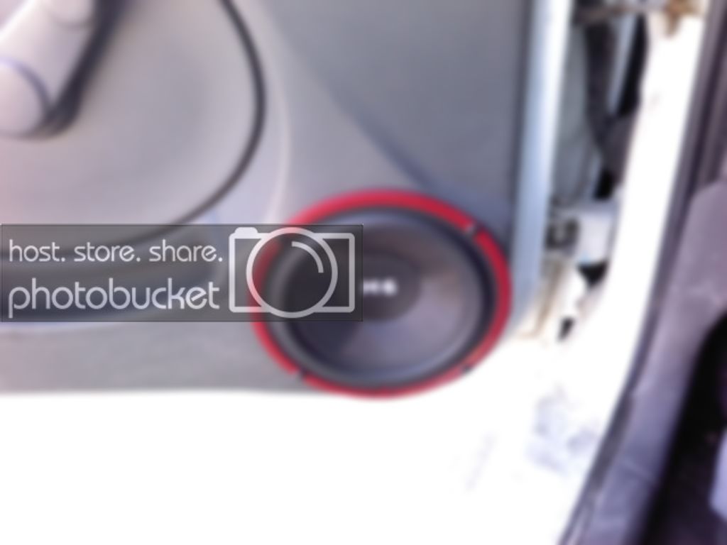

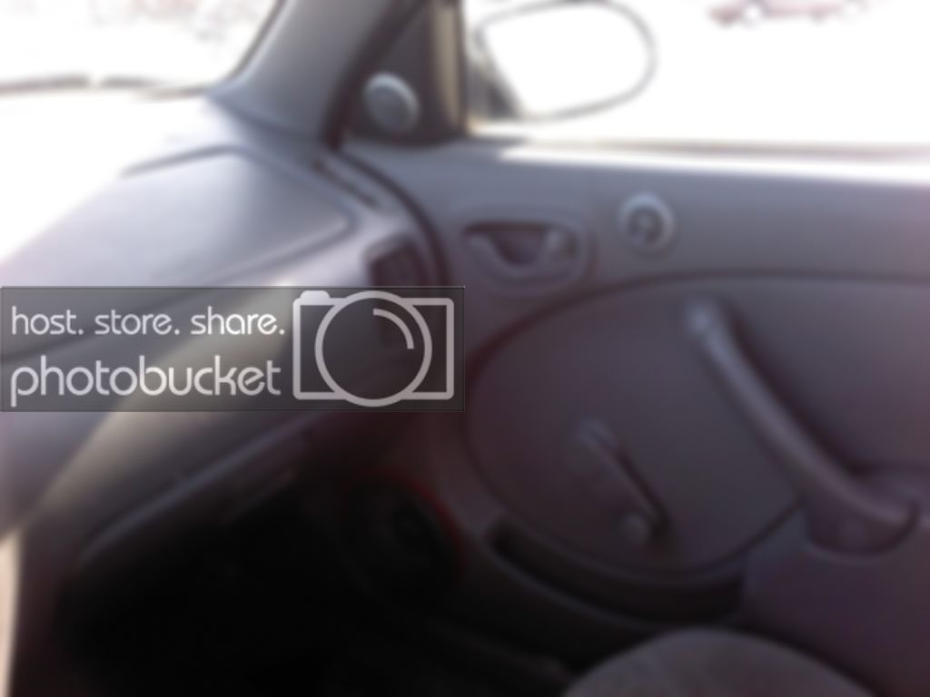

The doors as they are now.

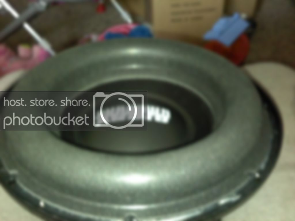

Moofers!!

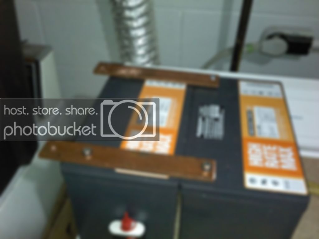

copper bus bars

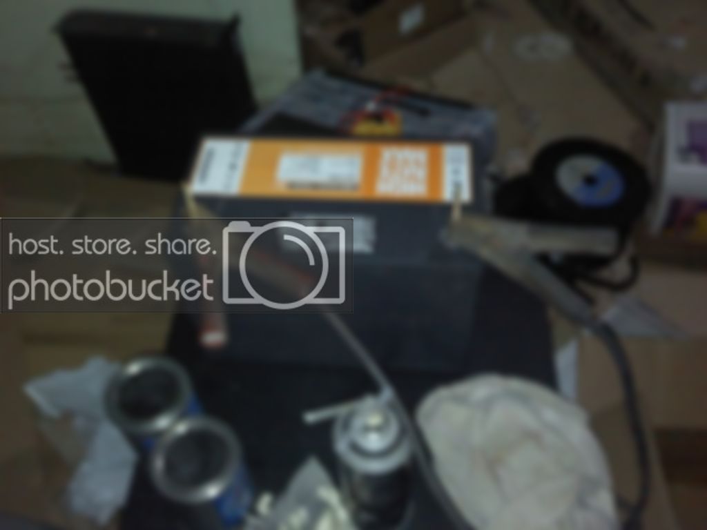

charging the c&amp;d's
Short runs done. 2 runs of 1/0 from front to rear batts. Each rear battery will also have it's own 1/0 ground directly to the frame next to it. All lugs are soldered on with a torch.

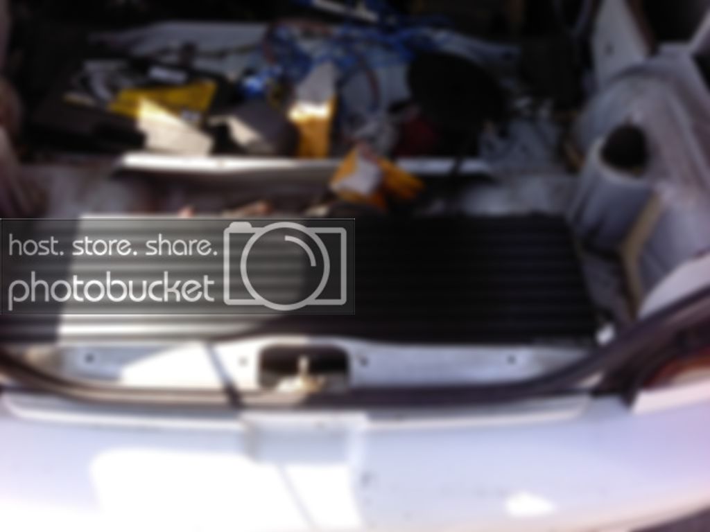

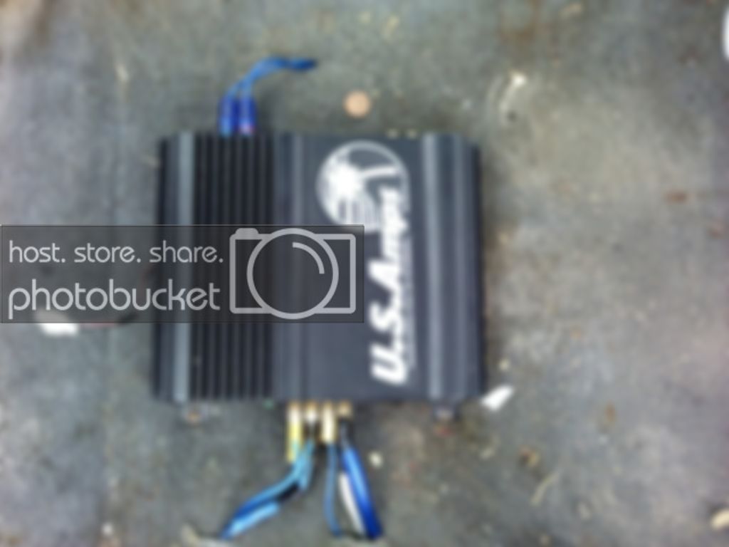

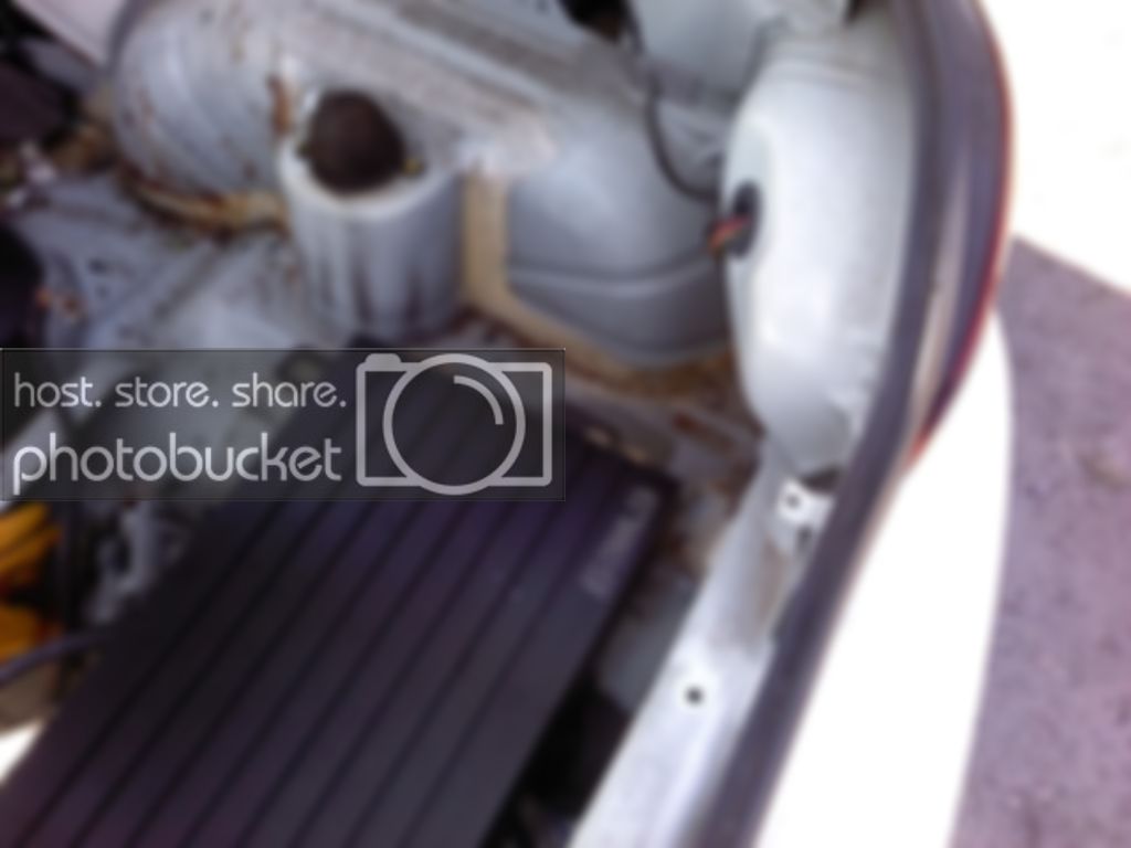

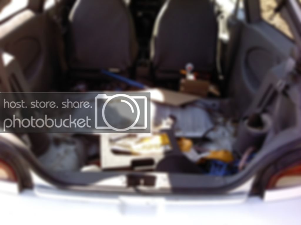

Removed the back seats and all the trim panels today for deadner. Cut the box od out of cardboard to test fit. Fits perfect! Also test fitted the amp and it too fits.
Now comes the real work! deadner, build and install the box, wire up the batteries and amp and i should be set!
