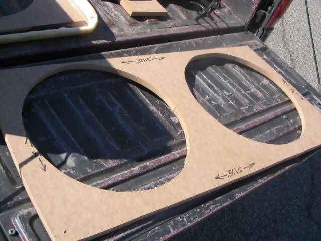

so. on with more pics.

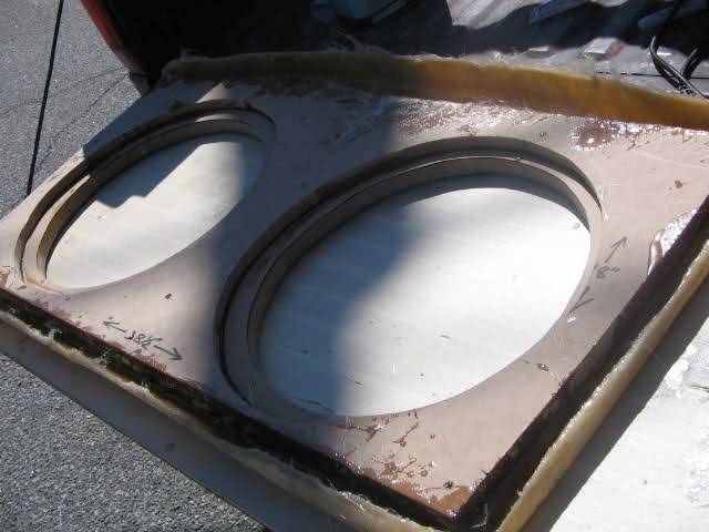

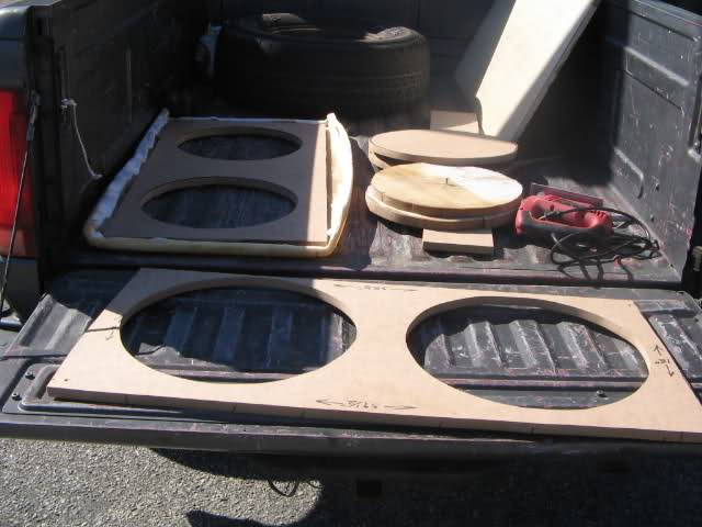

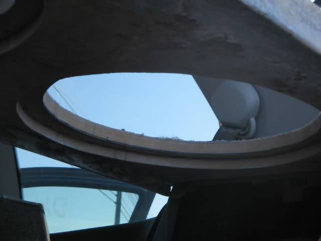

mind you, all i have for tools is a jigsaw, a little tape measure, and a 19v drill. so making perfect circles is out of the question. im going to cover it up with a nice grillcloth cover and black vynl. i live on base so im very limited with tools. i wish i had brought my router from back home //content.invisioncic.com/y282845/emoticons/verymad.gif.3f39c5c2fd57527b671fad3efdfac756.gif

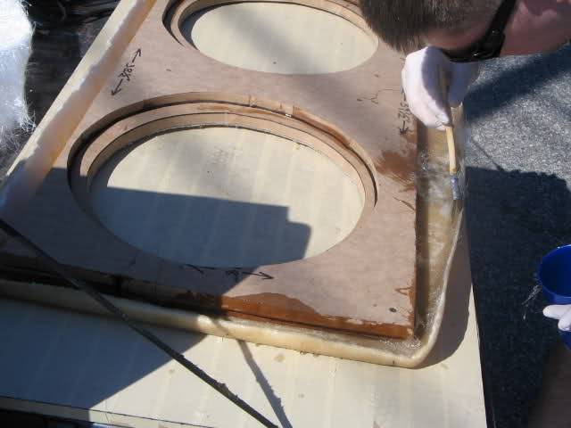

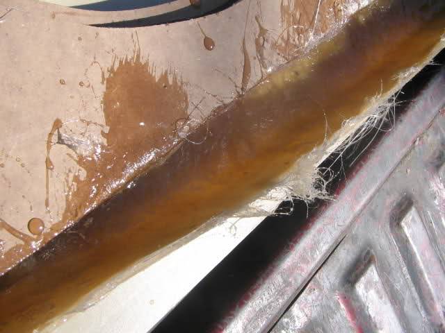

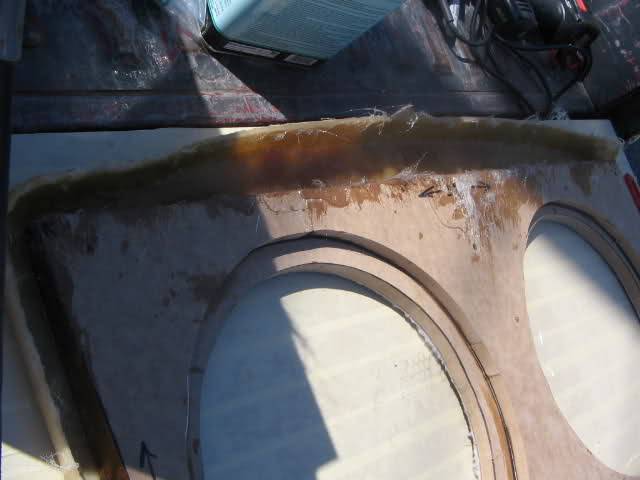

im going to fill the edges with kittyhair to make it real solid. i plan on putting a bunch of drywall screws horizontal in those pockets to make for some nice reinforcement.

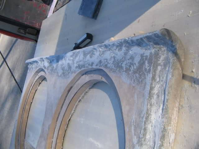

i guess im only going to do 2 layers of baffle, its already heavy as hell. so im getting close. just gotta let the resin dry and trim the edges up nice. do a little bondo work and sand it all down. its comming along quite nicely //content.invisioncic.com/y282845/emoticons/smile.gif.1ebc41e1811405b213edfc4622c41e27.gif

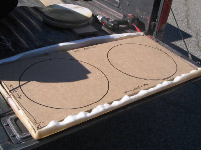

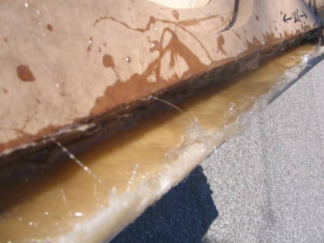

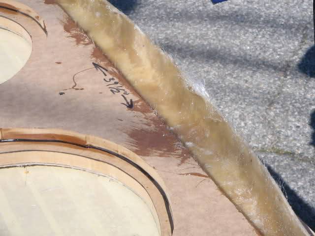

filled up round the sides. i ran out of filler, i needed like 1 more ounce lol.

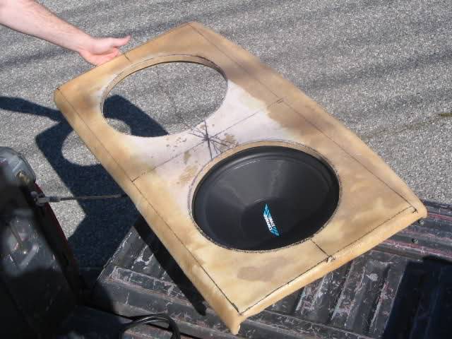

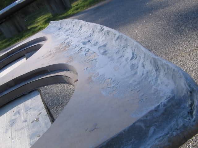

its strong as hell. weighs like 40-50 pounds. should be nice. i have a few fitment issues to address with the edges filled that i need to sand back, but otherwise its comming along. lots of sanding i know, but kittyhair is a ***** in that respect.
other than those minor details (again, usually a problem when filling weird areas) things are rolling smoothly.

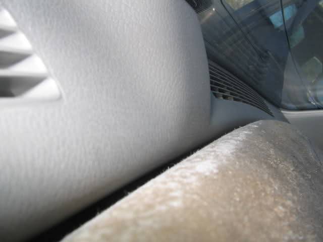

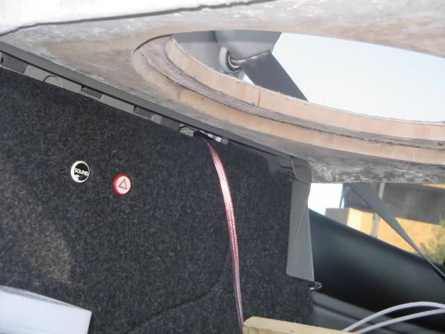

that last pic shows the tailgate versus the panel. theres like a 1\4" gap there, i plan on putting some sort of padding\foam under the vynl to make a nice seal there and keep it looking nice. hopefully it will work //content.invisioncic.com/y282845/emoticons/smile.gif.1ebc41e1811405b213edfc4622c41e27.gif
