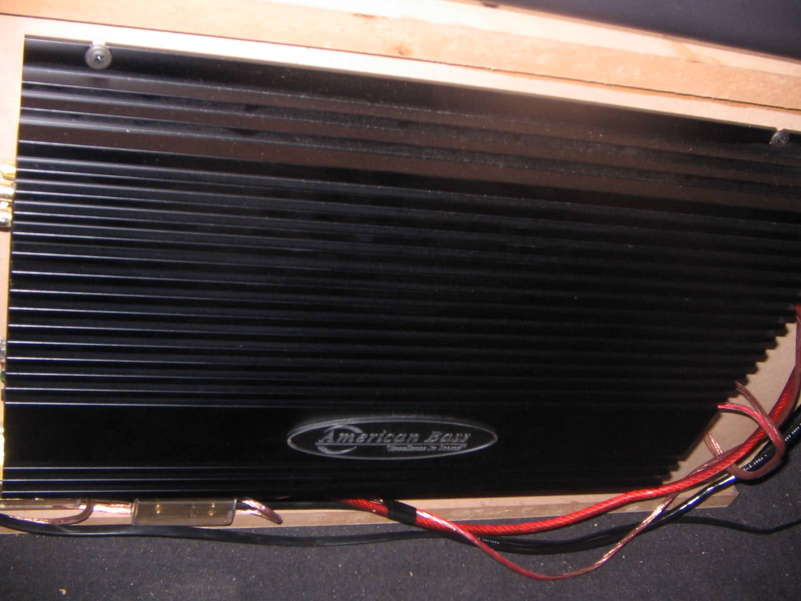

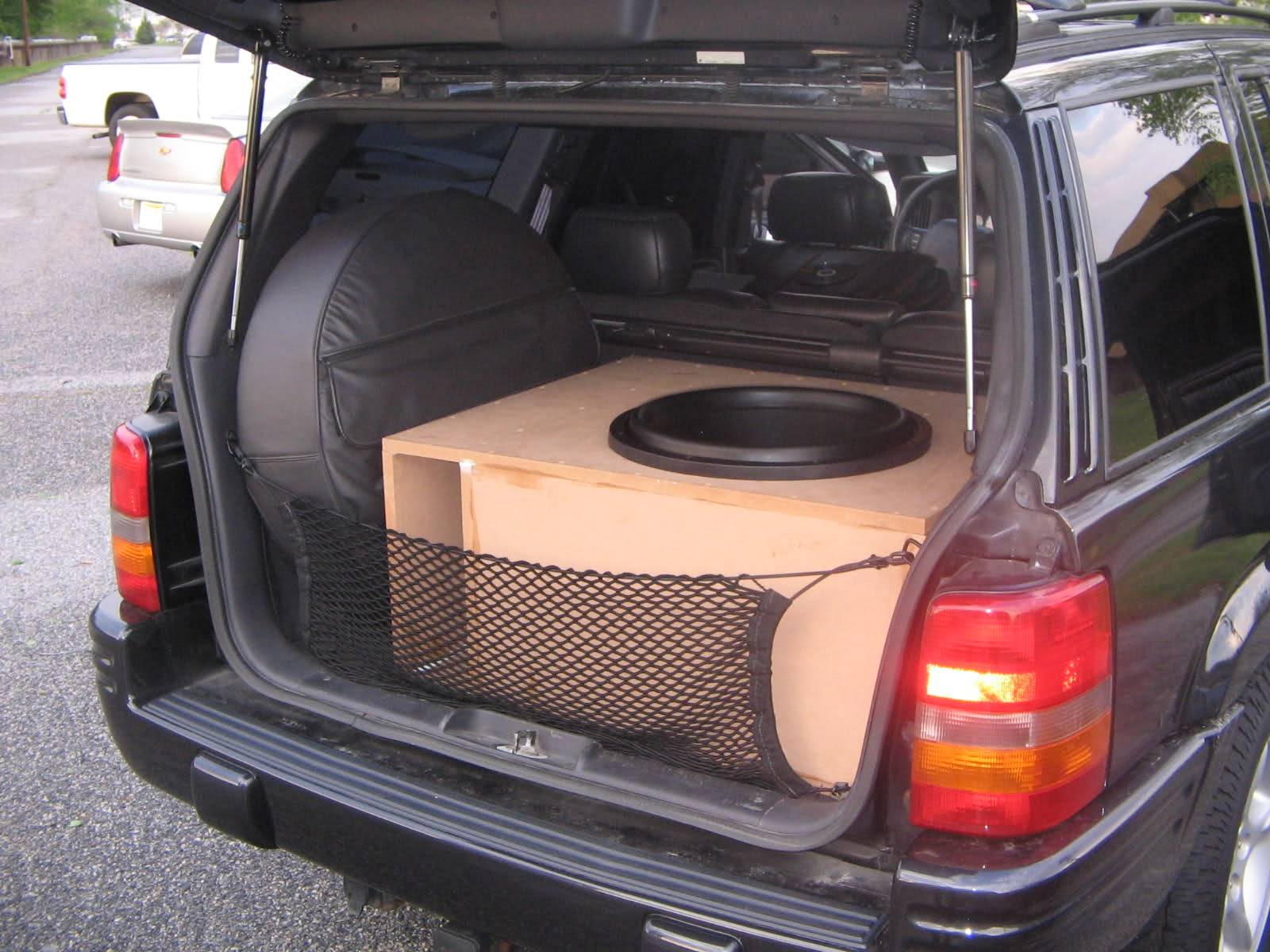

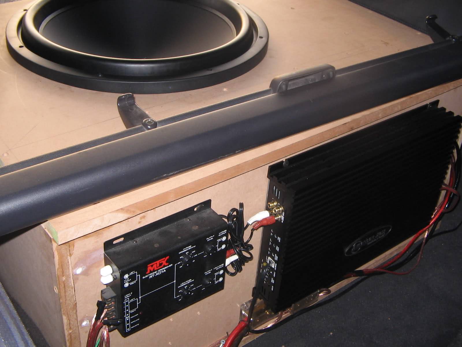

friends car. test box we put together. its like 3.9cubes @ 28hz with just shy of 8in^2 of port. and an american bass CX.100.1

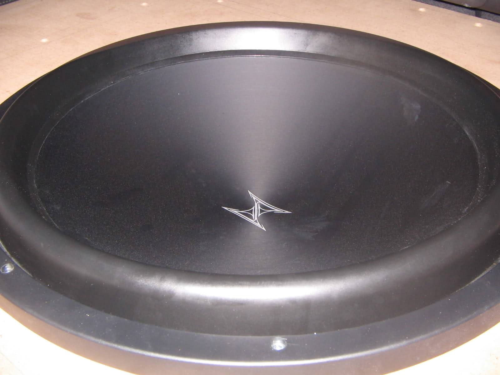

if you couldnt guess. rlp 18.

I think that is the biggest 8 sq/in port i have ever seen //content.invisioncic.com/y282845/emoticons/biggrin.gif.d71a5d36fcbab170f2364c9f2e3946cb.gif
but **** that rlp-18 is sexay

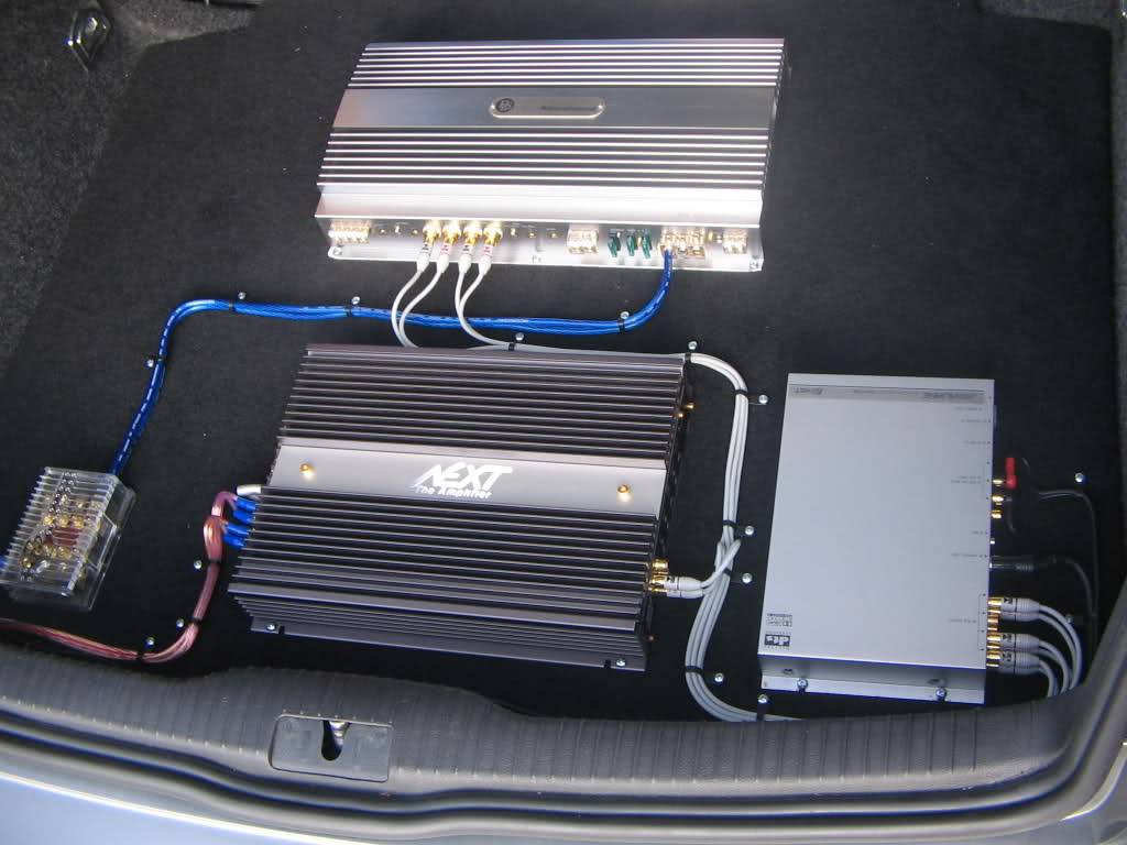

i did a lot of cleaning up on the amprack. im soldering some RCA's right now. so ill have pictures later tonight. i might not finish until tomrrow though //content.invisioncic.com/y282845/emoticons/smile.gif.1ebc41e1811405b213edfc4622c41e27.gif
and ill make the pictures smaller for everyone too lol.
trunk is looking real clean.
got some more power\gnd wires to run to the next amp and the ground to the dls. the 4 guage i had was too short, so i had to double up 8 guage. it looks nice, so i might stick with it. if not ill get some 4 guage to go there. then the speaker wires for the tweets (in lieu of cd2 mini horn's because i cant afford horn bodies atm), and subs. then the remotes for everything, and power\ground for the pxa-h701.
getting close to a 90% done stereo //content.invisioncic.com/y282845/emoticons/smile.gif.1ebc41e1811405b213edfc4622c41e27.gif

suckers are solid. the sealed box i had was louder than this IB one and the hatch flexed a bit. but i have not put an ounce of deadener on this car and its real quiet. so i am really happy about that. only thing that vibrated was the sun roof emergency hand crank wich is under a panel in the headrest. its a little allen key, just take it off the mounting bracket and put it in the glove box, all set //content.invisioncic.com/y282845/emoticons/smile.gif.1ebc41e1811405b213edfc4622c41e27.gif
otherwise, the car is quite solid. great acoustics and everything. can fit some good sized mids in the doors too //content.invisioncic.com/y282845/emoticons/smile.gif.1ebc41e1811405b213edfc4622c41e27.gif
