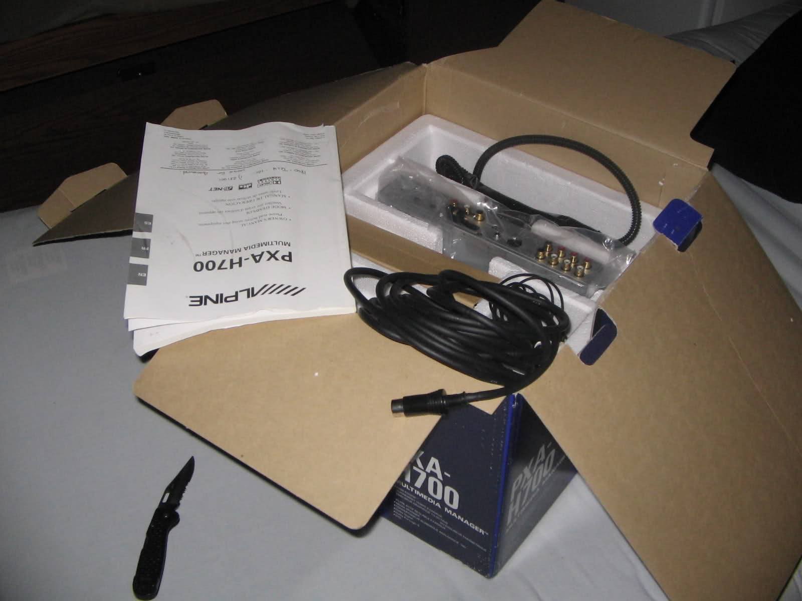

h701 installed.
the processor has time-correction, EQ, phase, x-over, and other multi-channel 5.1 settings. The controller is needed to adjust any of the settings on the processor, unless you have an Alpine HU control the processor.

as stated, its an active 5 way crossover, 6 channel 1\3 octave eq, dolby 5.1 decoder, 6 channel time alignment and some other crap //content.invisioncic.com/y282845/emoticons/tongue.gif.6130eb82179565f6db8d26d6001dcd24.gif
channel 1 (output 1\2 for highs) = front 1
channel 2 (output 2\3 for mids) = front 2
channel 3 (output 3\4 for rears im not using) = rear
channel 4 = center\sub
channel 5 = sub (bridge 4\5 with the controller)
so its real REAL versatile. you just need a double din or some other place to mount the thing because it is the volume controll and everything. real easy to use once you get used to it. you can eather set EACH SPEAKER's eq\xover\time align... or you can set each channel (output 1, output 2 ect) together each pair of speakers have the same settings. theres a bunch of 'save spots' (1-0 buttons) so you can have an eq\xover\time align to suit different music and so on.
