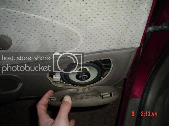

Here's when I still ran 4" speakers in my front doors as that was the factory size. (A pair of 2-way Infinity References I eBayed for $30/shipped)

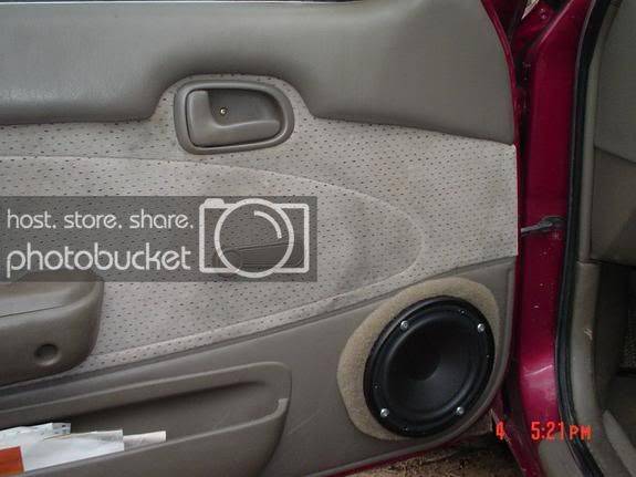

When I decided to upgrade to some 6.5" components I simply made some MDF spacers that would allow for the midwoofers to sit on the door panels while still being able to roll down the windows and before mounting the driver to the spacer covered them with some carpet that matched (more or less) my interior. It's an old pic from when I used to run Diamond M3 comps which shows the midwoofer with the grille off of it as opposed to the M6 units I use now but the mounting is still the same...
Not very labor intensive and if Prowler can manage to figure it out then I'll wager so can you!
