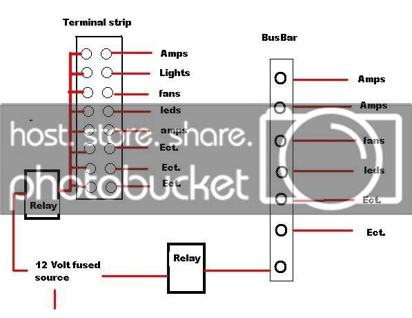

Those 8-Position Dual-Row Barrier Strips that were recommended... So if it has 8 poitions, that means he has to somehow feed all 8 of them with 12 volts. So what? a bunch of jumpers? maybe a big pigtail of 8 wires plus the feed? So how would that be easier then a busbar?
Please explain technically why barrier strips wouln't work in the application?
Well he seems to get my point. Just because you have a degree or are getting one doesn't mean that you know anything about practical application. You can make any number of things work. I could make a washer, solder and heatshrink work. That doesn't make it right or easy. Running multiple position barrier strips is fine if you're making connections for 8 different sources like wiring an alarm. Making a connection for a single source means that the barrier strip makes you have to work harder for no improvement in outcome.

visual help.
As you can see, by using a terminal strip, you need to feed each terminal, where as in the Bus Bar representation, only one feed is required to achive the disered result.
my method might not be practical but i run my amps off the remote wire (2) and run 2 runs of 18g to my fans (3) via the fuse box in my car for the radio, has no power unless the radio has power been doing this for about 7 or 8 months no problem so far
Not if the terminal strip is jumpered like the ones I use. One feed wire makes each connection live. The one I use also has a plastic cover to protect against shorts.
And theres the difference. The one you linked was not jumpered wise guy. The one you linked is a royal pain to do this. A jumpered terminal strip is just a buss bar like we've been saying. Get off your self righteous tear. For bragging so much about your education, you sure are doing a good job proving my impression of many engineers correct.
